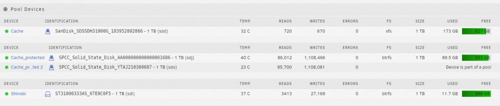

I just installed 2 new SSDs to make a protected cache pool.
I didn't have any problems setting up the cache pool, and so far it seems to work just fine.
I'm just curious why one of them has a strange looking name.
The second one is SPCC_Solid_State_Disk_YTAJ210300687 which looks a bit more normal.
The first one is strange - SPCC_Solid_State_Disk_AA000000000000001686.
Unfortunately I'm not able to look at the disk and see whether it is really labeled that way because that would mean i would have to shutdown the server and pull the drive out, and i can't because I'm in the middle of a long file transfer.
Anyway I expect that both should have similar naming.
Also I think the temperature for both drives should be the same. I don't see any reason why one would be so much warmer than the other.
Has anyone had similar experience? Is this something I should be concerned about?
The drives are Silicon Power A55. I bought them because the price was good when it was on sale. But now I'm a bit worried that they're not good.

This should be the serial number as reported by the device, same for temps, diagnostics would confirm.
silometalico-diagnostics-20210615-2346.zip
Here's my diagnostics.
I haven't noticed any problems or SMART errors.

Yeah I figured as much... It is strange that the temperature reads 40 isn't it?

I didn't mention there were errors, just that Unraid reports what the device itself is reporting:
Device Model:     SPCC Solid State Disk
Serial Number:    AA000000000000001686
ID# ATTRIBUTE_NAME          FLAGS    VALUE WORST THRESH FAIL RAW_VALUE
 194 Temperature_Celsius     -O---K   100   100   050    -    40
yeah i don't think its an unraid bug or anything like that... the drive itself does appear to be reporting that serial number and temperature.
i was kinda interested to know if anyone had similar experience, and whether this is something i should be concerned about.
i have some doubts about this drive, but as it appears to be working i don't think I can get it replaced or returned under warranty.
It's not, devices are likely from different productions runs and serial size changed, as for the temp, it's not always accurate for low end devices, most likely one of them is reading wrong.
