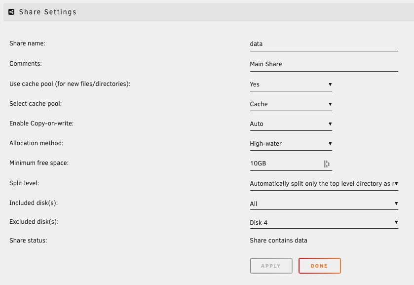

Mover was working correctly, moving data from the Cache to Array for a while. . . however now it no longer moves downloads from cache to the array and I have not been able to figure out what has changed.
On Unraid 6.9.2
Using High Water
Syslog & share screenshot attached.

It might be better if you posted your system’s diagnostics zip file (obtained via Tools -> Diagnostics) as they provide more information than the syslog (and also include the syslog).
One thing I notice is that you have a very restrictive Split level and that might force mover to put files on a disk that has insufficient space (and thus fails).
Thank you for the info, changing the split level resolved the issue!
