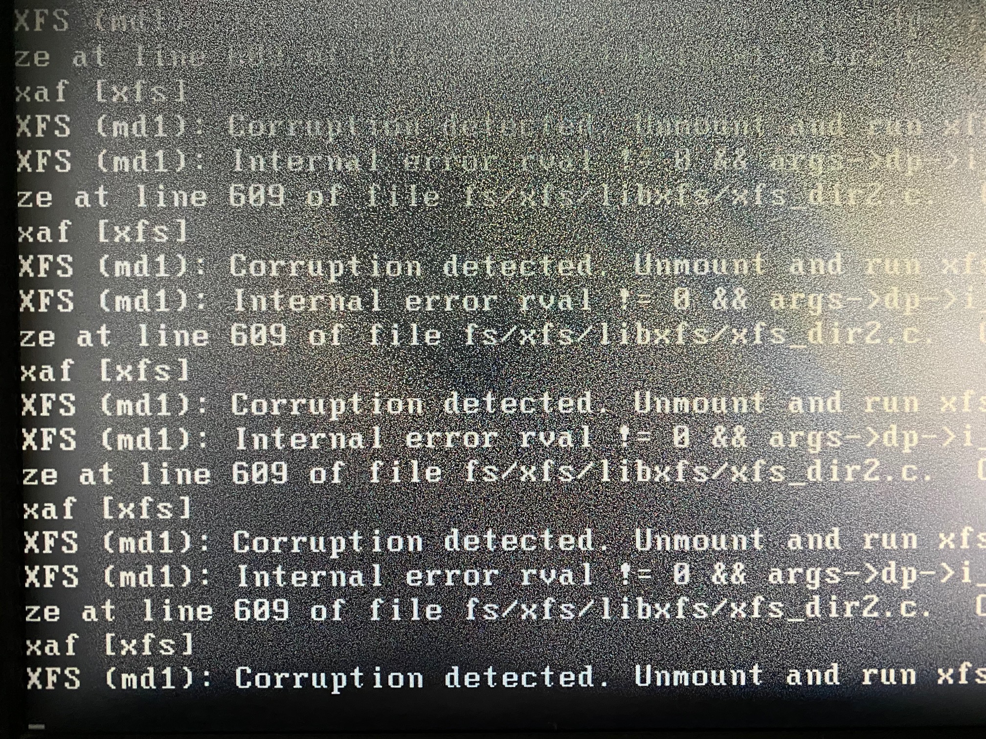

about to call it a night but just happened to notice that the physically connected server screen was full of these errors, just repeating over and over:
XFS (md1): Corruption detected. Unmount and run xfs_repair
XFS (md1): Internal error rval !=0 .....
i tried going through the xfs_repair steps a few more times but the error still appears but only on the physical screen.

unraid server screen still shows all these errors:
XFS (md1): Corruption detected. Unmount and run xfs_repair...
any tips on how to fix this would be very much appreciated.

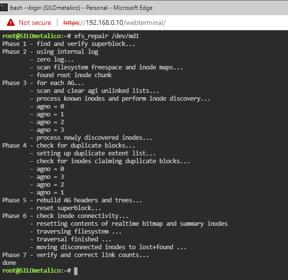

@JorgeB ok i rebooted and did xfs_repair on disk 1 again in maintenance mode.
it ran quite fast and gave these results:
once i started up the array the errors started flooding the screen again.
there were none of these errors at the login screen after server rebooted and when i started the array in maintenance mode.
they only started flooding back when array is started in normal mode (not maintenance mode).

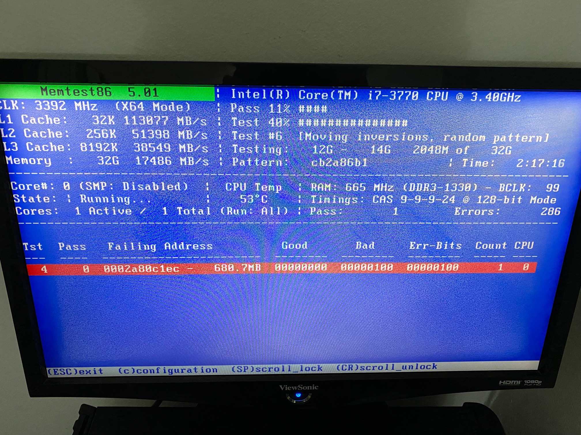

ok, so ran memtest but it was taking too long... i stoped it at this point:
look like there were some errors... guess I really did have faulty RAM? or a faulty CPU? something doesn't look right.
i'll do it again another day. I right now i'm too tired to wait for it to finish.
Yes, only 0 errors are acceptable, and even that not a guarantee there's aren't issues, but any errors is a guarantee there are.
