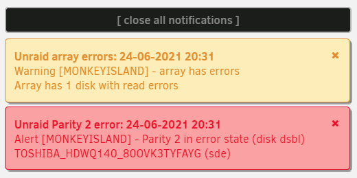

And now I am afraid that 1 of the 2 parity disks I have went offline Why ???
This part was in Yellow !!!
Jun 24 19:45:48 MonkeyIsland kernel: sd 7:0:3:0: [sde] Synchronize Cache(10) failed: Result: hostbyte=0x01 driverbyte=0x00
And this part was in RED !!!
Jun 24 20:30:37 MonkeyIsland kernel: md: disk29 read error, sector=3907077192
Jun 24 20:30:37 MonkeyIsland kernel: md: disk29 write error, sector=3907077192
Jun 24 20:31:07 MonkeyIsland kernel: md: disk29 read error, sector=24
Jun 24 20:31:07 MonkeyIsland kernel: md: disk29 read error, sector=1501708064
Jun 24 20:31:07 MonkeyIsland kernel: md: disk29 read error, sector=1501708072
Jun 24 20:31:07 MonkeyIsland kernel: md: disk29 read error, sector=1501708080
Jun 24 20:31:07 MonkeyIsland kernel: md: disk29 read error, sector=1501708088
Jun 24 20:31:07 MonkeyIsland kernel: md: disk29 write error, sector=24
Jun 24 20:31:07 MonkeyIsland kernel: md: disk29 write error, sector=1501708064
Jun 24 20:31:07 MonkeyIsland kernel: md: disk29 write error, sector=1501708072
Jun 24 20:31:07 MonkeyIsland kernel: md: disk29 write error, sector=1501708080
Jun 24 20:31:07 MonkeyIsland kernel: md: disk29 write error, sector=1501708088
What is going on? I just created a folder ;-) !!! Nothing More !!!
What shall I do now ? ? ?
