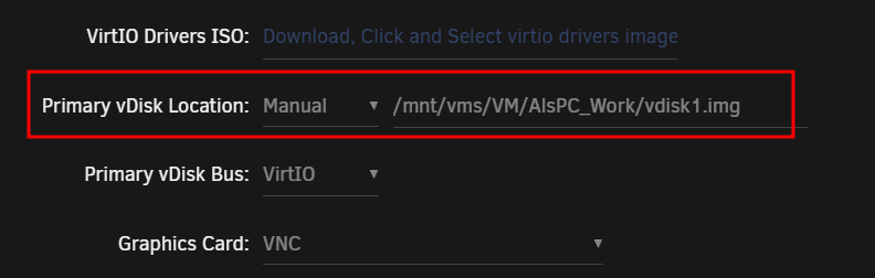

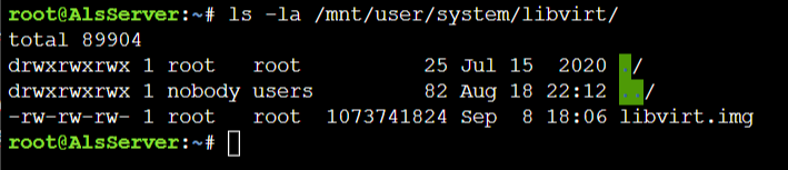

@acurunner79 may try wiping your system libvirt.img where the data is stored and reboot (or restart VM Service)
location is usually /mnt/user/system/libvirt/
depending now how far you are and your VM's are updated, make your notes how you did set them up cause you have to redo them, after wiping just add a VM with the same settings and point to the existing image (usually vdisk1.img)

@alturismo Thank you for the help! I've done the steps above, I can now create a vm and the setting do save.

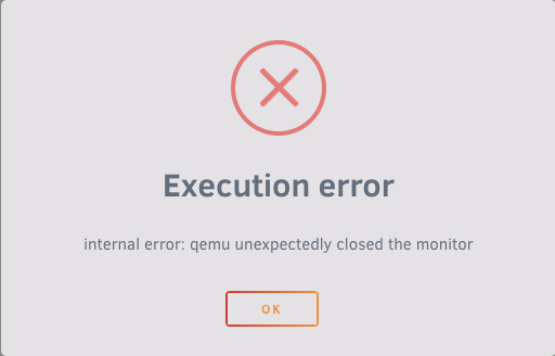

After doing so, my vm will not allow vnc to open. It starts up and then the vnc connect disconnects. I also tried tried using my gpu which seems to saves but when I try to run my vm I get an error "internal error: qemu unexpectedly closed the monitor"
