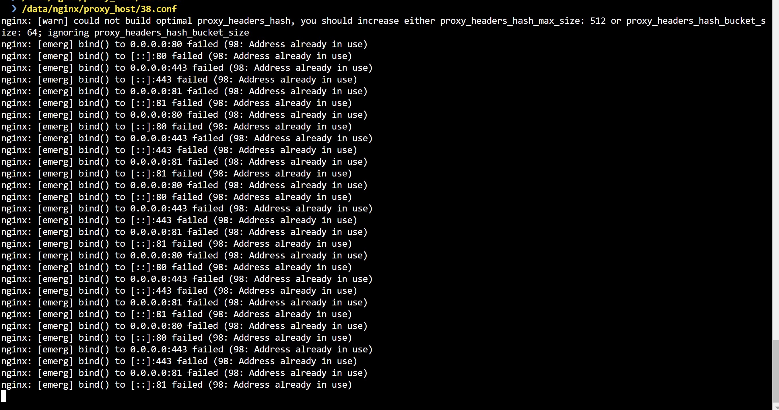

On 12/10/2022 at 9:07 PM, blaine07 said:
Anyone have any ideas how to stop this? Rebooting container stops it for a bit but it always comes back sooner or later. I thought “98” pointed to a config possibly but no dice.
Any ideas?
See attached.
Edit: seems to always continue to work fine when it does this; maybe slows down slightly.
I came here looking for a solution to this as well, me and a friend of mine both use this container and both have this issue.
Everything ran fine for months and just a few days ago when I tried to edit an proxy entry, I got an internal error in the web interface and this issue started to show up. A restart of the container indeed fixes the issue temporarily, but it's not a solid fix.
I've already been looking into this when that friend of mine first started having this issue, I checked everything..
We both have an unique IP configured for the container, no double ports or anything.
I checked everything I could possible think of what might cause this, but since this issue started showing up out of nowhere without me making any changes network wise to the Unraid host or to the docker container itself it kind of confuses me..
The container itself sometimes runs fine with the error happening, sometimes it stops working, but as soon as you try to make a change in the web gui it ceases to function..
Where you able to find anything which might point to a possible cause?
Are you sure? Stop NPM when the error is logged and then execute this to check which ports are open in unraid:
ss -tulpn
Or filter it directly for port 443
ss -tulpn | grep 443
ss -tulpn
I'm getting the error on all ports which I'm using in different proxy entries;
But the output of the command you send is the following;
tcp   LISTEN 0      4096                   0.0.0.0:9443       0.0.0.0:*    users:(("docker-proxy",pid=31783,fd=4))
tcp   LISTEN 0      4096                      [::]:9443          [::]:*    users:(("docker-proxy",pid=31790,fd=4))
I'm confused why nginx should try to bind the port 8090 or 8091. Did you add any stream hosts or could there be an other reason why NPM tries to listen to these ports?!
Yes I added those ports myself for specifc proxy hosts, but that's exactly why I'm so confused. All ports are failing all of a sudden.
I have a few specific instances running which use a certificate for a API access, which listens on different ports.
Edited by jeffrey.el
Which should not cause a "bind". A "bind" should only be done if NPM listens itself to these ports and not if it forwards the traffic. Or did you add these ports in the container config as well?!
Yes I added the ports to the container config as well, because the incoming connections are on these ports as well, this way I can use NPM to take care of the certificate renewals.
Does not make sense to me. NPM listens only to Port 80, 81 and 443.
Certificate renewals are done through Port 80.
Or is your NPM running in bridge network, you changed port 80 to 9090 and you forward your router port 80 to port 8090?! This would be correct. But you said "added the ports".
I understand your confusion, certificate renewal is done through port 80, and indeed NPM listens to ports 80, 81 and 443.
I however have an instance running in my network which listens to port 8090 and 8091, so to make NPM redirect these hosts with the certificate it requested and manages, I had to add those ports to the container and in the Advanced configuration section I added;
listen 8090 ssl;
listen 8091 ssl;
But like I said for this to work, NPM has to be able to listen to those ports as well, so in Unraid I added them to the container;
And those ports are port forwarded to the NPM container as well, so all should be good on that part!
And the target hosts are using other ports than 8090/8091?
No, they are listening to those ports as well;
But like I said everything has worked fine for months, and now all of a sudden this happens.. Is there anything that might cause the bind issues? Is there maybe a limit on the amount of proxy hosts that NPM can handle?
Which ips / networks are used by the containers (target and npm)?
NPM is 10.0.50.10, the target containers have different IP's from different subnets, but inter vlan routing is enabled for those subnets.
I've never had any issues with targets or anything, it always worked, the only issue I'm having is the bind error issue and the IP 10.0.50.10 is not used by anything else, so there is no IP conflict or anything..

1 hour ago, jeffrey.el said:
NPM is 10.0.50.10
And network? You need to be precisely.
