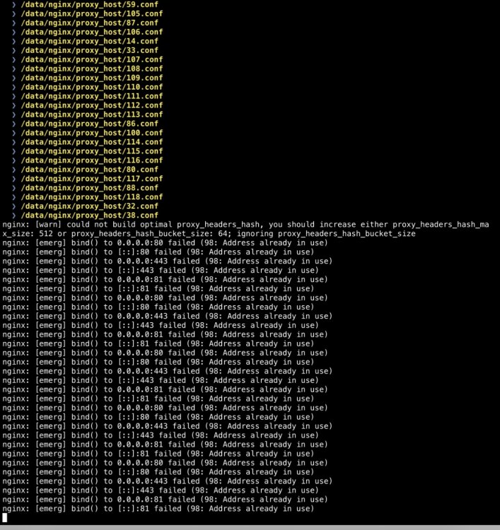

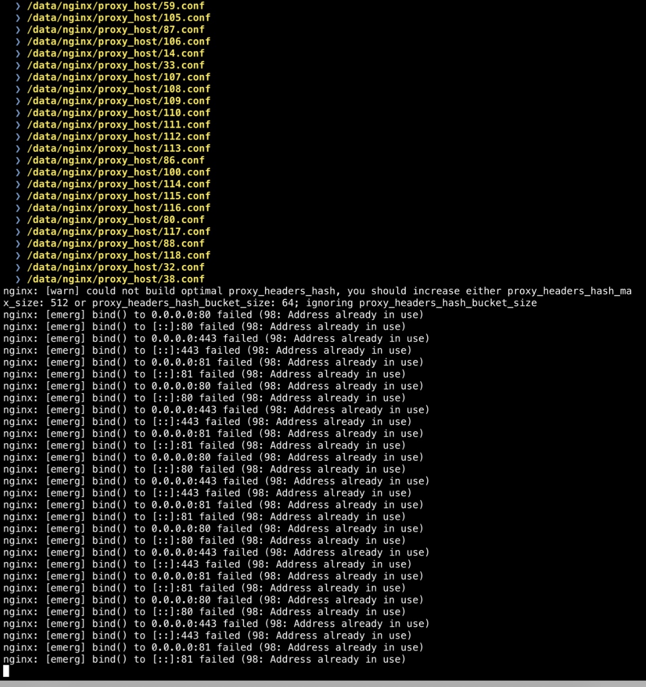

23 hours ago, blaine07 said:
I’ll try just removing it and see what happens. Since not referring to any containers by “name” and instead using all IP:PORT I don’t think I even need the syntax/be on specific network too?
@mgutt I removed the post arguments as we discussed and it’s “back at it again”. Any last ditch efforts? It’s network related I just am unsure what else at this point to do?

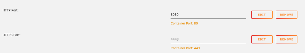

Greetings :) May I please get some help with NPM please?
So my certificate expired and everything stopped working.. I've just been ignoring NPM because it's just been.. working.
I'm getting this error in the log:
[12/16/2022] [11:23:54 PM] [Express  ] › ⚠  warning   Command failed: certbot certonly --config "/etc/letsencrypt.ini" --cert-name "npm-7" --agree-tos --authenticator webroot --email "xxxx" --preferred-challenges "dns,http" --domains "xxxx"
Another instance of Certbot is already running.
When attempting to request a new cert. "Internal error" in the webinterface.
I'm unsure if I screwed something up when my server crashed and I had to restore from backup, shortly after which my ubiquiti setup imploded and I had to redo it from memory.
Just found I had forwarded port 80 to the internal port 3000 for some reason. It's now this:
I feel like I'm missing something glaringly obvious here, probably network related or docker-setting related, but the entire household is down with the plague so I'd greatly appreciate a helping hand so I can get access to my audiobooks back 😃
Thank you and appreciate it.

Do you have many hosts? Else I would delete NPM incl it's appdata dir and start from the beginning.
Or you need to find follow the debug 5xx errors on the first page.
Yeah that did it. As a side effect I got dedicated IP working again so a better setup than before.
Now it'll probably just run without problems for years again. 🙂
Edit:
Spoke too soon. LetsEncrypt worked, but it seems not all is well.
Favicon downloads, but yeah.. Guess I have some work left still :)
Edit2: Forgot the docker network restrictions. All good now. Cheers.
