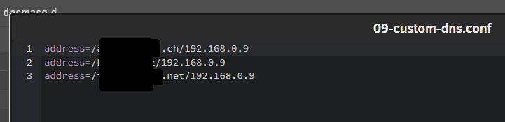

I first tried adding a wildcard domain in the PiHole WEB-UI but didn't get that to work. This above seems to be the solution though! :)
I added a "02-wildcard-dns.conf" file to /etc/dynmasq.d/ (host path for my PiHole container: /mnt/user/appdata/pihole/dnsmasq.d/).
In that conf I added:
address=/mydomain.com/192.168.1.4
Then restarted PiHole.
Before I started everything I ran this in the Unraid CLI to see where the URL routes to:
nslookup mydomain.com
and that pointed to my public IP. Same result running:
nslookup servicesubdomain.mydomain.com
After restarting PiHole and running the same commands they come back to 192.168.1.4
So I guess it's working. The subdomains I have setup in NPM shows as normal with a guilty SSL cert when surfing to them locally.
Only "downside" is that if I only surf to "mydomain.com" I'm routed to Unraid UI since that's the servers IP, insecure no SSL. Same if I surf to any type of subdomain that not proxied in NPM.
It's only in the local LAN, so not a major issue. Surfing to Unraid UI through the normal IP is equally "open", just feels more hidden. I guess it's just a feeling... I do have a strong root password. :P
If anyone have any suggestion for this to only work on URLs in NPM I'm all ears. Perhaps wildcard wasn't the right choice. :)

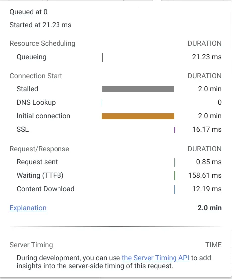

I have been experiencing an issue where accessing my Jellyfin & Home Assistant container/vm via NPM (in docker) can soft-lock my unraid server if I have a large amount of bandwidth traveling through it. Accessing the same data using my local IP address does not result in any crashing.
I have way more information and details on another post:
 but it was recommended that I post here as well.
I tried with Caddy and still received the soft-locking (so perhaps its more of a general reverse-proxy issue). But I am able to run NPM on an Ubuntu VM or my Win11 PC pointing to the same Jellyfin/HA instances and it works flawlessly.
Was hoping maybe someone more adept in reverse-proxies/npm could take a look at my thread and see if anything sticks out. Thanks!

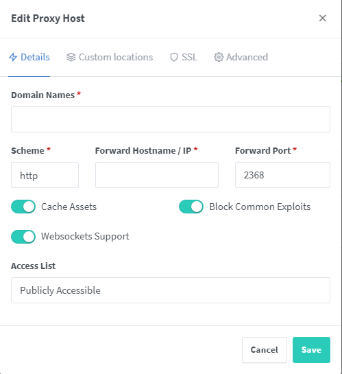

Hello There
I got kind of a basic question.
I'm using the nginx proxy manager for most of my dockers like nextcloud, homeassistant using a subdomain like cloud.example.com or homeassistant.example.com
how do i get the main domain "example.com" to work with a specific docker? I always get the message "example.com is already in use".
Thanks
Isn't normal. Something is wrong with your npm installation.
The easiest way would be to do a fresh install. Or you need to check the proxy config files in appdata or the npm database itself. Or you open an issue at GitHub and post your logs there.

Hi There
I got this worked out, passing the traffic from the maindomain to docker is now possible. I can't figure out why i can get a ssl-certificate with a subdomain no problem "cloud.example.com" but I am unable to to this with the maindomain "example.com".
Proxy Host is right?
Edited by WillyThunder
You typically don't want HSTS, that has pretty complex requirements.
Same message if i uncheck HSTS or HTTP/2 Support or even Force SSL
