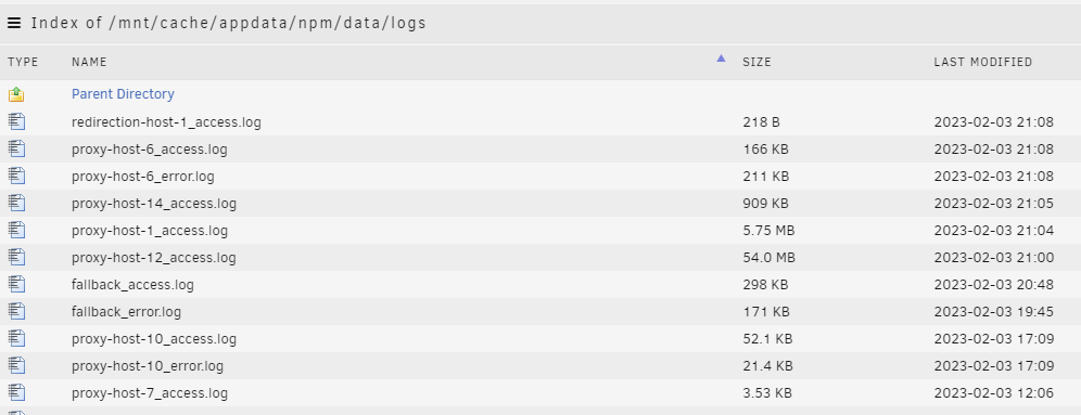

Retry it, then check the recent logs inside of the appdata directory /data/logs

I was running some Docker updates and got a docker.img usage warning. I started to look and see if I had something set to store logs in the wrong spot and noticed the path for error logs.
/tmp/Nginx-Proxy-Manager-Official/var/log
I can't find out where that path is on the server. It's not in any share, it's not on the thumb drive and it's not in the cache. Where are these log files being stored and is there any management that needs to be done to keep them in check?
It would be in, well /tmp, which is in RAM. It's not supposed to get big that quick (9MB for 6 days here).

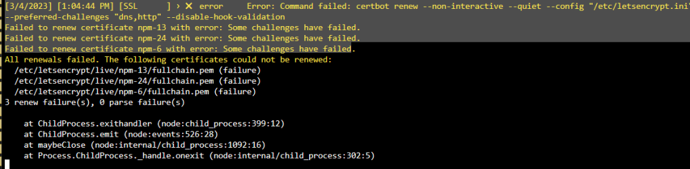

I'm having problems with certs Auto renewing.  After digging, I find this is caused because when NPM tries to renew all the certs, it fails on 3 old certs for domains I removed and then gets blocked from renewing further.
Ok great, so I removed the certs and proxies from the GUI.
Unfortunately its STILL trying to renew them.  NPM-13, NPM-24 and NPM-6 don't exist anymore.  How can I fix this?  Is there a command to remove them from the Database?
SOLUTION:  I figured it out in case anybody wants to know.  Just goto the folder /etc/letsencrypt/renewal/ (which should be in your appdata folder) and remove the npm-xx.conf file thats giving you problems.  Looks like these conf files are whats controlling the cert renewals on startup.
Edited by 007craft
A cleaner way is to do `certbot delete` then select it from the list.

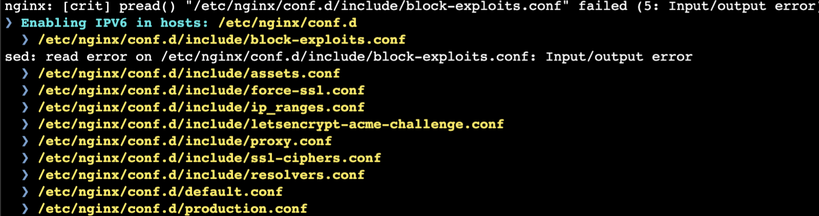

My server had backups run last night and I woke up to all my reverse proxied apps not connecting.  All connect locally without issue.  When looking at the logs, I saw the attached information.  Is this a critical error that's broken my docker, and if so, how can I remediate?
