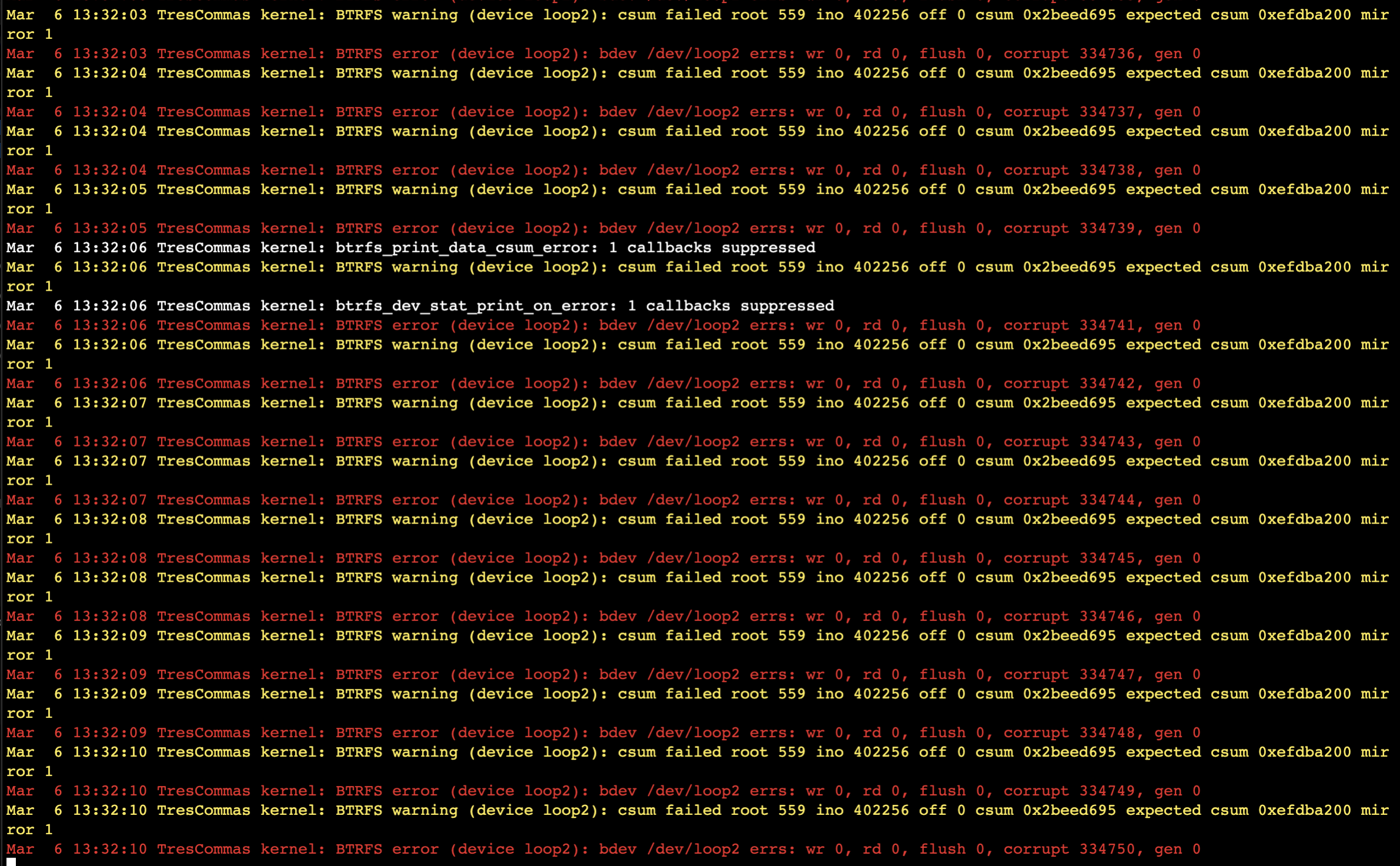

btrfs scrub came back with no errors, however when I invoke the mover here's what I'm seeing.
I assume the cache is hosed, will be replacing this evening.  That being said though, is there a safe way for me to remove all data from cache if the system is in this state?
loop2 is likely your docker image, just recreate it.
Docker image recreated and everything is back to normal.  I will still be replacing the cache tonight as this is the third problem that may have had something to do with the cache drive.  Thank you for the help!

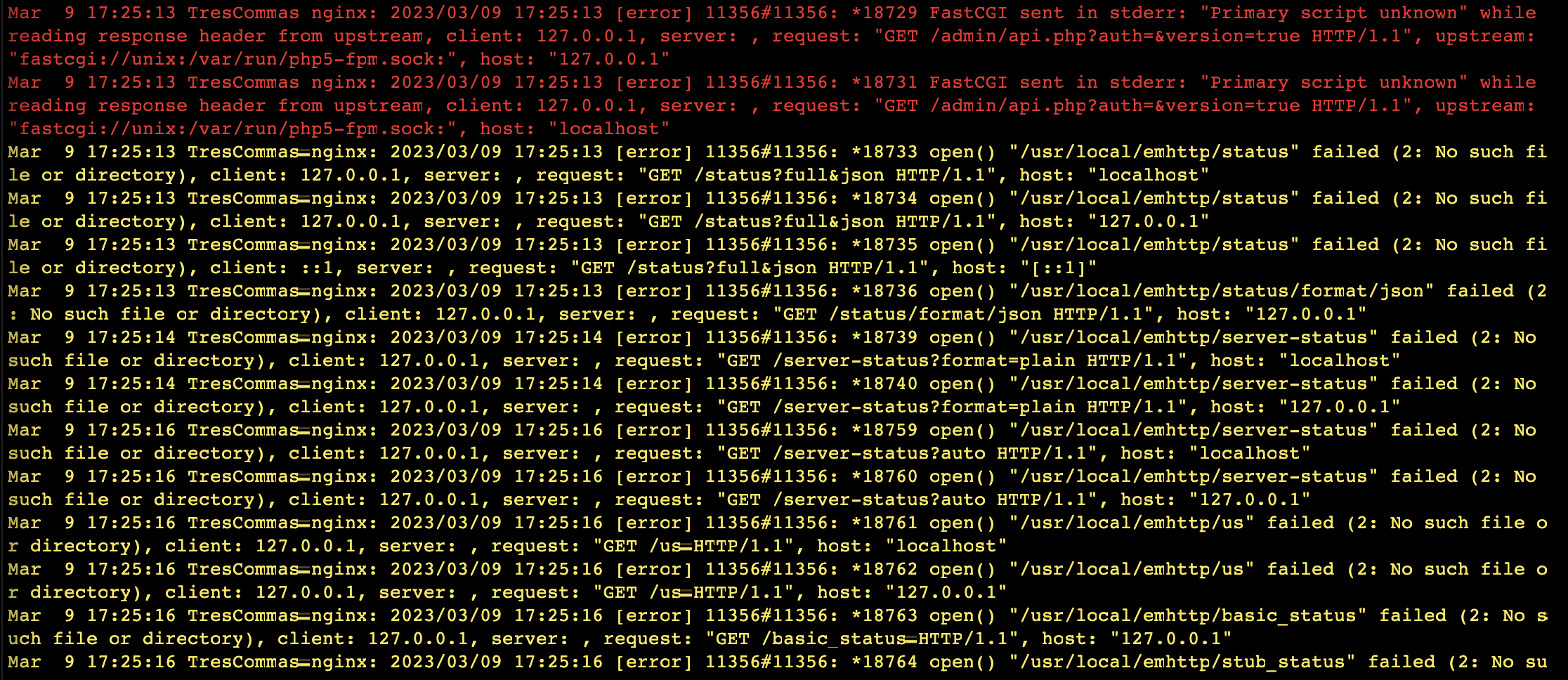

Quite a week...replaced the cache, then ended up with read errors on one of my array disks.  Had to eventually start in Maint Mode, run a check filesystem with -L parameter to get things up and running again.  Mods have recommended that my cables might be an issue, so I've got replacement SATA and power cables arriving tomorrow to hook up.  I have the system back up now, and I'm seeing more nginx related errors, curious what these are indicating.

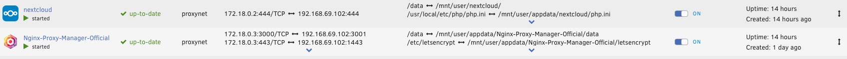

I'm using Linuxserver.io container.  I basically set everything up back in the day with the SpaceInvaderOne tutorial.  Attached is a picture of my docker page showing the port mappings.
Is there a special reason why you are using the proxynet network? Try to switch both to bridge to simplify your setup. And you need to find out why nextcloud is not reachable. As long you can't open Nextcloud, NPM can't reach it, too. I mean kinda logic, isn't it?
Check the Nextcloud logs. Maybe they contain any errors.

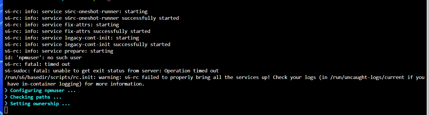

Hi all, I upgraded Unraid to 6.12 rc2 and now NPM doesn't work. The docker starts, but I get says page can't be displayed. Here is the logs window. Has anyone else had this issue? I see it says "failed to properly bring all the services up" But it is started and stuck on "settings ownership".
PUID and PGID dose not work heres the fix
jc21/nginx-proxy-manager:2.9.22
