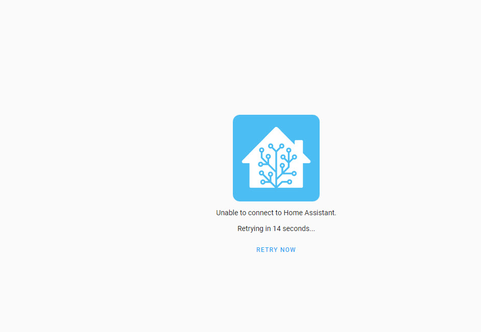

3 minutes ago, coltonc18 said:
Yeah, they are duckdns domains, and I just checked, they are still there and still show.  I just checked my ports, I dont use port 80, I use port 83....but they are setup correctly in the container, and its the same in my router.
As two examples...this is what I get when I try to access Home Assistant and Overseer.

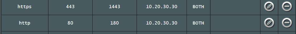

you cannot use a different port than 80. Letsencrypt demands the use of 80.
Maybe THAT is your problem currently???
I've been using a different port for like 6 months because port 80 is used by something else without an issue....let me look and see what is using 80, and try to switch stuff around.
strange, couldn't figure out what was on port 80, so started looking elsewhere, saw someone else mention a similar issue on another page, and someone said to check websocket support...for whatever reason websocket support had become unchecked on Nginx proxy page.  Now all of my proxies are working again.

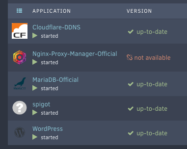

Hi there, thanks for the awesome plugin that you've made!
I am using the NPM docker from the APPS via Community Applications, and I recently I have a small problem of my NPM docker app,
the version of the docker is suddenly turned into "not available" and doesn't auto-update anymore.
And now it is a few versions behind the newest one, and I'm quite worried about it since is it a core docker for everything and security.
Is that anyway to fix this problem? Thank you all!

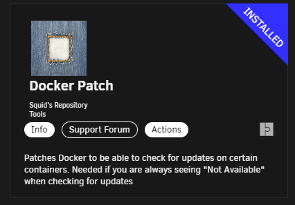

There is a manual fix; but find the information about the plugin. The plugin is what you want:
EDIT: Found it: image.png
Sorry, I didn't know there has a topic for this issue already, and the method perfectly solved the problem.
Ps. notes to myself and anyone else. if you can't find the "Docker Patch" on the "Community Applications", your Unraid needs to update.
Thank you Sir/Madam, hope you have a wonderful day!
