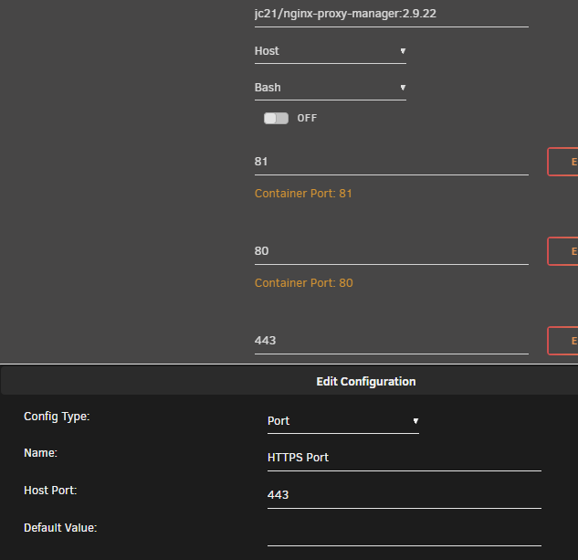

On 8/1/2021 at 1:10 PM, mgutt said:
My suggestion: Run NPM as host and run all other containers as bridge.
Is this what you're trying to refer to? Went ahead and set NPM as host - webui doesn't load anymore, switched it back to bridge, now NPM is a complete dud, no webui and for some reason the port reverted to 8181 from a custom one I set. Stopped it, set it back to my port, still can't access NPM any more..
Come on man.. it's 5 am for me, just gonna call it a failed no sleep night I guess.
To run the NPM container as host you need to change the ports the unraid UI runs on in settings->management access so 80 and 443 are free for NPM.
I have NPM running on 1443 and 180 instead, with router directing web traffic to those unique NPM ports. But now NPM is completely not working since I set it to host, changing it back to bridge it shows up as running but the webserver and webui are inaccessible. /facepalm
Edited by profzelonka
Ports can't be "changed". You are only forwarding port 1443 to Port 443 and this is only possible in the bridge network. With host or br0 a container uses it's default ports and those are 80 and 443 for NPM.
Personally I prefer changing unraids ports and run NPM on host network with port 80 and 443, because this is the only reliable solution for IPv6.
You cannot run on host or br0 with changed ports, port mappings are only possible on bridge.
If you tried changing them while in host mode you need to set them back.
Same.

Set unraid ports to something else. Removed NPM, readded, still can't use it.. Looks like old ports are being remembered somewhere. How do I wipe it?
If you did "reinstall from previous" that would have kept your previous settings.
Either install clean or just check they're set right.

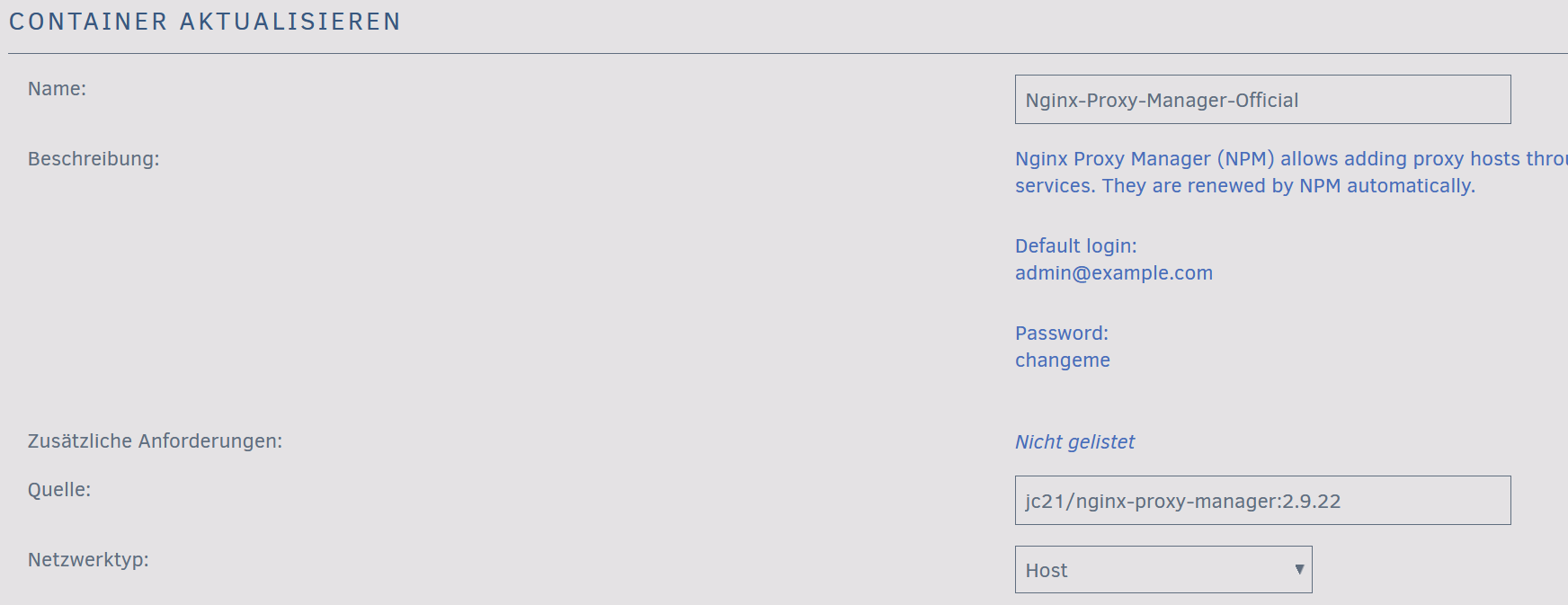

What's the latest update on the newest nginx proxy manager update? Is it still buggy and recommended to stay at an older version or can I upgrade? And if yes, how?
On 4/26/2023 at 5:15 PM, Herobrine said:
For a while now whenever I try to add/edit sites from the dashboard I get a internal errors till I restart the container. At most I am able to successfully create 1 new proxy host before I need to restart the container after making the config change (which sends a internal error warning) then making me restart eh container to apply it.
Same problem
7 hours ago, fir3drag0n said:
? And if yes, how?
Dunno current status, I stay with the old version (and am fine with it).
How? easy!
go to the docker's settings page and locate the "source" entry:
(in german "Quelle")
At the end of the line you will have ":latests", change this to ":2.9.22" and hit ok. It will downgrade to this version and never ask for an update again.
(of course you can later on decide to put back :latest or any other version number you like to run)
