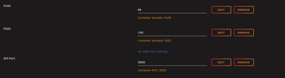

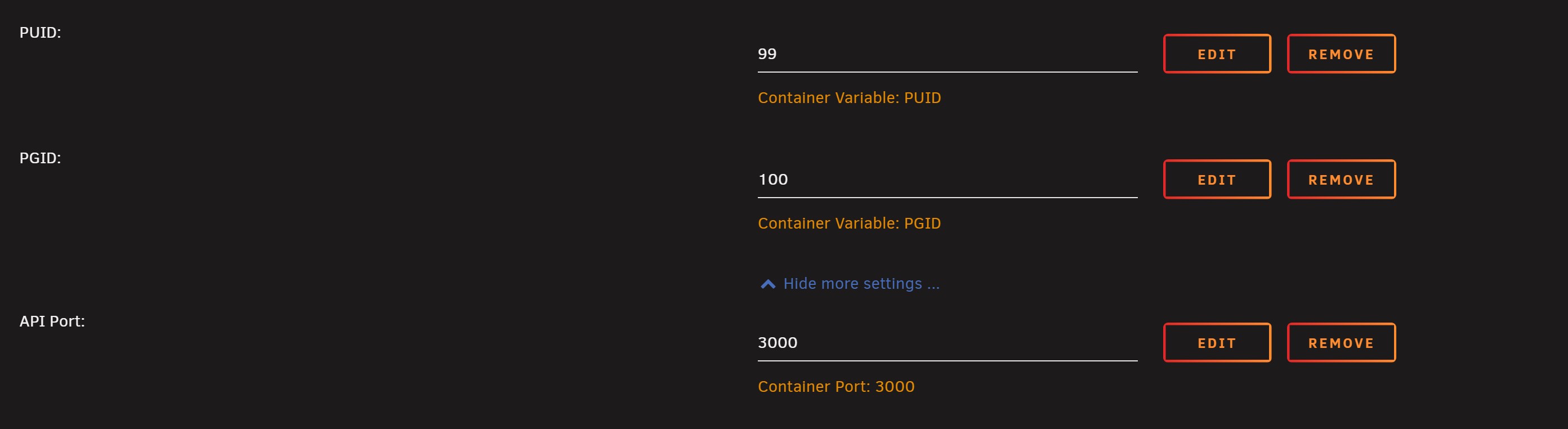

Currently mine is operating with these parameters:
Last few weeks/month have been extremely difficult with all the container/permission changes he's been toying with. I am finally on 2.10.3 all seems to have "settled down".
I realize it isn't the containers doing/Unraid but I REALLY wish there was a export all hosts option so that some of the burden of "starting over" could be reduced.
Ok, hmm. Maybe I set the opposite values 100:99. Will test this again...

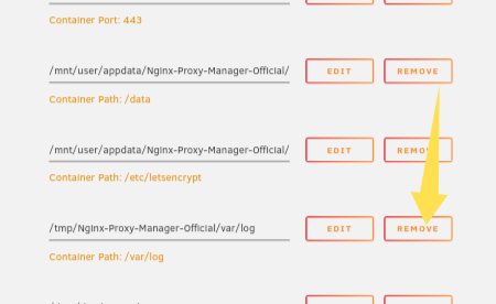

Probably the /tmp/Nginx... path has wrong permissions. That's why I added this to my /boot/config/go file:
mkdir -m 777 -p /tmp/Nginx-Proxy-Manager-Official/var/log
Not sure if this still necessary.
Another option would be to delete this path:
But then all logs are written to the SSD. Not my favorite as it causes permanently writes.

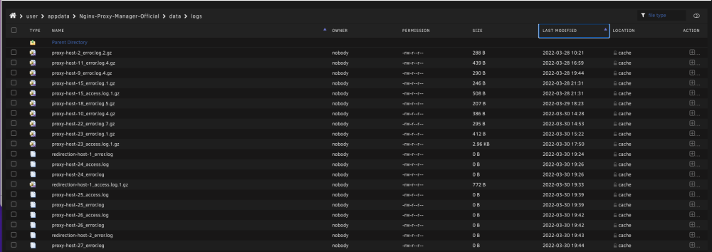

Can you please provide more context about adding to your "/boot/config/go" file?
I ran this: https://github.com/NginxProxyManager/nginx-proxy-manager/pull/1140

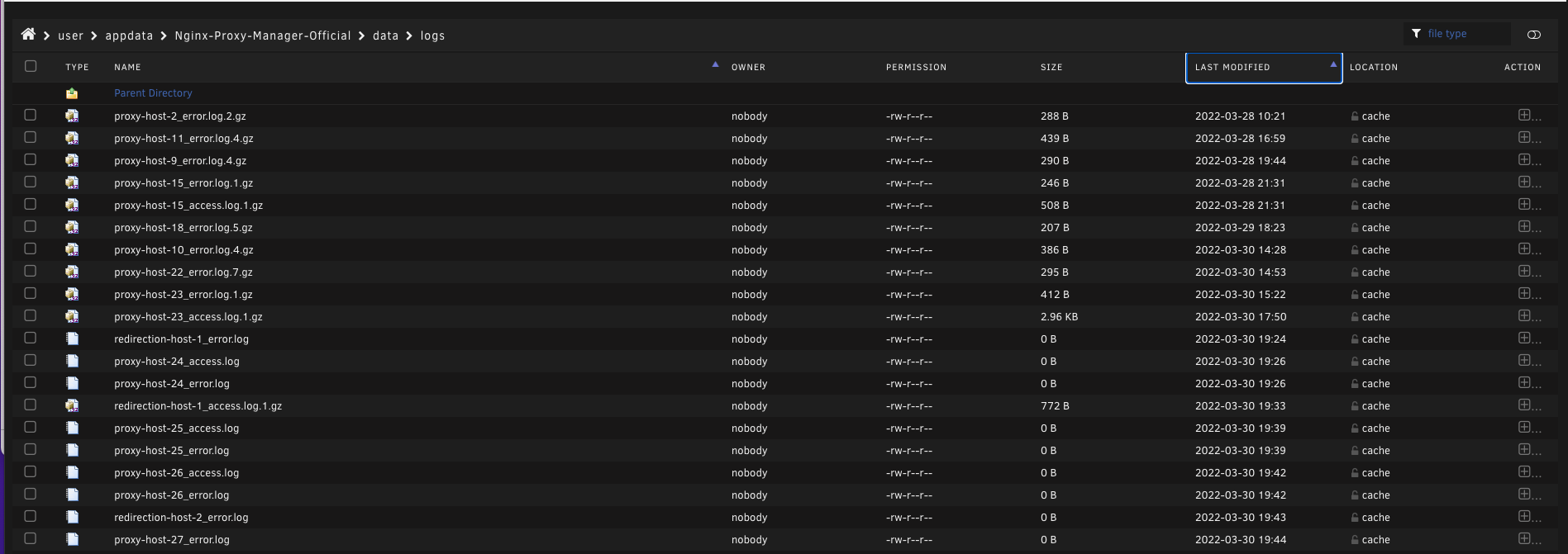

And it said nothing needed rotated as not older than 7 days, BUT in my log folder I have a *lot* of logs not edited in more than 7 days. I wonder if I could just delete all those from say last year for example with no ill effects?
1450566747_ScreenShot2023-05-21at1_19_11PM.thumb.png.acc53734c79caa4877ad8e1b451dcd23.png
Sorry, it's /data/log not /var/log. Missed that. So my post is not related to that.

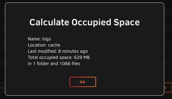

These are only logs. Feel free to delete them. I think rotation is broken because those hosts were deleted in the past.
So stop container, delete them ALL(inside log folder), start container and they’ll all re-create?
That's what I would do. Of course you could create a backup:
cp -a --reflink /mnt/cache/appdata /mnt/cache/appdata_backup
This is a snapshot copy. It takes only seconds to create and does not really use space. Feel free to delete this folder afterwards.
Seems to have worked; thank YOU!

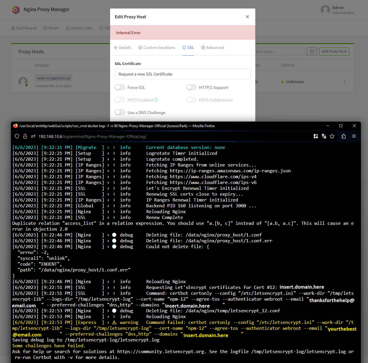

Noob here. Dipping my toes in Nginx-Proxy-Manager and could use some help. Every time I try and have Nginx-Proxy-Manager try and make a SSL Certificate I get an "Internal Error". Not sure what that means so I checked the logs and to be honest I am not sure what the logs are telling me. Anyone got any advice? This is a fresh install of Nginx-Proxy-Manager. Following ibracorps guide for what to put in my cloudflare.

Do you have both ports 80 and 443 forwarded?
Yeah. Posted on reddit and was able to figure out a fix by following this guide (https://youtu.be/GarMdDTAZJo). So I changed from using CNAME in Cloudflare to A record. Not sure if that is good practice or not (would love to hear people's opinions). But between that and using DNS Challenge to get the cert it seemed to have fixed the problem. My issue now is that NPM-O uses it's own custom network while all my other containers are on the custom network that I made. If I move NPM-O to my custom network the NPM-O container won't start. I'd rather use my own custom network cause that's how I have things already set up. Is there any way to move NPM-O from it's own network (br0) to my custom network?

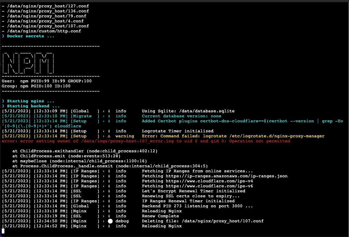

I'm getting this error:
Is there something I can do to fix this?
