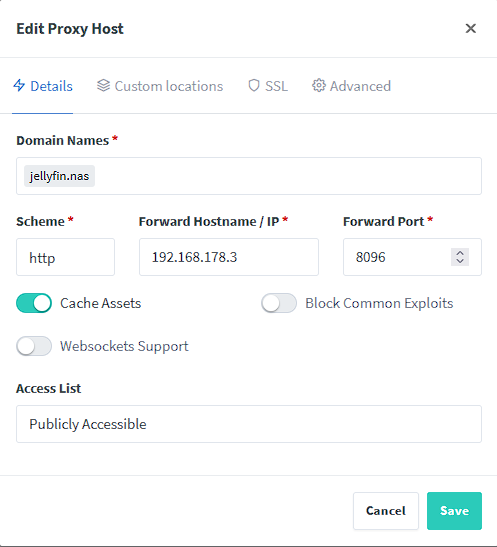

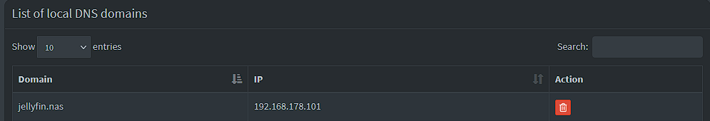

Hi, I got the following setup:
  • Pi-Hole custom network br0 fixed IP adress 192.168.178.100
  • NPM custom network br0 fixed IP address 192.168.178.101
I think I made a mistake in my configuration but I can't see what's wrong. When I call the domain I get a 502:
2023/07/14 12:34:12 [error] 22183#22183: *9 connect() failed (113: No route to host) while connecting to upstream, client: 192.168.178.2, server: jellyfin.nas, request: "GET / HTTP/1.1", upstream: "http://192.168.178.3:8096/", host: "jellyfin.nas"
And what's Jellyfin on?
It's on 192.168.178.3:8096 like it's shown in the proxy host.
He asked for the network type. Bridge, Host, custom, br0... Some networks can't reach each other.
It's bridged but with host it's the same. But it seems you are right, I can't reach 192.168.178.3 from the NPM container. Is there a way to make it reachable from the container?
Edit: Ok I found it. I changed to macvlan and granted host access to custom networks. It now works :)
Edited by dunn

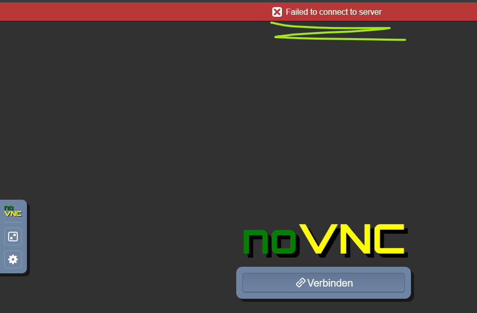

Hi is there an Issue with VNC support? I just moved from SWAG to NginX Proxy.. everything workes perfect, SSL Certificate, Nextcloud.. boom.. realy Nice ! only my Doccers with VNC have some issues.. i am able to reach the First site.. than click on vnc.html <-- no Connection possible..
if i change it to HTTPS, i get an 5xx error..
What is the Issue i am doing wrong?
Edited by eLpresidente
At first: It is not a good idea to make this public as this VNC connection has access to the BIOS of the VM. So if it restarts, someone could be able to open the boot manager and kill the VM and/or access sensible data inside the VM or even install own stuff. It is like to leave a Notebook at the next bus station while hoping nothing will go wrong.
It would be better to install a remote access software inside the VM (Teamviewer, Real VNC, Chrome Remote Desktop. etc) which work without port forwarding. Or join the server to a virtual network like Zerotier. Or setup a VPN connection to your router. I'm using for example Wireguard to connect to my router.
Did you enable Websocket support for the NoVNC proxy host? This is required.
Did you check your browser network developer tools? Maybe it returns an error message.
is it enough to protect it with Accesslist from NPM ?
if not i can do it with Wireshark, its already setup
Thx, that was the solution to this

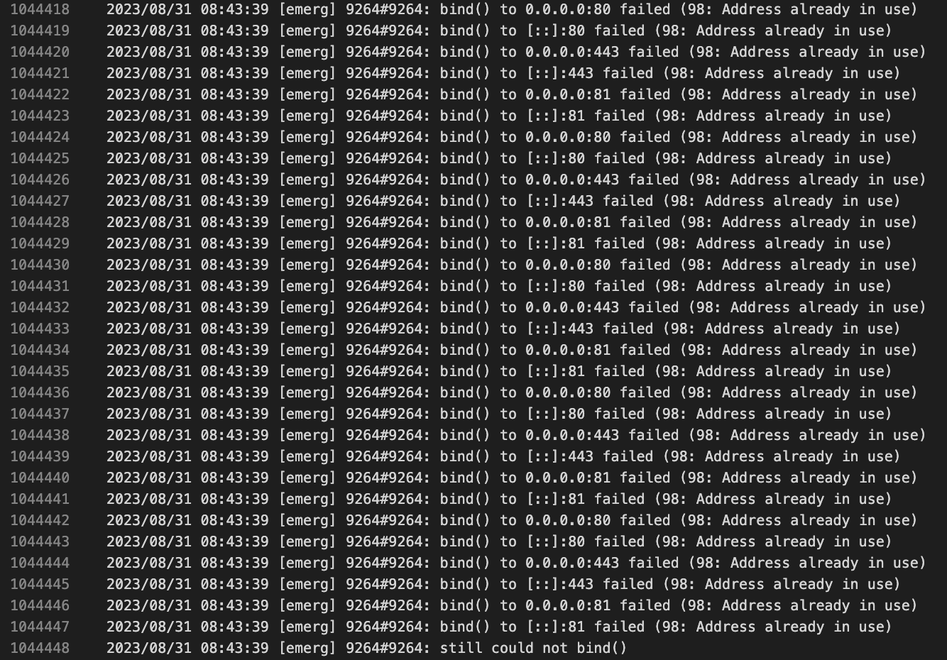

Ran into an issue after the Unraid upgrade to 6.12.4 with Nginx.  When I try to browse to the local installation, I get 'ERR_CONNECTION_REFUSED' in all browsers.  It's the only docker that's giving me this issue but I cannot get it to come back online.  I tried restoring a backup but it was unsuccessful.  I've attached a screenshot of my config, and a screenshot of the docker log.  Any and all help would be appreciated.
Edited by jackfalveyiv
