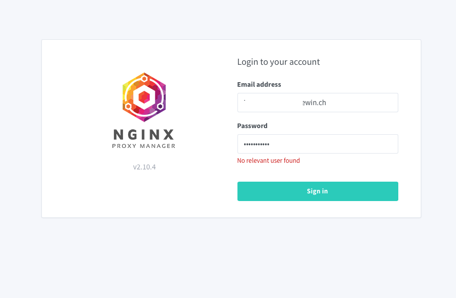

Hallo zusammen
Ich habe seit heute das Problem das ich mich nicht mehr Einlogen kann:
Hello, everyone
Since today, I have the problem that I can no longer log in:
Ein restore von gestern habe ich versucht brachte jedoch nicht, die Eingabe ist Korrekt, copy past vom Passwortmanger.
Meine Recherche führte mich zu diesem Comannd leider ohne erfolg:
A restore from yesterday I tried but did not bring, the input is correct, copy past from the password maniac.
My research led me to this Comannd unfortunately without success:
Hat jemand eine Idee ?
Does anyone have an idea?

3 hours ago, Toby-ch said:
Hallo zusammen
Hello, everyone
https://github.com/NginxProxyManager/nginx-proxy-manager/discussions/1634#discussion-3723916

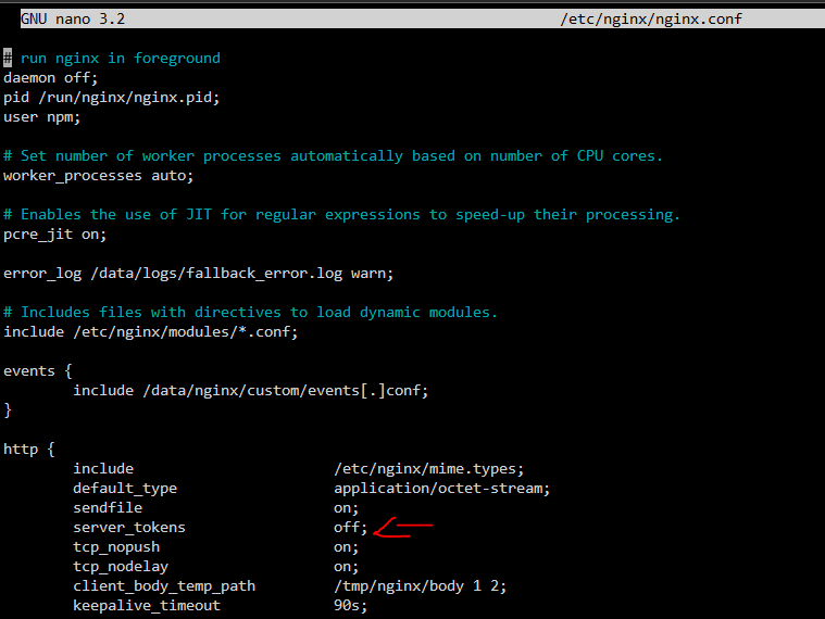

The docker container is ignoring "server_tokens off;" from nginx.conf file. It is showing the version number in the login screen which is a potential security risk. Can someone double check and help fixing it please?
server_tokens off works as it should because its off by default.

Hi.
I get so fucking tired of the shit that it doesn't work after the update. The latest version does not start at all.
Use 2.9.22, can install but cannot log in.
I don't know if I should keep doing this every time after updates.
7 of 10 dockers don´t work after Proxy has crashed.
Same on 2.10.4. When I click "sign in", the button gets a spinner, and then it goes back to the label "sign in", without any message. Also no log messages.
Sadly, this is my most problematic container while also being the most important one. Has someone experience with traefik and can report if it is more stable when new updates are deployed?

How do I change the login page / index page to not say "Proxy Manager"
This is causing public IP addresses to be blacklisted by Brightcloud.
I spent an hour digging though the files and I can't find the index.html file.
