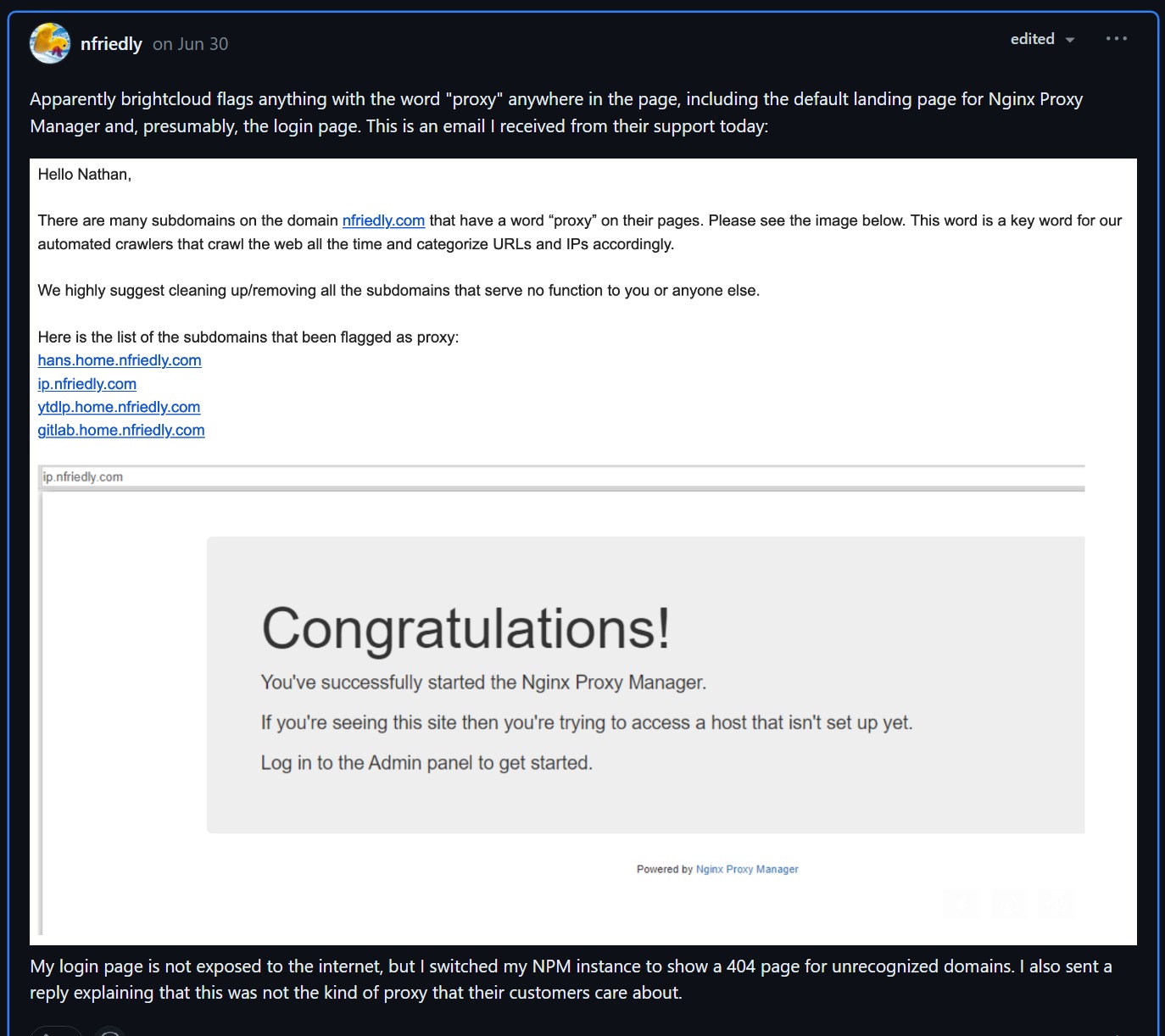

Are you talking about the welcome page which is only visible while opening the public  IP?
Correct.  This page is being flagged by BrightCloud crawlers and since it says "Proxy" BrightCloud lists the public IP as "High Risk."
Many large companies and orgs like State Farm Insurance, NY State . Gov, many large banks use their lists to ban IP address. So others who had this issue had to change this type of page to not say "Proxy"
Note: this is not my site, I told the person to not expose the admin page. I would not do this.
Here is an email from BrightCloud to someone else that had a public facing page that said "Proxy" who was added to the blacklist.

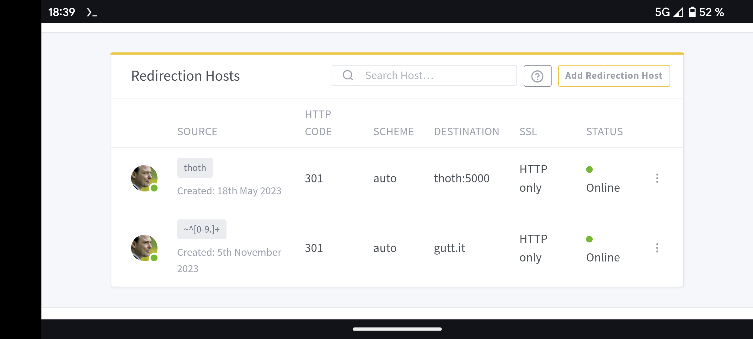

Then add a redirect host:
Domain Name:
~^[0-9.]+
Forward domain:
yourdomain.example.org
HTTP Code:
307
After the redirect works as you need it, you could change the HTTP Code to 301 (this is cached by your browser, so test with 307 first).
I've even added a redirect for my unRAID server name as I'm using a custom port and by that I don't need to type the port:
3 hours ago, adminmat said:
So the problem is the default page for nonconfigured hosts, one solution is not to put a wildcard DNS but only actually have entries for existing subdomains, anothzer is what's on the bottom of the email, just change the option for "default site" in NPM settings.

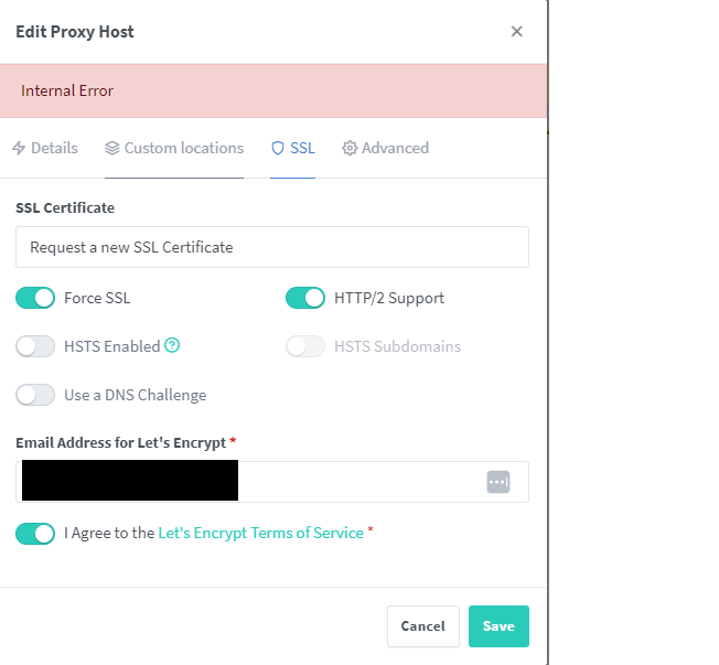

one of my certificates was about to run out, so i tried to refresh it. since it ran into an internal error I restarted the container, because i had this issue before. But now it wont start again. This is the message that keeps popping up in the Log:
nginx: [emerg] cannot load certificate "/etc/letsencrypt/live/npm-11/fullchain.pem": BIO_new_file() failed (SSL: error:02001002:system library:fopen:No such file or directory:fopen('/etc/letsencrypt/live/npm-11/fullchain.pem','r') error:2006D080:BIO routines:BIO_new_file:no such file)
reinstalling the container didnt work either... After 2 hours of google, reddit etc. i can't find a solution. Any ideas?

The symbolic link "fullchain.pem" could be missing in your case because of an unRAID Bug in and old version (The mover didn't move symbolic links). Another reason could be, that you are using /mnt/cache in the container settings, but the files have been moved to the array.
If you don't have an idea how to solve this: Delete the npm dir and reinstall it. This is the easiest method.

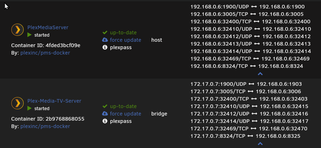

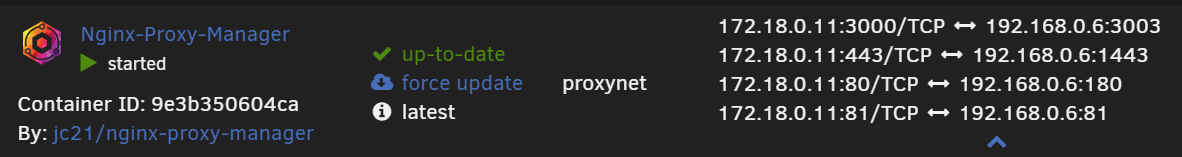

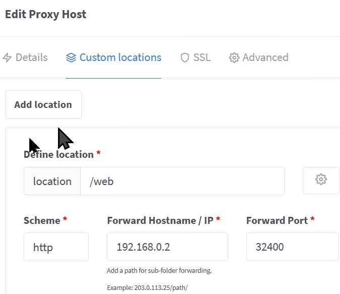

I needed a second Plex docker and did this by creating a fixed IP on br0, but is there anyway to use NGINX?
I have been reading and your great table says no?
My docker is working and running in parallel.
And the local link works.
And I did set the:
I have 40 working locations, but this one keeps getting me:

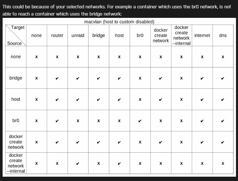

if you read also the header ...
so yes, if you have this disabled in your docker settings (settings, docker, ... default, no) then yes, bridged, custom and host cant "talk" to each other ... if you enable the host access ... then it of course works and the Info you posted is obsolete ...

i didnt meant to change the internal native port, you are running your dockers in bridge mode ... so you map the ports you need then ..
Plex Session
1/ 32400 <> 32400 (plex)
2/ 32400 <> 42400 (plexii)
that would be it, of course you should use 2 different appdata folders ... and different names so you can map npm to
plex > 32400
plexii > 32400 (or host ip:42400)
but you will find a solution ... ;)

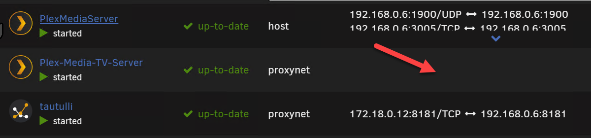

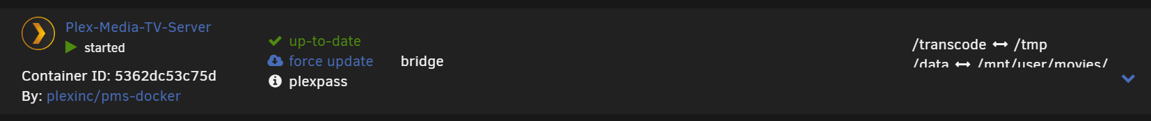

I might have this setup wrong, so long time since I did this (So sorry for asking stupid Questions, I am truly reading to find answers :-).
I have like many others created my "Proxynet" and Yes I use the names of the dockers in NMP, and it works great!
But I cant use Proxynet for Plex I get no IP? and cant access the Plex server (Like below)

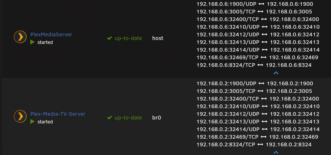

Each have there own IP now, one is Host IP and the other is br0 fixed custom IP: 192.168.0.2
If I try bridge or Proxynet I get the above or below picture with no IP?

My only working options so far (I have tried all other) for Plex has been to keep my main on Host and the other on Br0:
I guess my Proxynet is the same as when you say standard bridge?

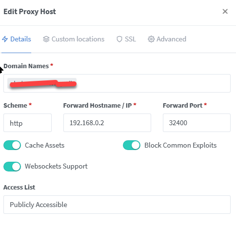

The above br0 "works" just not for NMP - But accessing the http://192.168.0.2:32400/web works (Plex 2)
I added the /web under the host to get that working long ago for the host one, and that works in NMP
Doing this for the 192.168.0.2 br0 I get the:

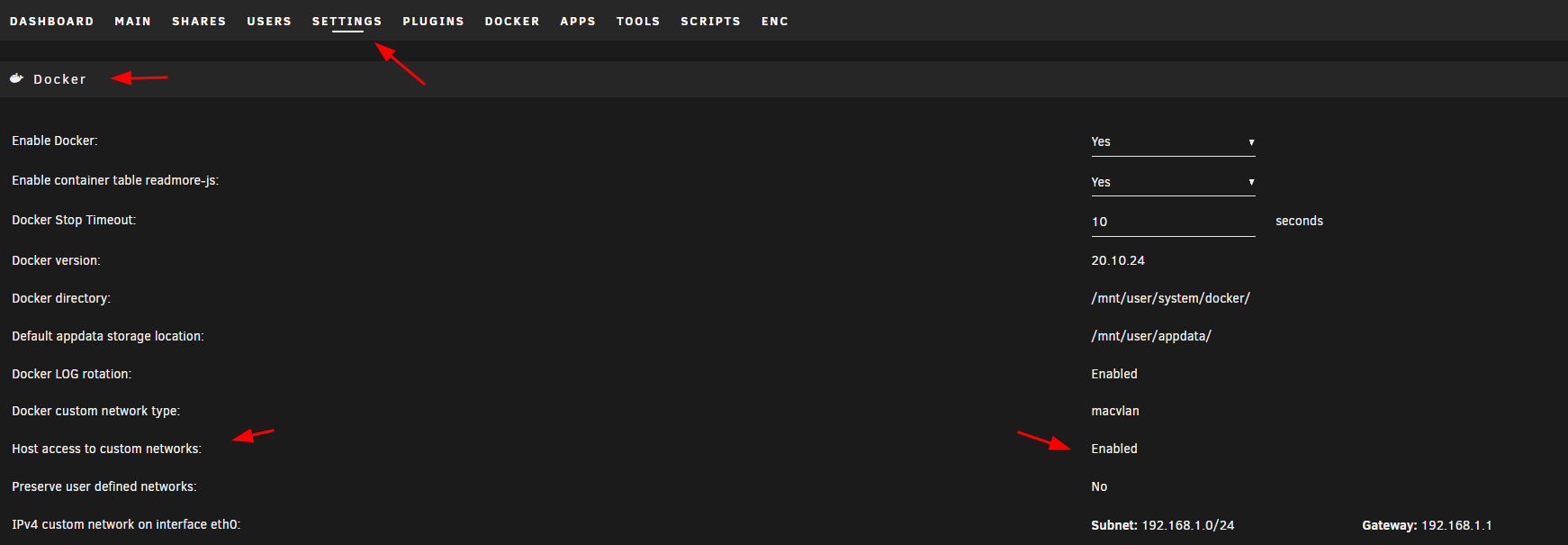

I read that the function to enable "Host access to custom networks" will be removed un this thread.
So I guess its better to try other alteratives

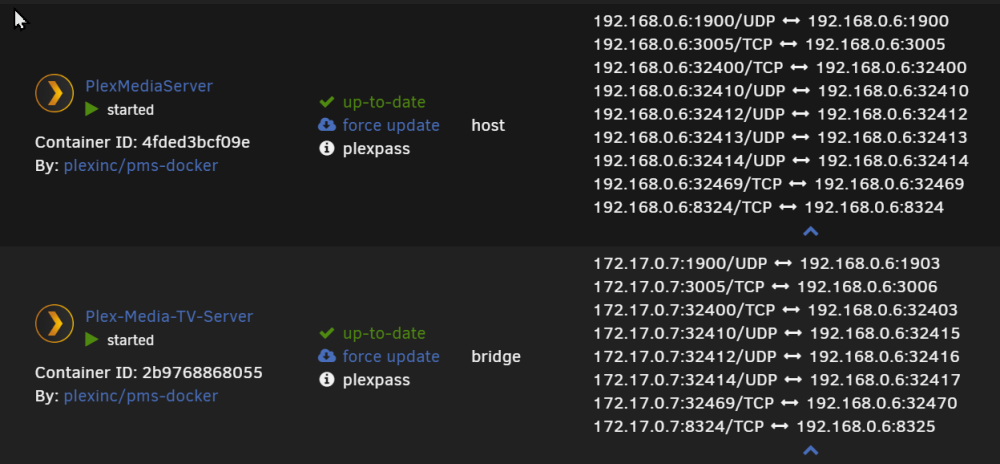

Ok so I read up on ports and I changed them all like below (Making sure no ports conflicted)
image.thumb.png.a9aa08ba80711538be2e2e20ac0ef66c.pngI now have first in Host and second running in bridge (Hmm I didn't try proxynet? would that work now?)
Anyway NMP is now working with one as host and one in bridge.
Thanks again for explaining this!
