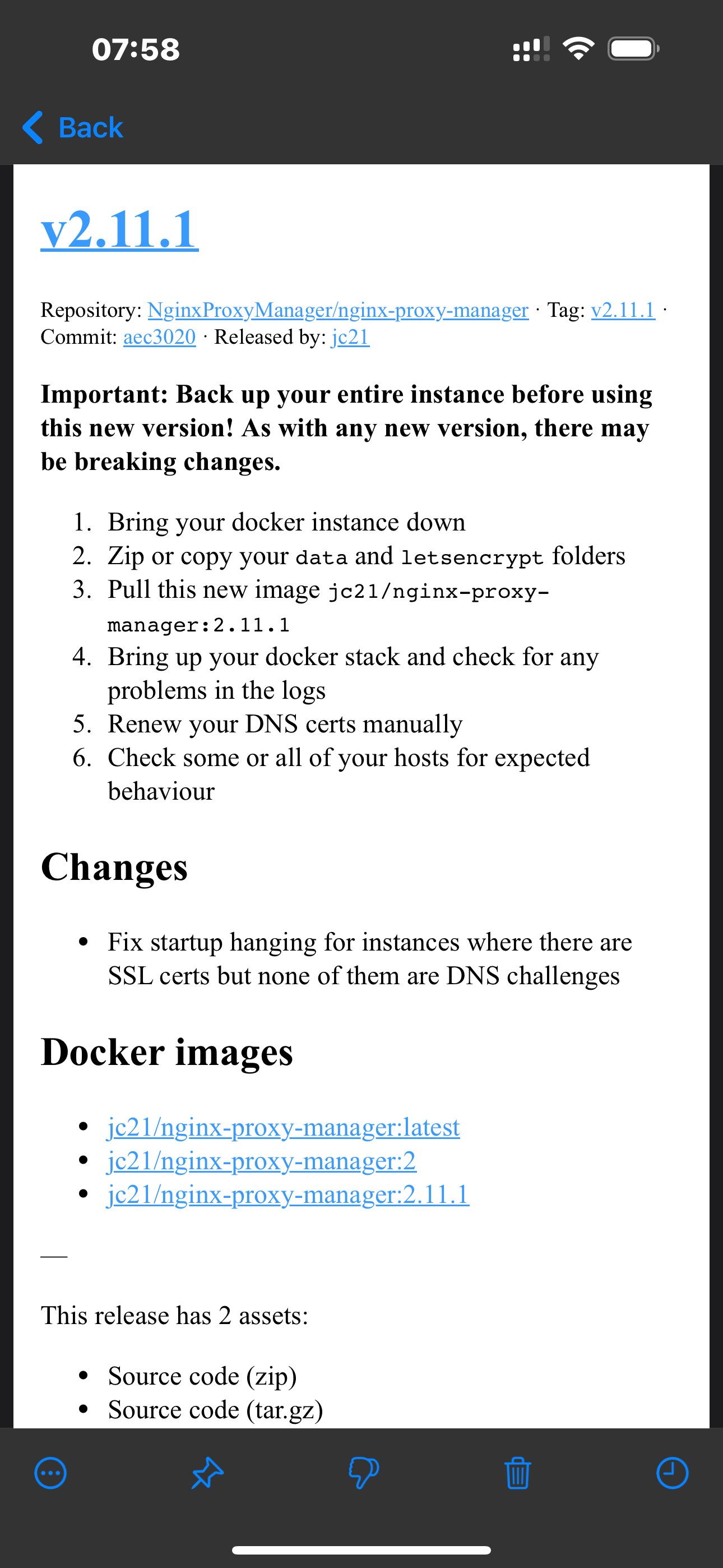

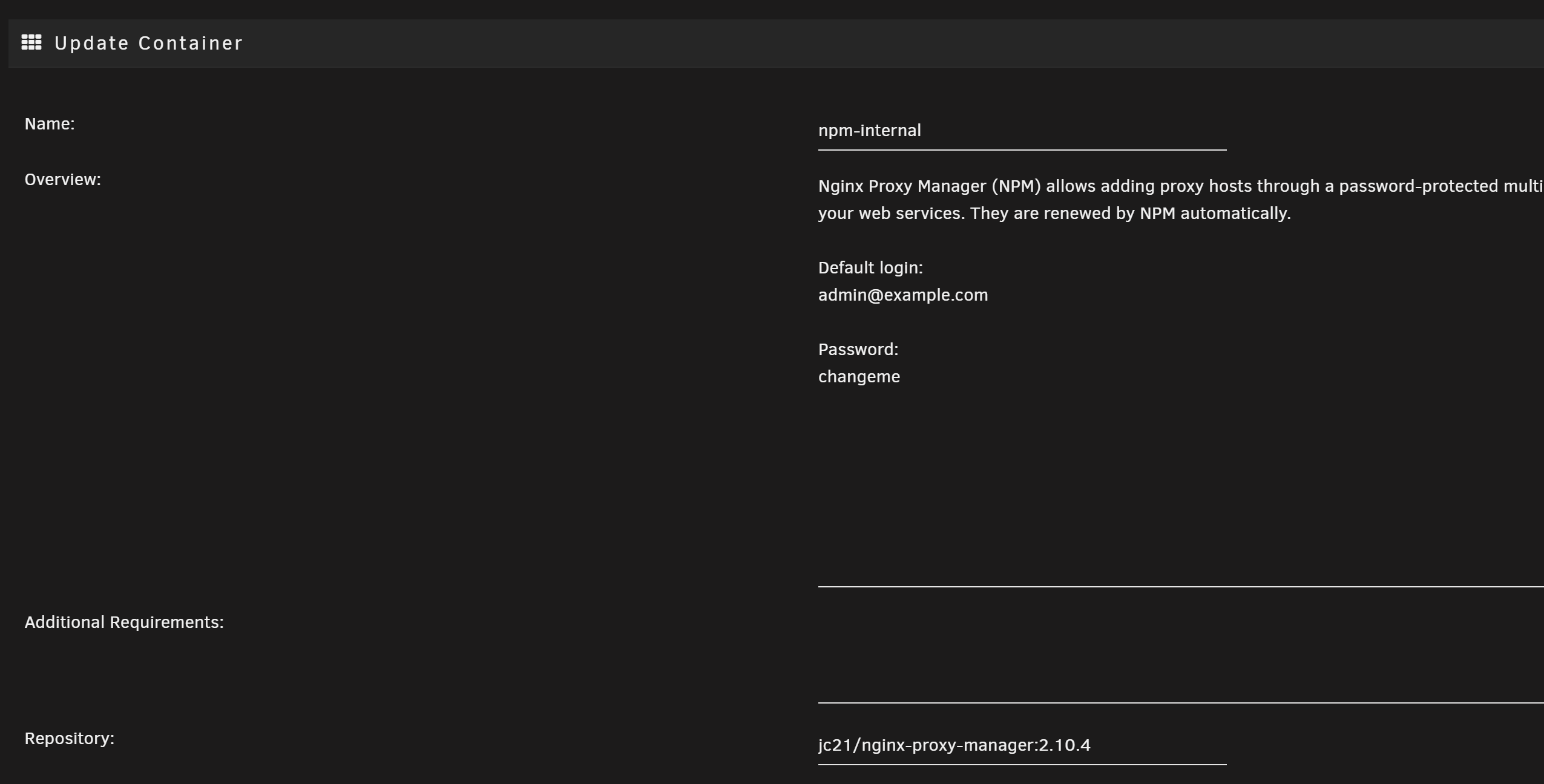

https://github.com/NginxProxyManager/nginx-proxy-manager/issues/3237#issuecomment-1900351270
18 minutes ago, nerbonne said:
How do you roll back to 2.10.4?
2.11.1 is alleged to fix the login issues and issues with 2.11.0.
