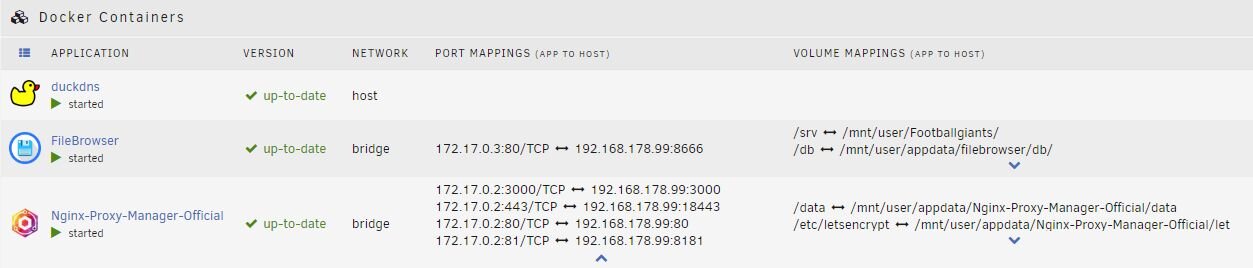

Guys I need your help. I'm about a week deep into my Unraid experience and can't setup NPM to access File Browser via HTTPS. HTTP is working fine for some reason.
As recommended here I tried using NPM as host and DuckDNS and File Browser as bridge. But nothing works so far.
Any suggestions?
Any help is appreciated. Thanks!

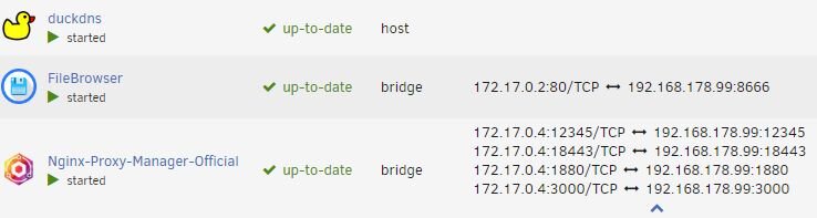

Ok. So ist should like this now right? Yet I get a 502 Bad Gateway openresty error...
Why did you even change the container ports?
I was trying to replicate what you did in your Nextcloud, Duck, NPM YouTube Tutorial lol
Bad Gateway usually means that NPM is not able to reach the target. What happens if you open your public IP in your browser? Note: most browser change it to https:// so edit it, so it really loads http://yourIP
It should show the NPM welcome page (if not try with your mobile phone and mobile connection).
Regarding your screenshot: The port setting looks correct now. And you are sure you can use port 80 on your unraid server (usually this is used by unraid itself if you don't changed it).

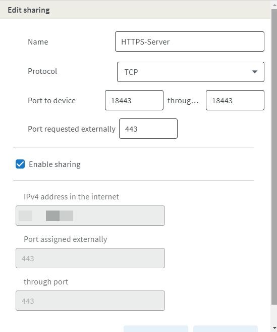

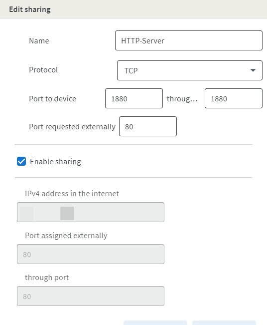

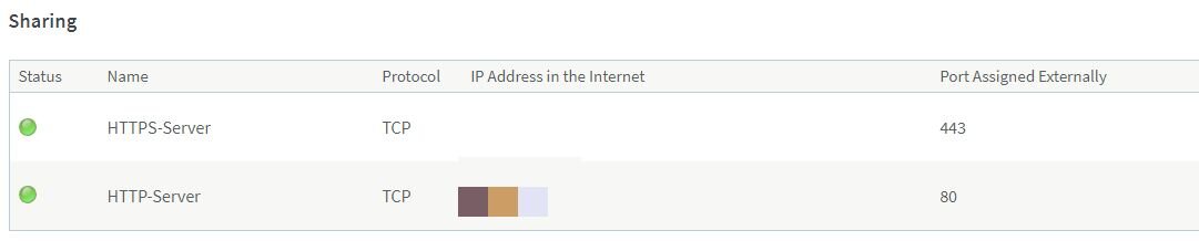

I did. The error I received was ERR_CONNECTION_REFUSED
Your router forwards 80 to unraid:80?
I think so... See below
Thank you again!
The router forwarding is wrong.
You are forwarding from port 80, which is http, to port 1880 on your unraid server. In your last screenshot of your containers, you showed, that you forward port 80 of your host (unraid) to port 80 of the container (npm).
As nothing is listening on port 1880, this explains why the connection can't be established.
Two options:
- change the router forwarding from 80 to 80
- or change the host port of the container to 1880

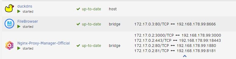

Ok. Thanks. I did it. See below
We made progress: My IP now leads to the NMP welcome page.
http://192.168.178.99:8666/ now opens File Browser
BUT https://192.168.178.99:8666/ as well as my duckdns domain leads to 502 openresty error page.
Thanks for your patience with this Rookie sir! Much appreciated as always!
