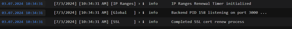

Thanks for the info , im sorry found in log on my vps server where im using this container :

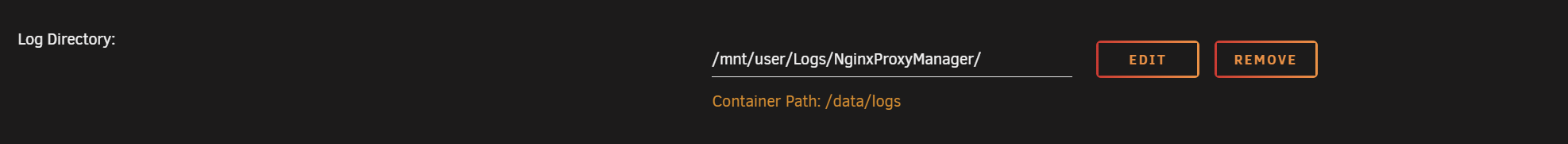

if i need to put Logs to `/mnt/user/Logs/NginxProxyManager` is it right also host errors  ?
