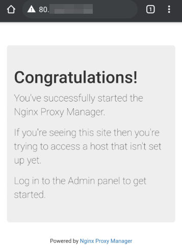

If you instead receive a 5xx / timeout error, your domain could have a wrong IP in the DNS/DDNS database or your internet provider does not provide a real IPv4. You can test this by opening your public IPv4 with the same mobile device outside of your Wi-Fi:
http://11.22.33.44/
This must return the welcome page of NPM:
721522783_2021-10-2818_28_44.png.753ba9b5b0c5ba6c916b06790f75386d.png.6e2b8ed924fafc2d13ac59aeedfb9d8f.png
If not, then port 80 is probably closed or your IPv4 is not public reachable.
Only if this requirements are met, Let's Encrypt is able to reach your NPM container and verify the SSL certificate. Note: This is automatically repeated every 90 days to re-verify the certificate, so port 80 must stay open!

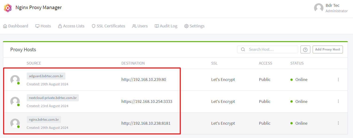

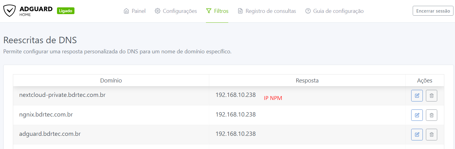

I'm trying to configure NMP to manage the IP:Port redirection for the domain.
I haven't opened any ports on my router, I'm using Clouflare Tunnel.
My question is “How can I set the NPM IP in AdGuard?” because to access the NPM I need IP:Port and AdGuard doesn't let me set the Port.
I have a network to my dockers called "bdrtec", but AdGarud and NPM is in "br0" network because in "bdrtec" network I can't access the WebUI.
Thanks in advance for your help.

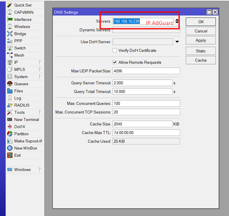

1) Set DNS AdGuard Mikrotik
2) AdGuard Configuration
3) NPM Configuration

1 hour ago, Braulio Dias Ribeiro said:
My question is “How can I set the NPM IP in AdGuard?”My question is “How can I set the NPM IP in AdGuard?” because to access the NPM I need IP:Port and AdGuard doesn't let me set the Port.
Which is correct. A domain is nothing else as an easy reminder for an IP address. So if IP:port works, you can use domain:port if the domain has a DNS entry returning the correct IP address.

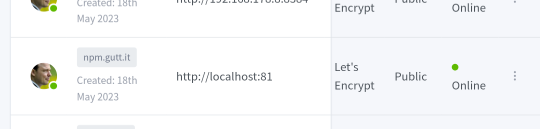

If you don't like to add a port to a domain name you need to change the IP of the domain so it points to a reverse proxy like npm. In NPM itself you need a rule which points to itself. This is how I solved it:
And my domain "npm.gutt.it" returns the IP address which points to NPM.
Side note: As you are trying to add a DNS entry by using Adguard. Did you verify it is working? So "ping your-npm-domain" on your client should return this IP address. If it is returning the IP address, but failing to reach the target, you maybe have a router which does not support "NAT loopback" or it disallows DNS resolution to local IPs called "DNS rebind protection"?!
Additional note: If you use Adguard as your DNS server in your router, you need to add a public DNS IP to unraid or everytime adguard isn't running (for example server reboot), Unraid is not able to reach domains.

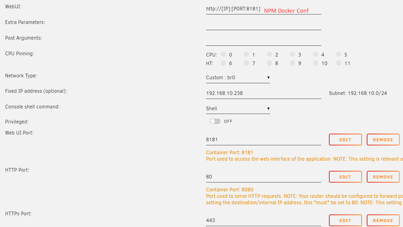

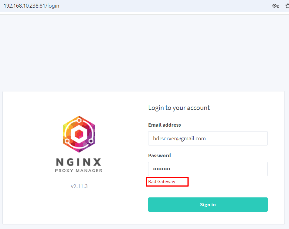

@mgutt after much analysis, I found the solution, but another problem appeared lol
Can you help me understand.
npm was configured to listen to port 880 and 4443, I just changed it to 80 and 443 and it worked. I forgot that the http request comes from these ports.
My docker network configuration is:
- Docker custom network type: ipvlan
- Host access to custom networks: Disabled
I have this problem now:
1) npm is configured on the "br0" network with a fixed ip (192.168.10.238). But I can't access the panel because when i try to do login , shows the error “Bad Gateway". All the other containers are on a single network (bdrtec), only npm is on “br0”.
Edited by Braulio Dias Ribeiro

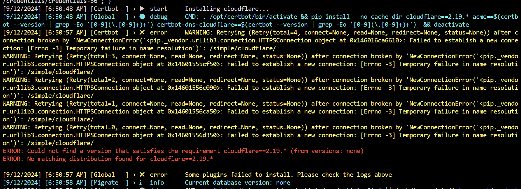

Anyone seeing anything like this before? Can't/couldn't renew Certs, simply rebooted NPM and now:
Cloudflare plugin can't be installed? The heck? Any ideas?

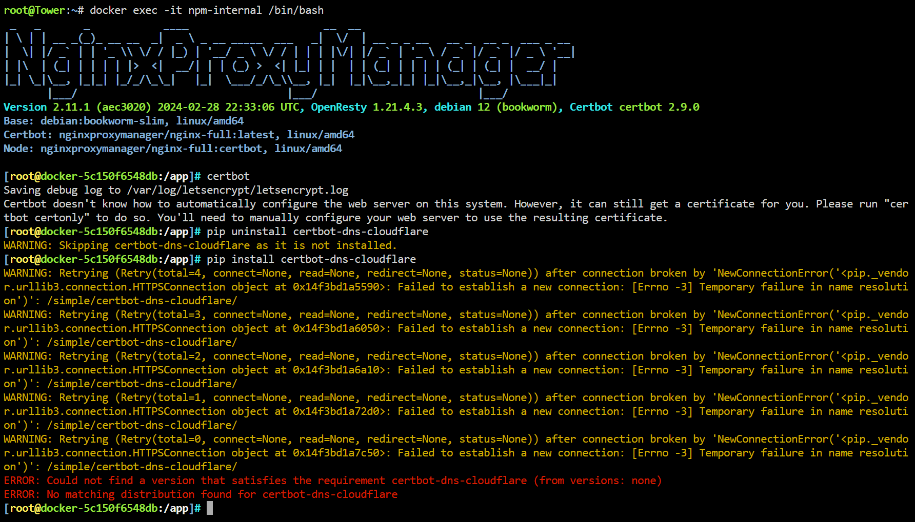

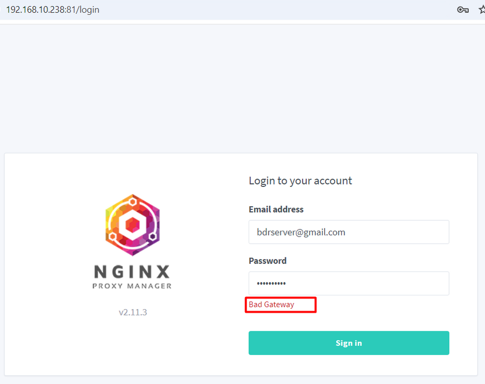

Since it seems to be stuck trying to install Cloudflare over and over now I can’t even login to NPM. It’s still routing etc but can’t log into website/GUI. 🤔
EDIT: Maybe this? https://github.com/NginxProxyManager/nginx-proxy-manager/issues/3824

I have a similar login problem.
My docker network named “” NPM opens normally, when I put it in the “br0” network it doesn't open and gives an error when logging in. It also doesn't update the certificate.
In my case it's related to the network but I can't solve it.
This resulted in:
I don't understand this temp failure in name resolution thing?

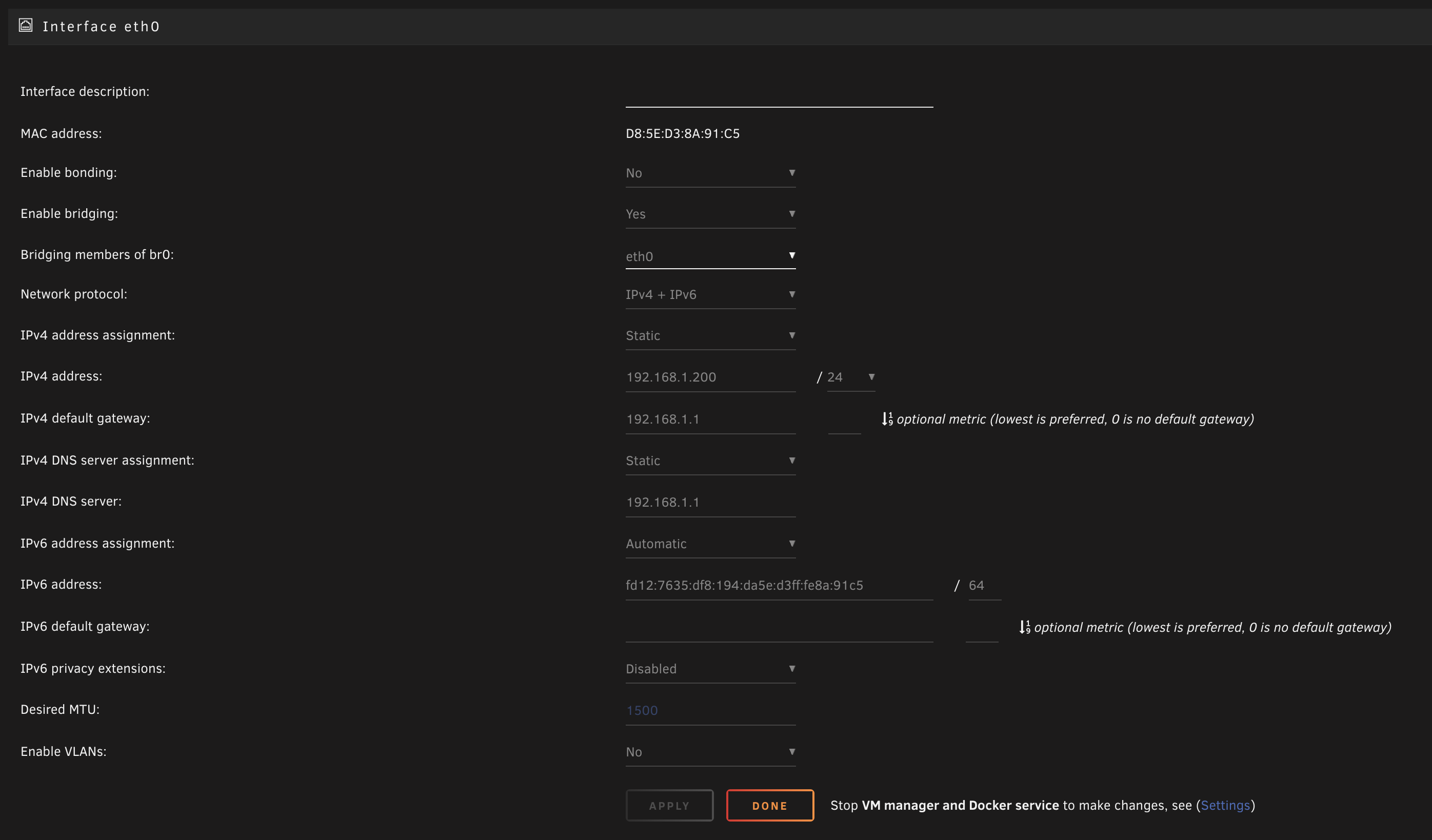

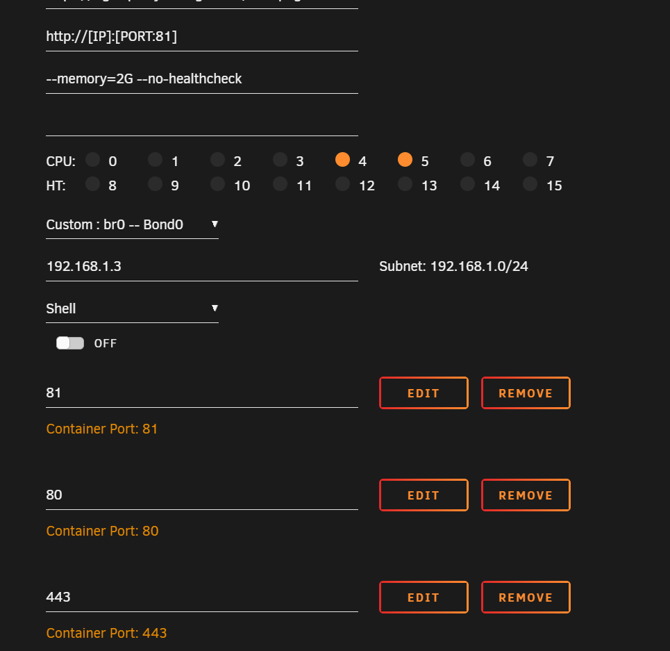

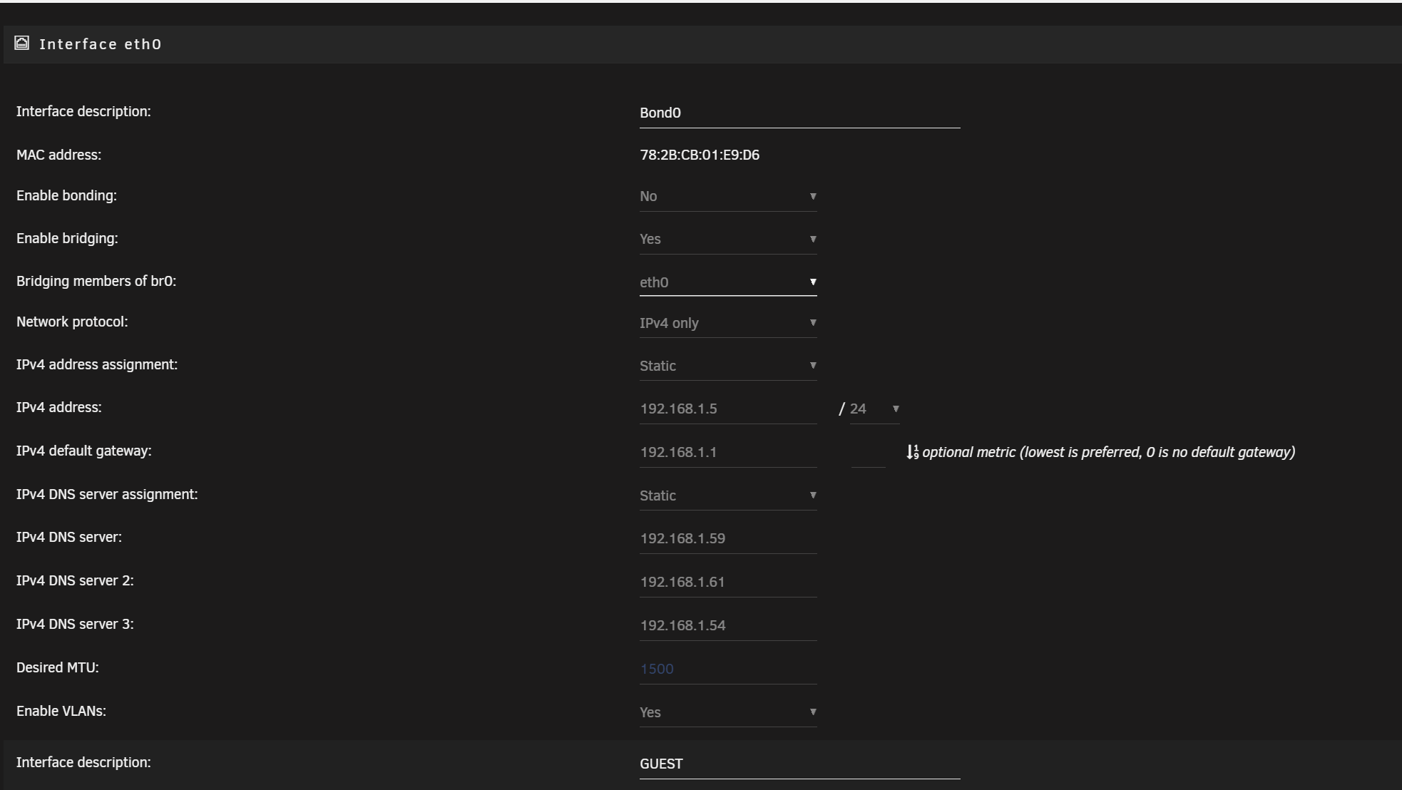

So, I figured my mess out - not sure what changed when. Evidently something changed with Unraid 6.12.13? I have always had NPM on a br0 with a IP on my network. Evidently br0 can't reach outside network anymore and THATS what issue was? To get this "fixed" i had to change Unraid Management GUI off 80/443 to 8947/8948 and THEN changed NPM to "HOST" mode and restarted it. It immediately was able to grab the things it needed and renew certs. I moved it back to br0 now that certs are renewed but what changed about Unraid that would warrant me having to have NPM on HOST mode and that br0 will NOT work any longer?
Edited by blaine07

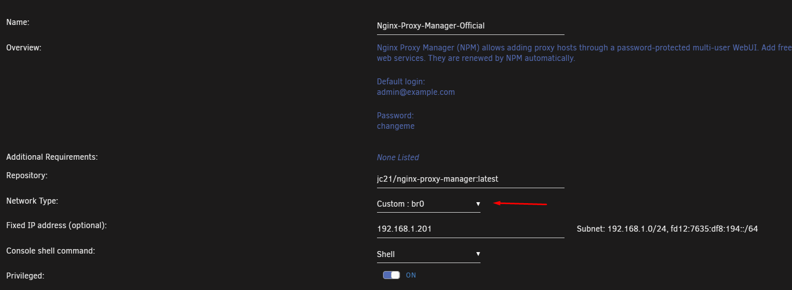

If it helps, I have mine setup like this and it works perfectly:
That is 100% how mine/was when it didn't work, too 😞
Yeah in main post I mentiond BOND and should've been br0 - ugh LOL. Yeah entire time mine has been like this and wont work
Edited by blaine07
My problem is the same.....in "br0" network it's don't renew my certificate and I can't login in NPM. See image.
I'm trying resolve a long time ago.

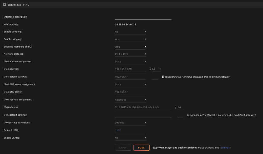

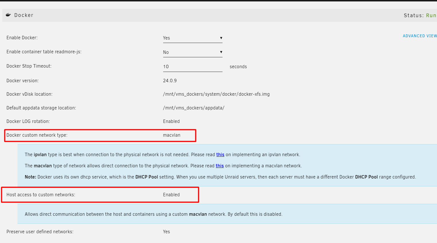

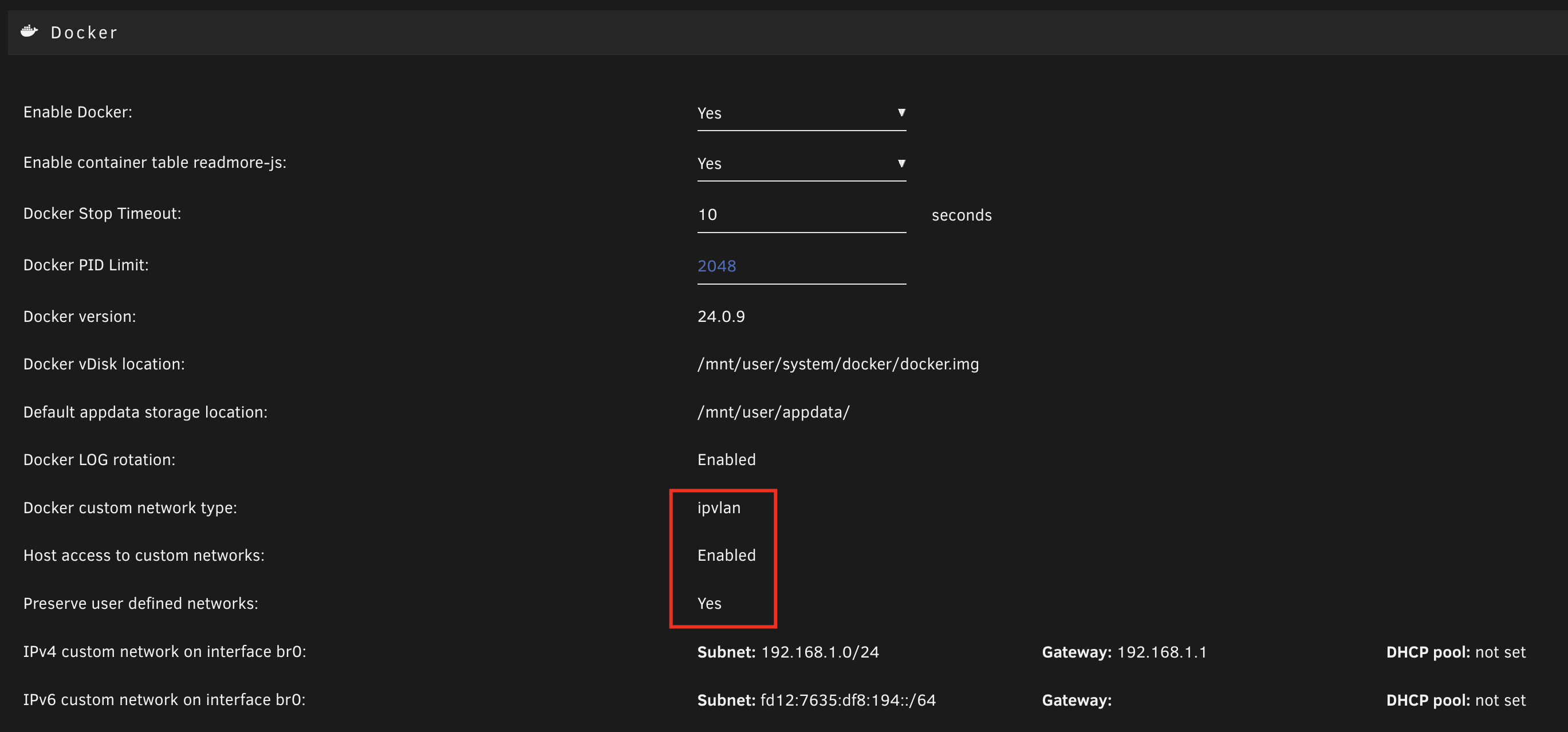

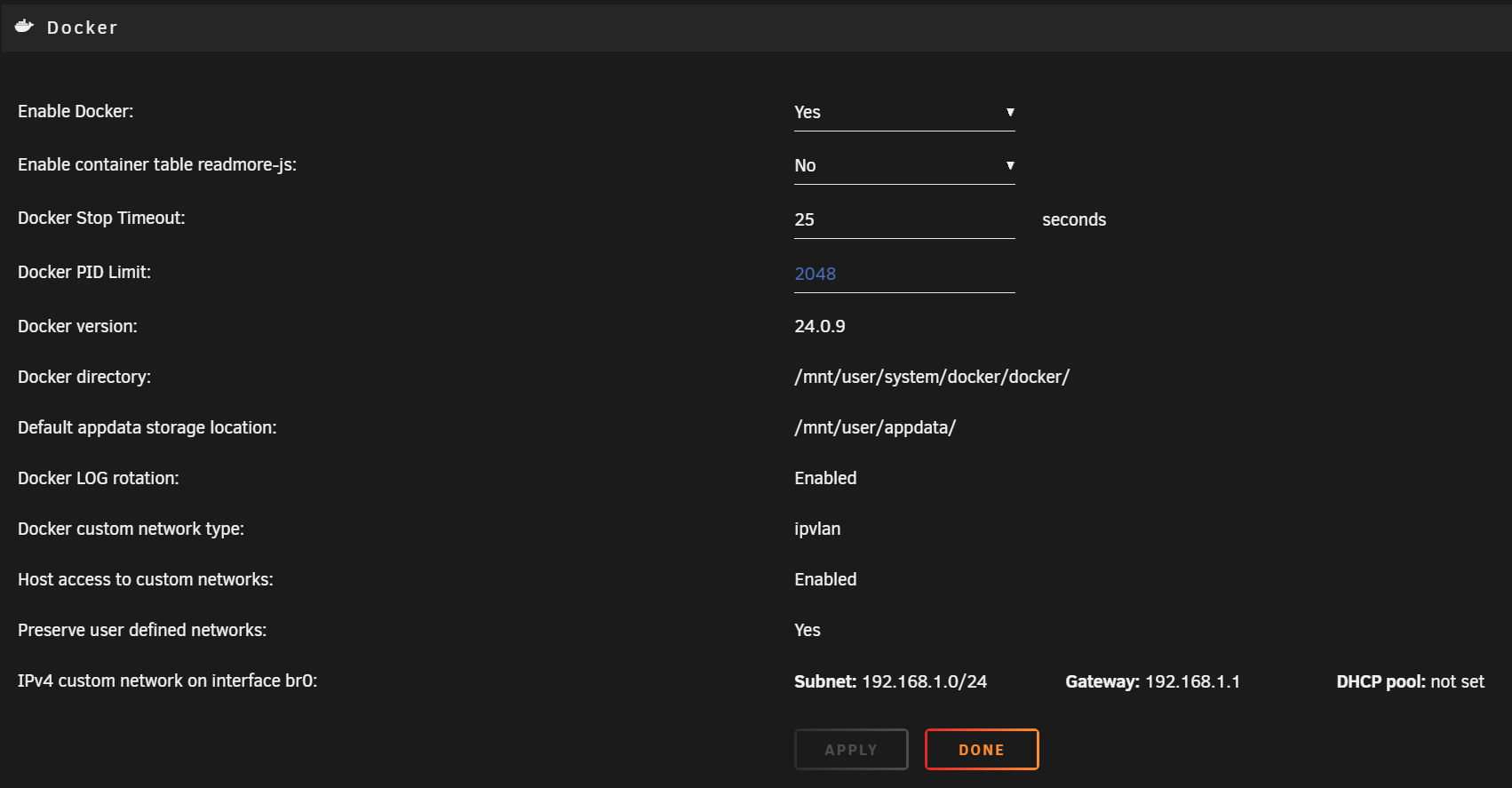

@cscoppa @blaine07
There are other settings that interfere.
How is your docker network configuration (Settings -> Docker)?

21 minutes ago, Braulio Dias Ribeiro said:
@cscoppa @blaine07

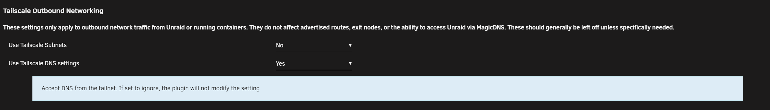

Woah, figured mine out, finally. Not sure what should or shouldn't be on to be honest...Recently, a few weeks ago? Converted from Tailscale DOCKER to Tailscale PLUGIN.
This, Tailscale DNS, was set to "YES." Once I changed it to "NO" and restarted NPM it updates and does as should correctly. Do I need DNS on or off or is that going to break what I am doing with Tailscale plugin or?
