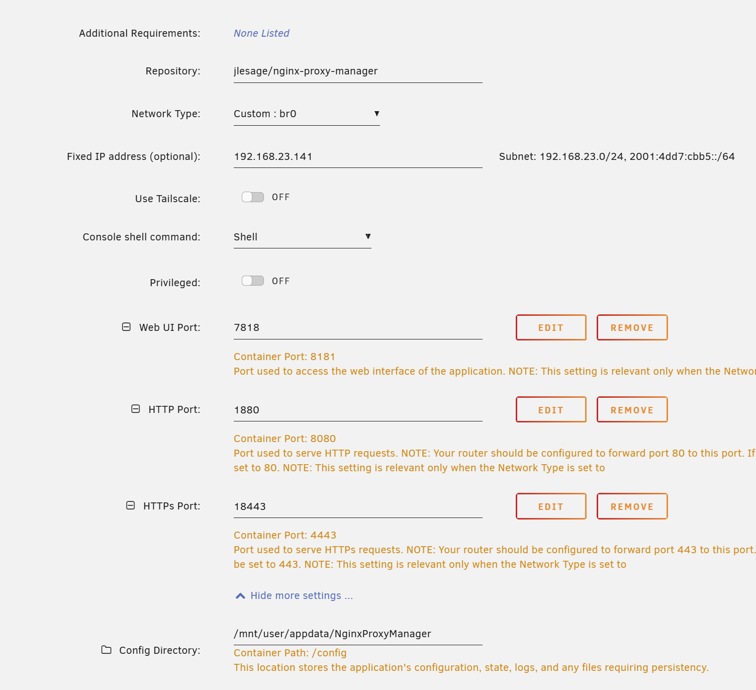

Hello, I'm using the NPM container in Unraid for quite a while and I'm quite happy with how it works.
However I do encounter a strange problem that I can't find a solution for:
Whenever I want to renew an existing certificat, I get this Error:
This Error occurs when I try to manually renew a certificat via certbot. My container log just gave me an error while trying to auto-renew (referring to the letsencrypt log, that I don't understand. I can share it if you want).
Creating a new certificat for that same host however is no problem.
I checked the things you recommended.
My Port is reachable
I get a result by entering my IPv4:
And the target container is reachable via NPM:

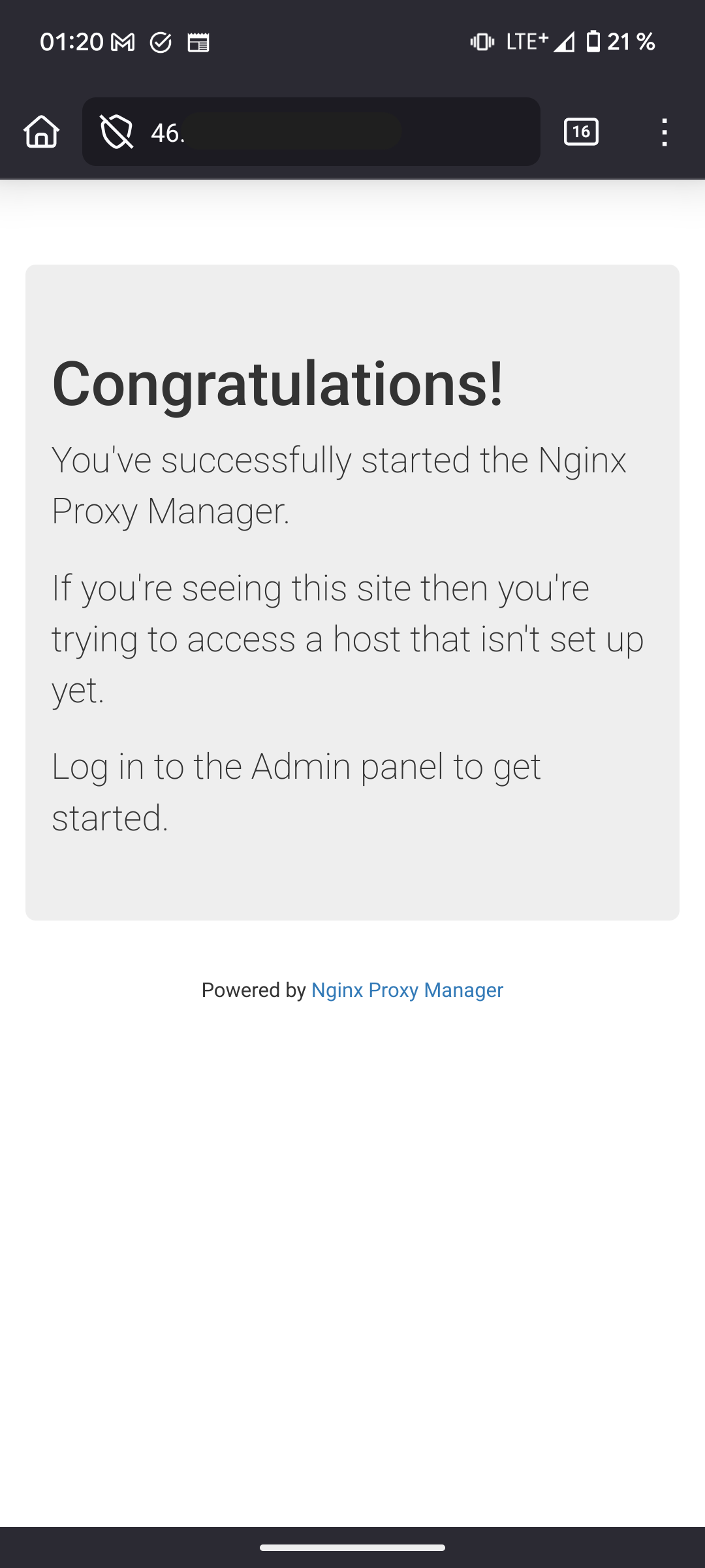

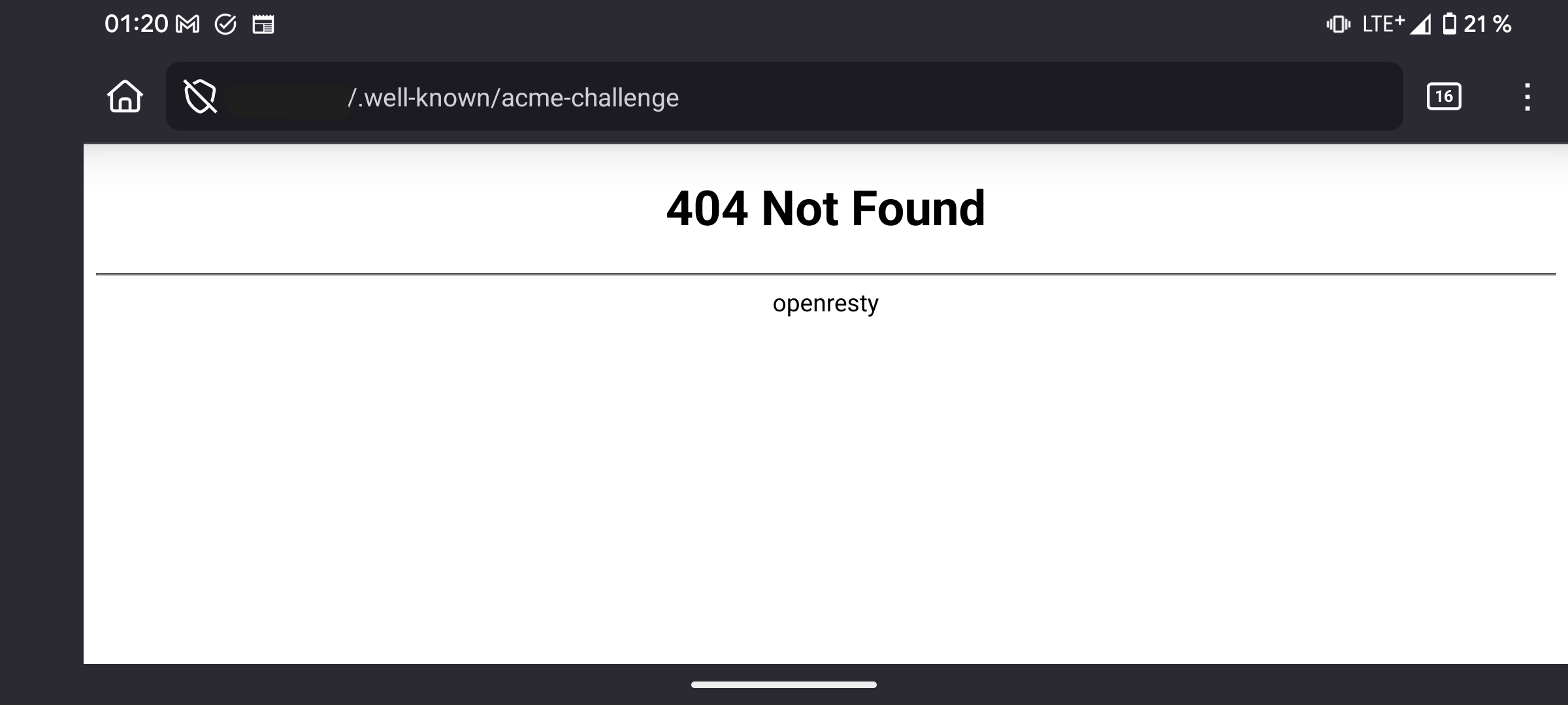

Both are relevant for creating and updating certificates.

2 hours ago, mgutt said:
A simple search for "error" or "fail" should show the relevant lines. Else remove your private information and post it here.
For readability I put the code at the end. I've also attached the anonymized file, but this seems to be the relevant part.
According to the hint letsencrypt needs some sort of file that's created by my certbot, however I don't know what I need to do in order to make it available.
That's irrelevant for certs.
We need the errors which are logged in this file. I still don't understand why they aren't forwarded to the container output, so we would be able to see them through the unraid gui. So please open the file in your npm appdata folder. A simple search for "error" or "fail" should show the relevant lines. Else remove your private information and post it here.
letsencrypt.log
I think it's because the authority server tries to reach your domain through your IPv6, which is wrong:
5 minutes ago, Qesaru said:
Certbot failed to authenticate some domains (authenticator: webroot). The Certificate Authority reported these problems:
  Domain: sub.mydomain.com
  Type:   connection
  Detail: 2001:###:####:####:####:####:####:3736: Fetching https://sub.mydomain.com/.well-known/acme-challenge/#########################: Error getting validation data
How do you update the IPv6 of your domain and does it target your NPM container? Note: IPv6 must not be the one of your router as it is for IPv4.
You can test your IPv6 similar to IPv4 in your browser by adding brackets. Example:
http://[2001:4860:4860::8888]:80/
You must see the npm welcome page equal to your IPv4 tests.
IPv6 can be more challenging to setup. On the first page I showed one example by running npm in the host network, so it shares the same IPv6 as unraid. But you need to update your domains IPv6 everytime Unraids IPv6 changes.
Most people gave up and disable IPv6 😅

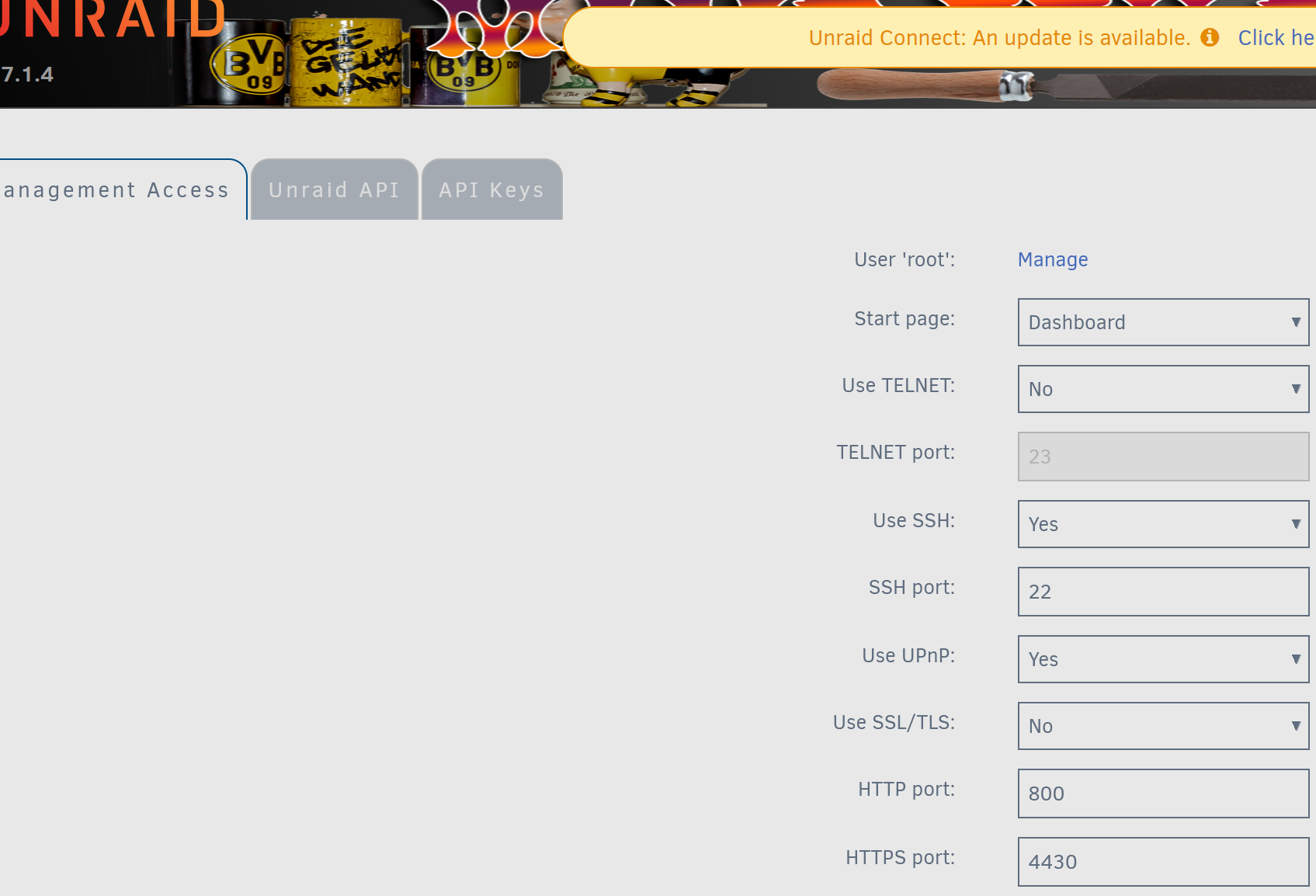

I feel like I'm SO CLOSE to getting my setup right. Here's what I've done:
  • Running a docker app on port 300X that I want to expose.
  • Also running a PiHole
  • Installed and set up DDNS
  • Set up A name pointing to my IP
  • Created CNAME for app.example.com
  • Forwarded ports 80, 443, and 300X for my app
  • Created host in NPM for app.example.com on port 300X with a LetsEncrypt cert
When I visit app.example.com, I do not see my docker app. Instead, I see the Unraid login screen. That only happens when I forward port 80. When I do not forward port 80, I get a timeout 522 error.
Why am I being taken to the Unraid login screen? I definitely do NOT want to expose that, if possible. D
Because you forgot to add Step 1 :-)
1) MOVE UNRAID away from Port 80!
This can be done HERE
Change HTTP and HTTPS Port to a value that you like (and remember!).
Now NPM can run in Host mode and take over these ports.
Btw, you still cannot access Port 300x from the internet, NPM only tunnels 80 and 443.
Edited by MAM59
A basic thing that I completely forgot, thank you!!
I can now reach app.example.com. A few minutes after implementing the change, my app was available but some content (like images and some forms) were not rendering. I think this is a caching issue and will update this response if I figure out why the content did not render.
Edited by acdn01

hi
hope some one can give me some help i have moved to unraid and installed Nginx Proxy Manager to see how it works the only challenges i have for now is my plex sever and docker-uisp both is comming up as This page isn’t working but all the other containers is passing throug am i missing someting and yes i did do Let's Encrypt.
thanks in advance.
Did you make some of the checks of the first posts?
yes i have read few of them seems to fail to understand what i am doing wrong
