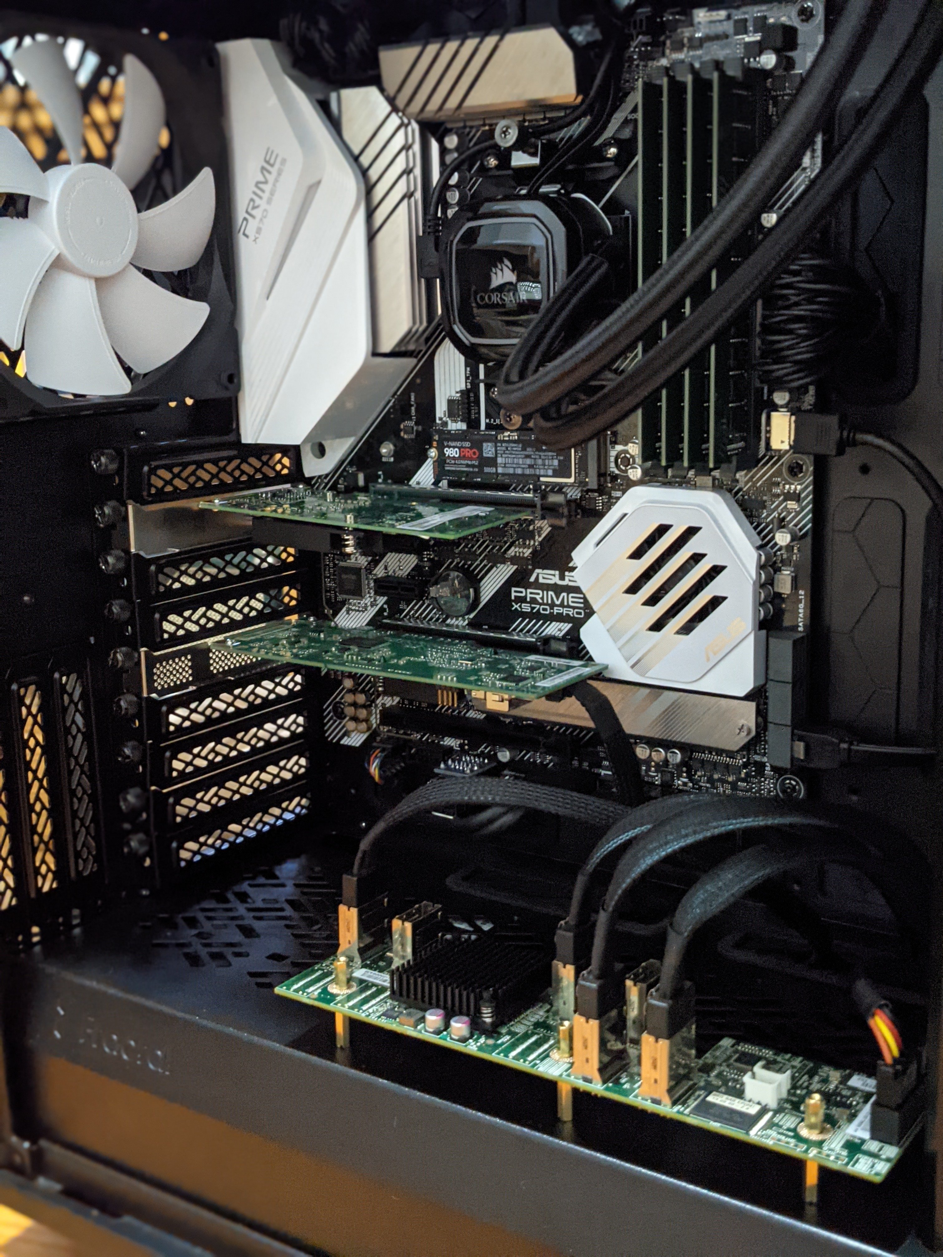

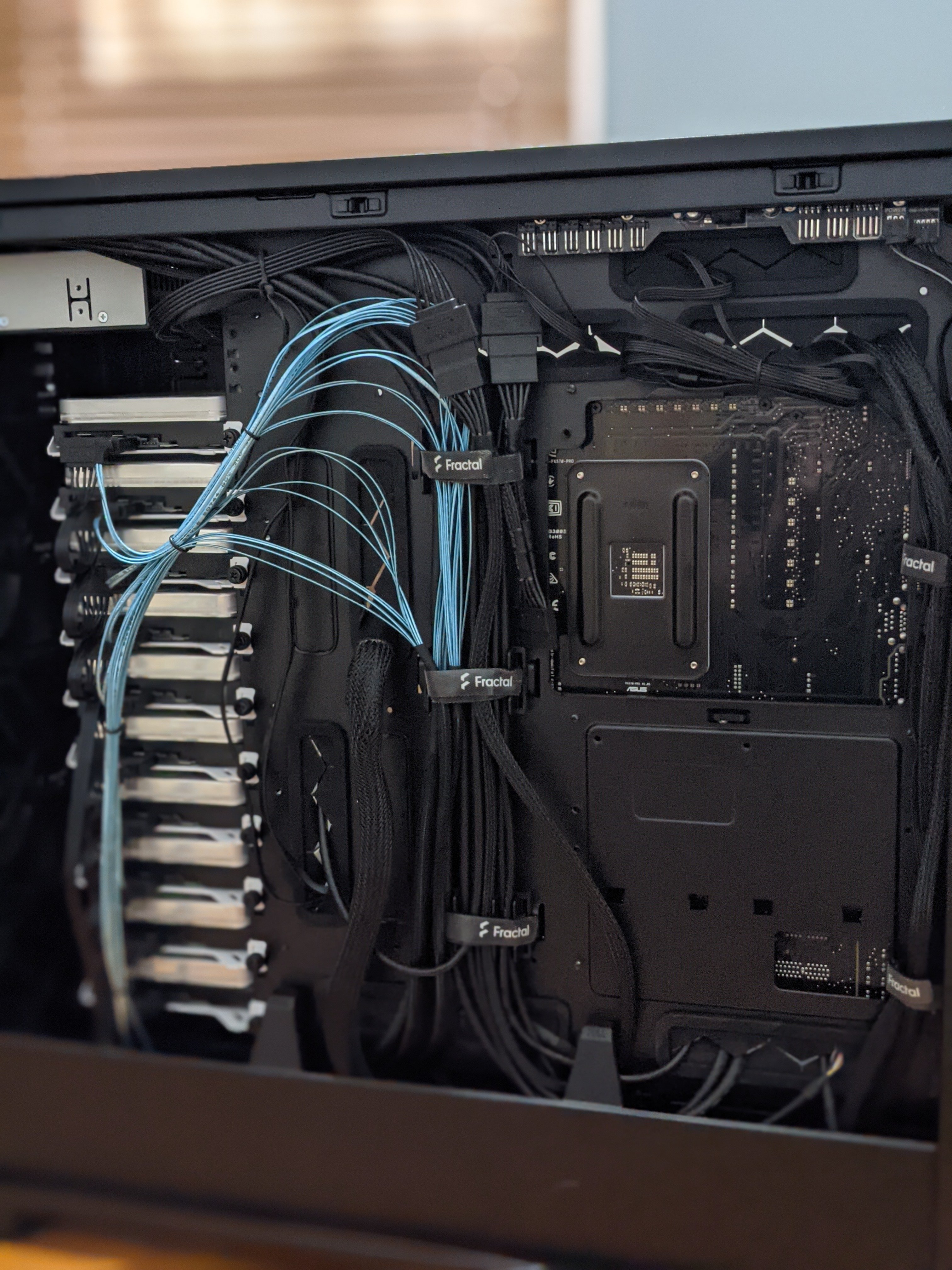

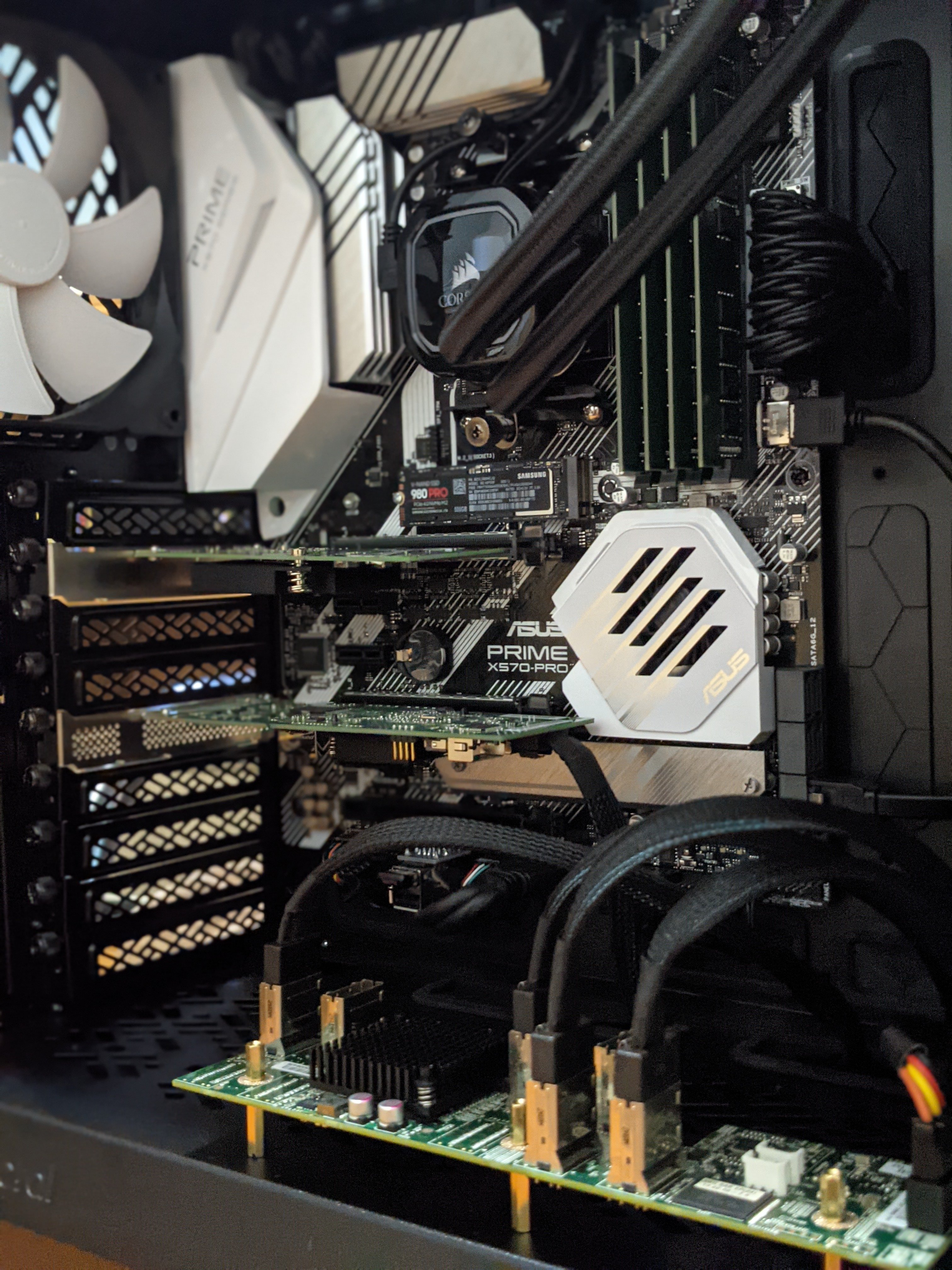

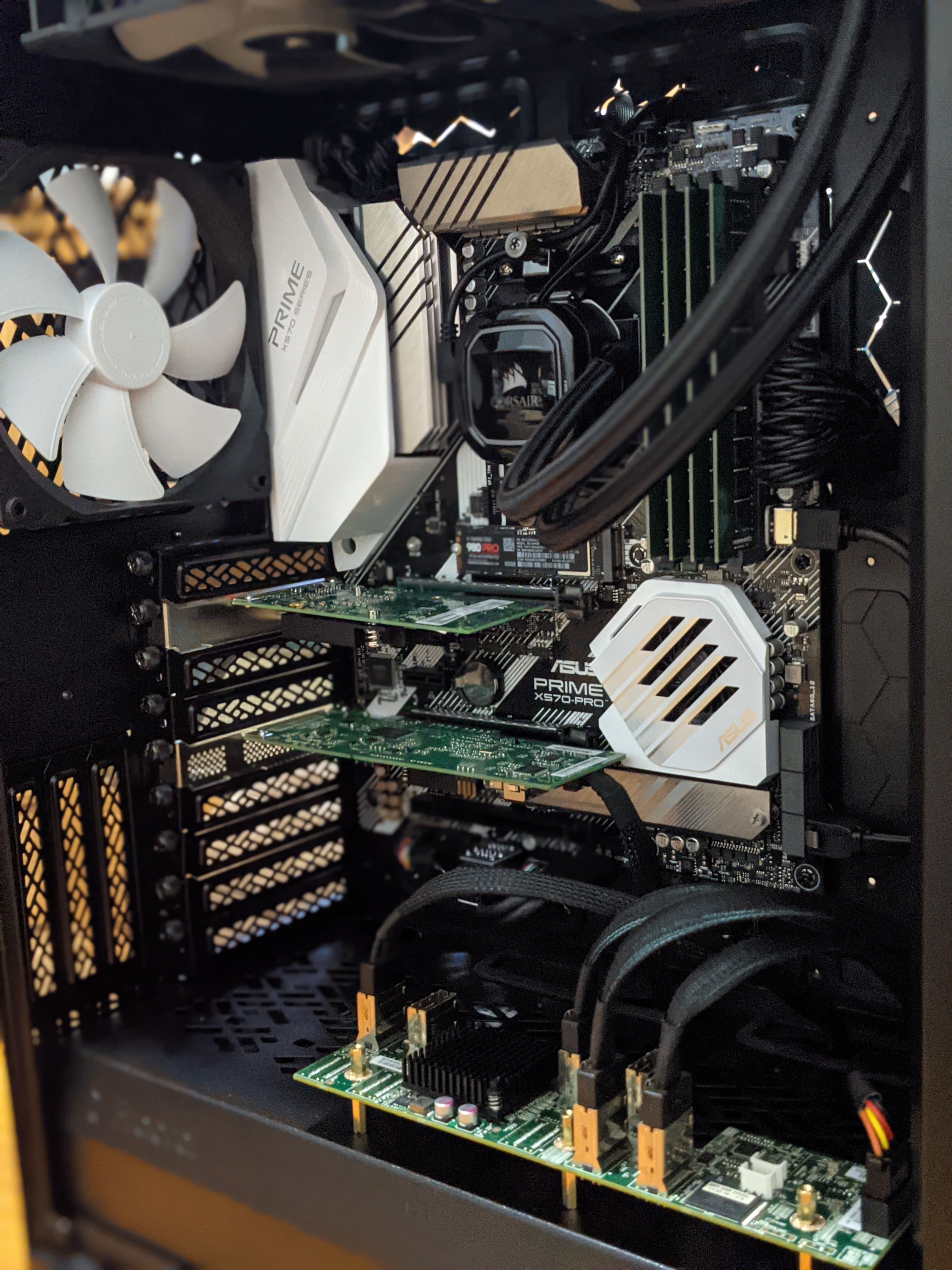

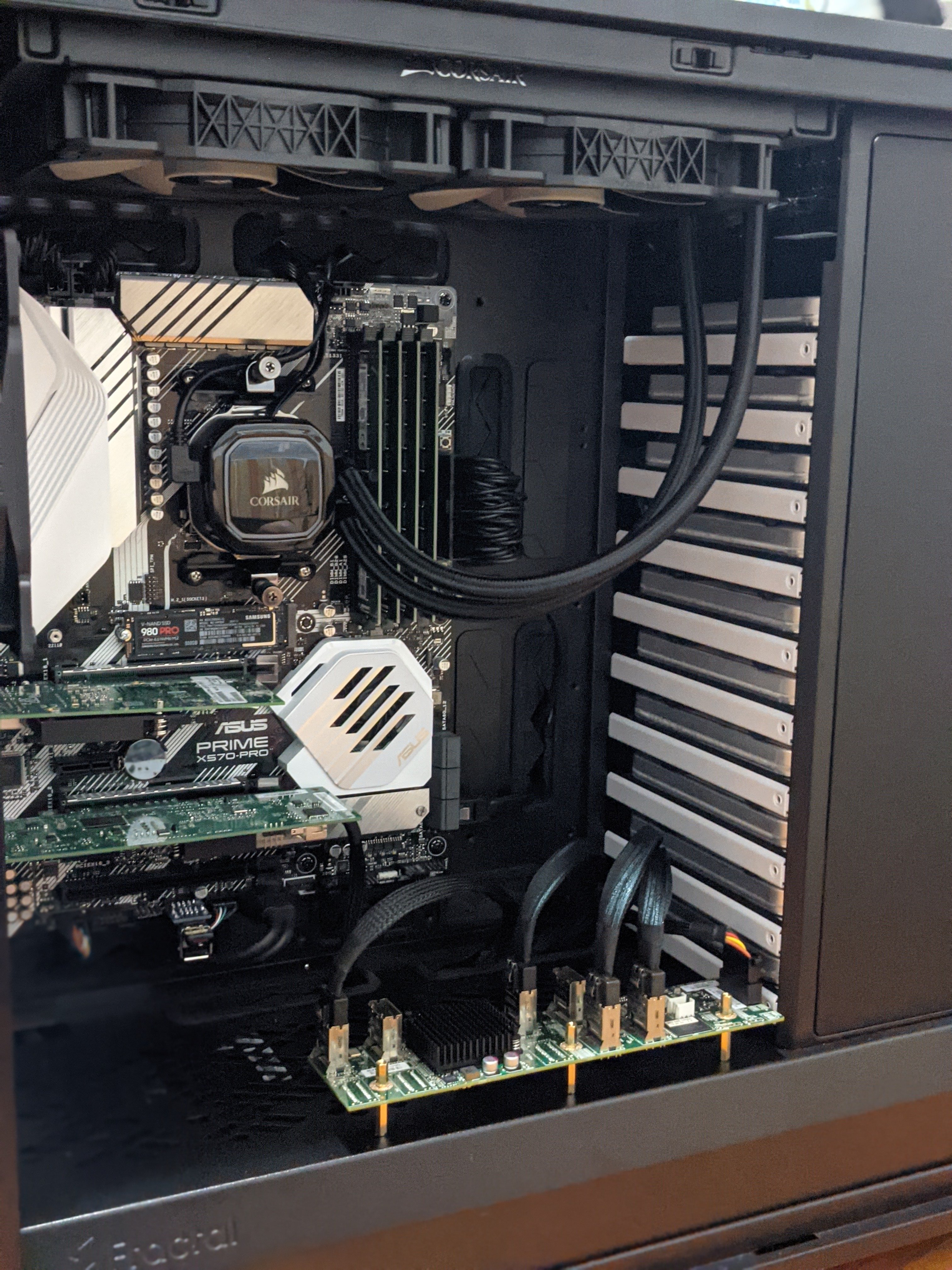

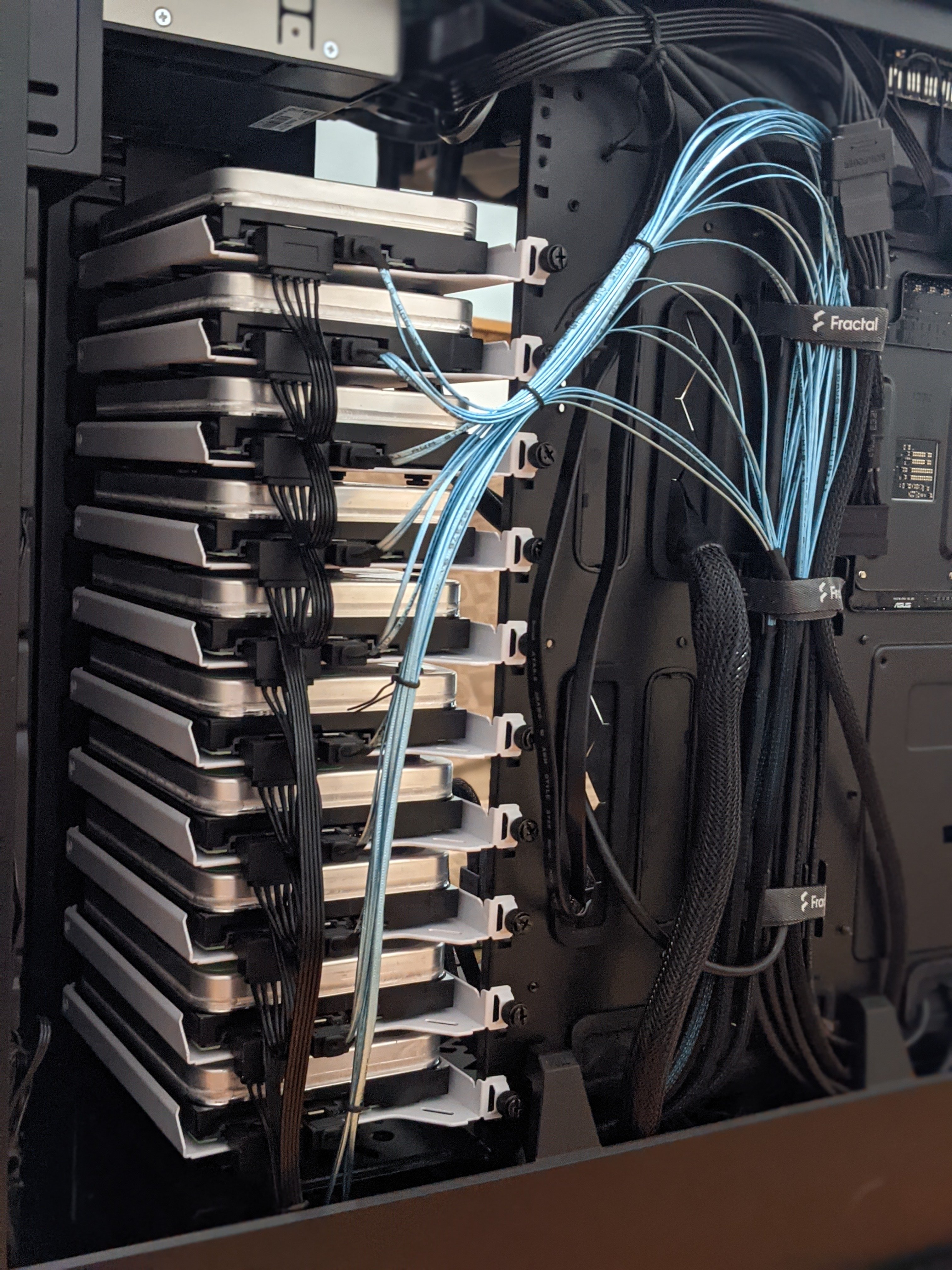

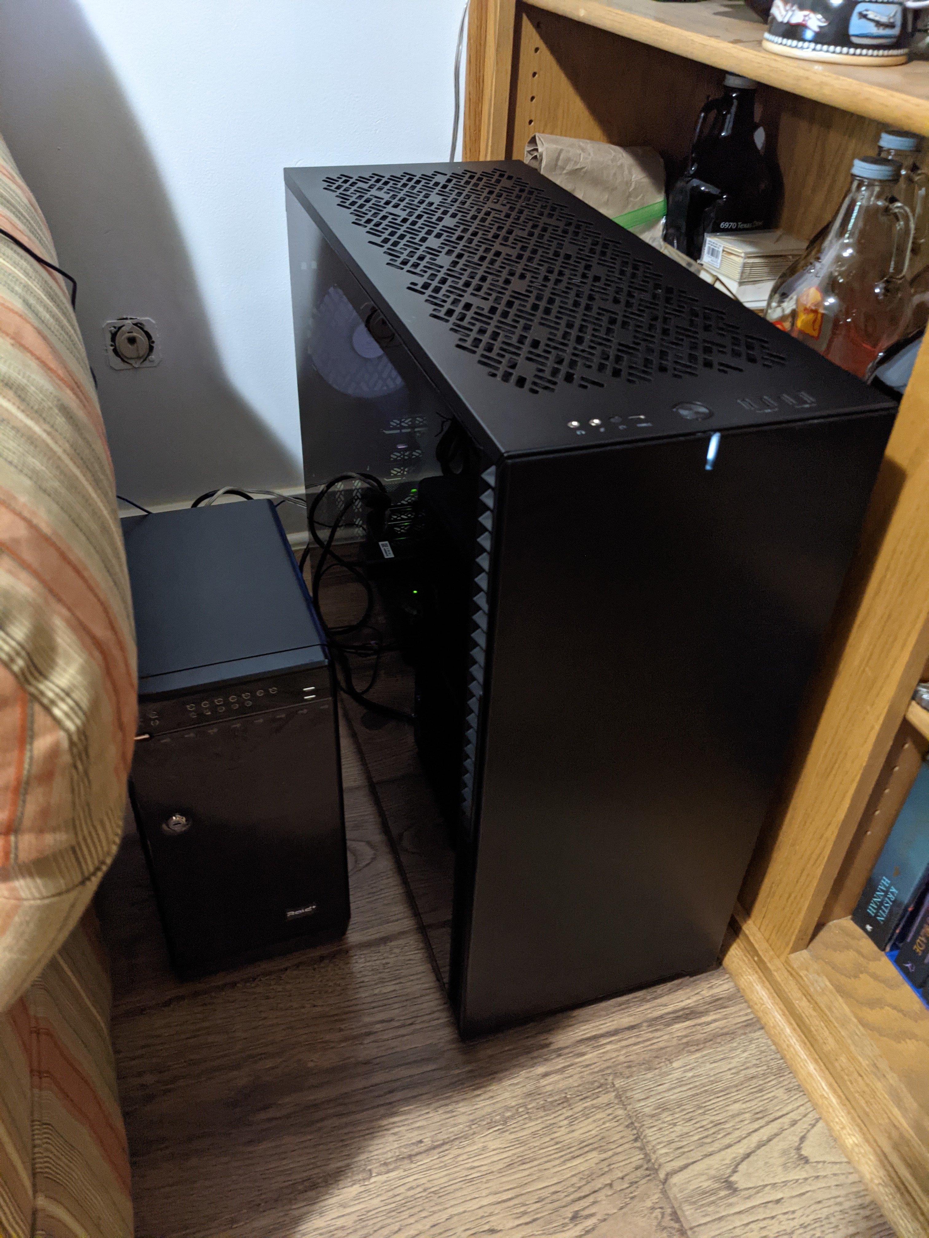

June 17, 20215 yr Hey all, Pretty proud of my first Unraid machine. Finally have it to a "finished" state. I wanted to share some good photos but I'm no photographer. I scored all 10 14TB HDD's from shucking Seagate external drives a few months ago, before the price boom, so $225 apiece. Hoping price comes back down because I have space for a few more. I'm still in the learning phase but I have set up OpenVPN, Nextcloud with reverse proxy, Plex, Windows 10 VM, and Ubuntu VM. Running headless for now until I have a need for a GPU assuming they come down to MSRP. I have a 10Gbps card in this and my regular PC, so they're directly connected without a switch. All-in cost right now is north of $5k, but I am also interested in upgrading to a Ryzen 5900/5950x when those are available at MSRP also. Before anyone gets concerned, the drive power lines are not all chained together.
June 17, 20215 yr Amazing build, & a great choice of hardware overall, This is what I would call a perfect build. Just make sure you protect your investment with a decent UPS, it saved my server at least 2 times in the last 6 months from outages. Welcome to the club.
June 17, 20215 yr Author Just now, PSYCHOPATHiO said: Amazing build, & a great choice of hardware overall, This is what I would call a perfect build. Just make sure you protect your investment with a decent UPS, it saved my server at least 2 times in the last 6 months from outages. Welcome to the club. Thanks dude, yep I have a UPS tucked back there too.
June 19, 20215 yr On 6/17/2021 at 11:59 PM, stev067 said: I scored all 10 14TB HDD's from shucking Seagate external drives What are your HDD's temps when active? Do you run the stock front fans?
June 19, 20215 yr Author 4 hours ago, Lolight said: What are your HDD's temps when active? Do you run the stock front fans? Looks like the highest temp any of the HDDs has seen is 36C, with most of them showing highest of 32C. I actually have a temperature sensor probe coming tomorrow, that I am planning to put in the HDD area, to set the fan curve for the front fans, which are just the 3 stock fans. I haven't spent much time on fan settings yet, I just sort of set everything at balanced. I'm also going to be test fitting some 40mm fans for my 3 cards tomorrow.
June 20, 20215 yr 11 hours ago, stev067 said: Looks like the highest temp any of the HDDs has seen is 36C, with most of them showing highest of 32C. Those are impressively low temps for such a dense HDD arrangement. What are your ambient temps? Edited June 20, 20215 yr by Lolight
June 20, 20215 yr Author 5 minutes ago, Lolight said: Those are impressively low temps for such a dense HDD arrangement. What are your ambient temps? I'll take some temps tomorrow when the temperature sensor comes and let you know.
June 22, 20215 yr Author On 6/19/2021 at 8:59 PM, Lolight said: Those are impressively low temps for such a dense HDD arrangement. What are your ambient temps? I dug into the server last night and added the thermal probe, and checked out some temps in the bios. Apparently there is a motherboard sensor that isn't registering within Unraid, which was at 40C, and I'm measuring 25-30C on the HDDs. They look close together, but the airflow through them is really great, probably because the 3 fans are right there, and there's no cable clutter in that space. I left the temp probe between two of the HDDs and set the front fans to use that temp for its curve. I also added 40mm Noctua fans to my sas expander and raid card, and that lowered their temps an insane amount. Anyone have any idea why the dynamix temperature plugin is only registering my CPU and NVMe temperature sensors? Also, the dynamix fan plugin doesn't seem to register anything whatsoever. Edited June 22, 20215 yr by stev067

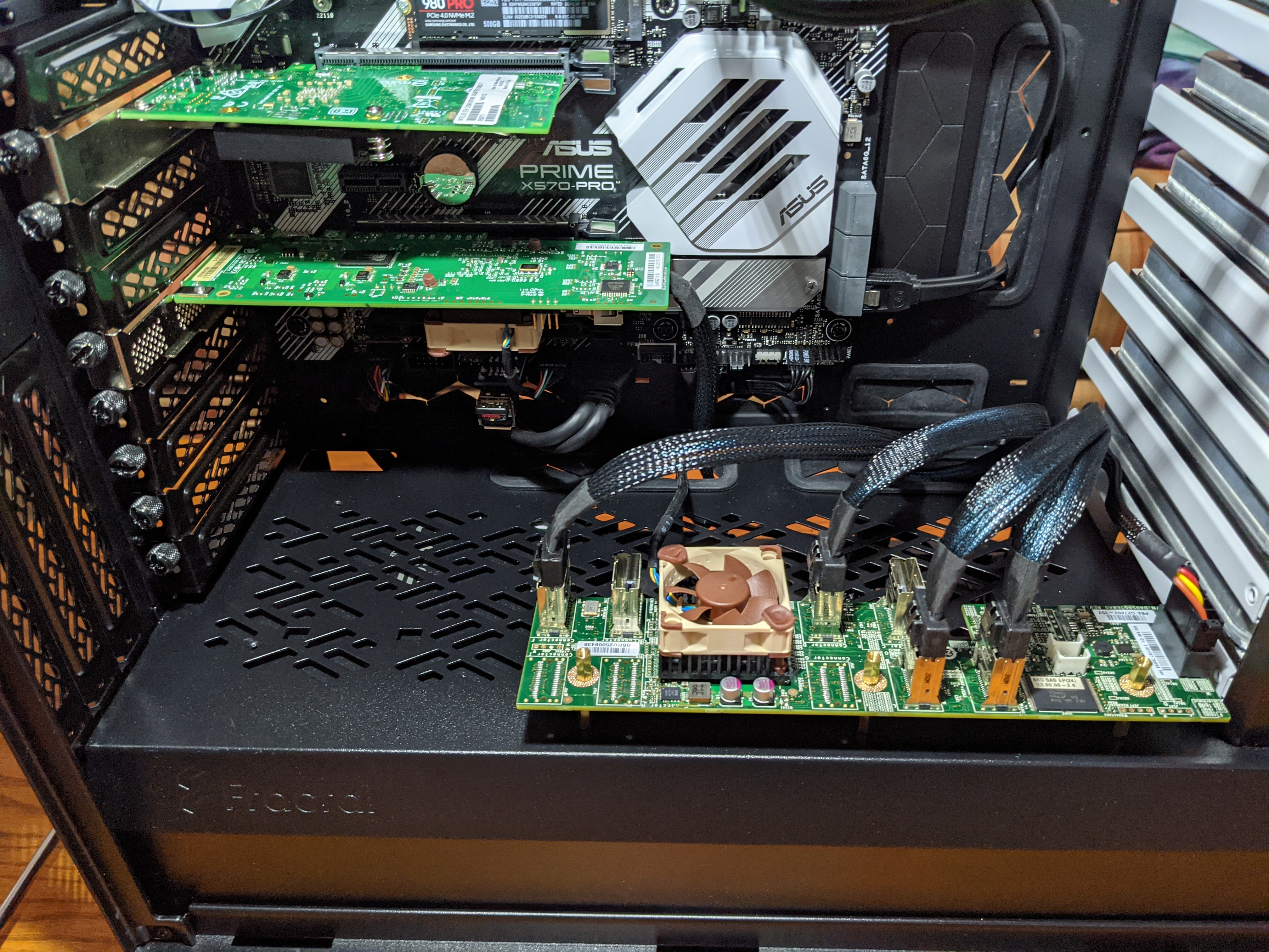

June 23, 20215 yr Author Pic of the 40mm fan addition if anyone is interested. I just used the rubber things that Noctua includes, instead of going and buying screws. It works perfectly but takes a bit of force. Edited June 23, 20215 yr by stev067
June 23, 20215 yr 1 hour ago, stev067 said: Pic of the 40mm fan addition if anyone is interested. I just used the rubber things that Noctua includes, instead of going and buying screws. It works perfectly but takes a bit of force. Nice work, might have to copy that idea 😛 Finally got mine yesterday. You should be able to add some bandwidth (will help for parity checks) by dual linking your HBA, see below On 9/21/2015 at 10:47 PM, JorgeB said: Intel® RAID SAS2 Expander RES2SV240 - 10w Single Link with Dell H310 (2400MB/s) 8 x 275MB/s 12 x 185MB/s 16 x 140MB/s (112MB/s*) 20 x 110MB/s (92MB/s*) * Avoid using slower linking speed disks with expanders, as it will bring total speed down, in this example 4 of the SSDs were SATA2, instead of all SATA3. Dual Link with Dell H310 (4000MB/s) 12 x 205MB/s 16 x 155MB/s (185MB/s*) * Two different boards had consistently different results, will need to test a third one to see what's normal, 155MB/s is the max on a Supermicro X9SCM-F, 185MB/s on Asrock B150M-Pro4S.
