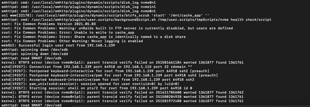

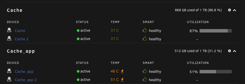

All appeared ok, but then I notice Fix Common Problems is flagging an issue "Unable to write to cache_app" "Drive mounted read-only or completely full. Begin Investigation Here - in this ccse it is rad-only, not completely full issue, as shown on the main dashboard (which shows the utilisation exactly as I recall it before all the issues started):

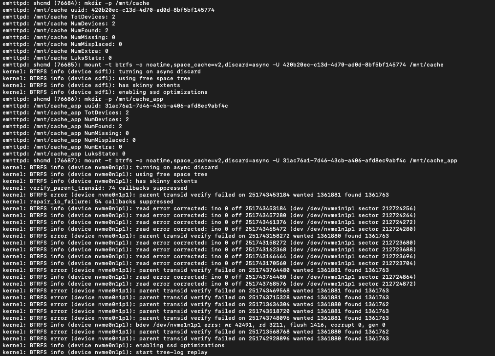

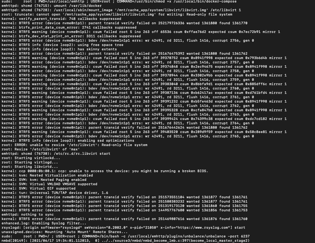

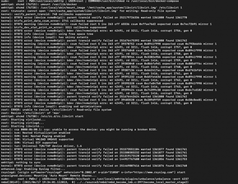

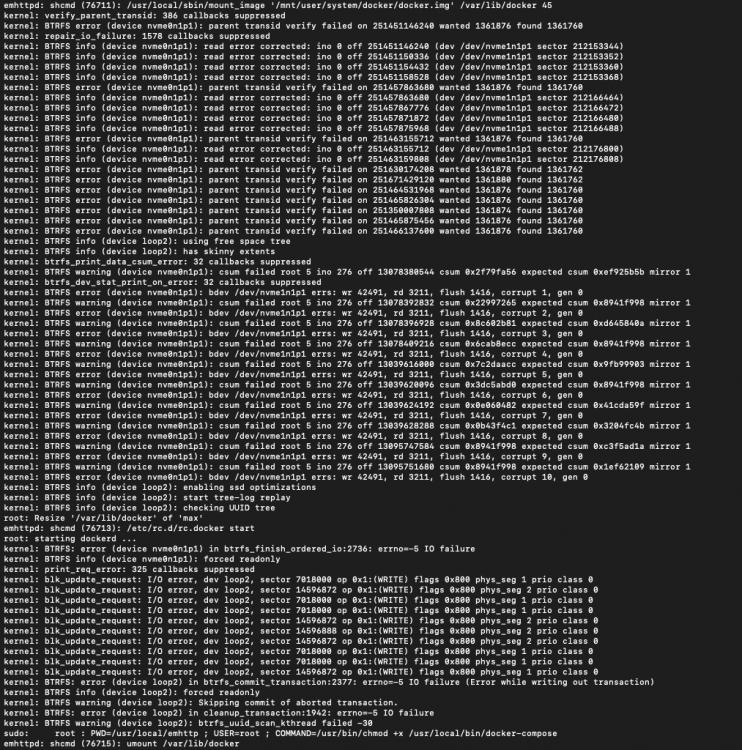

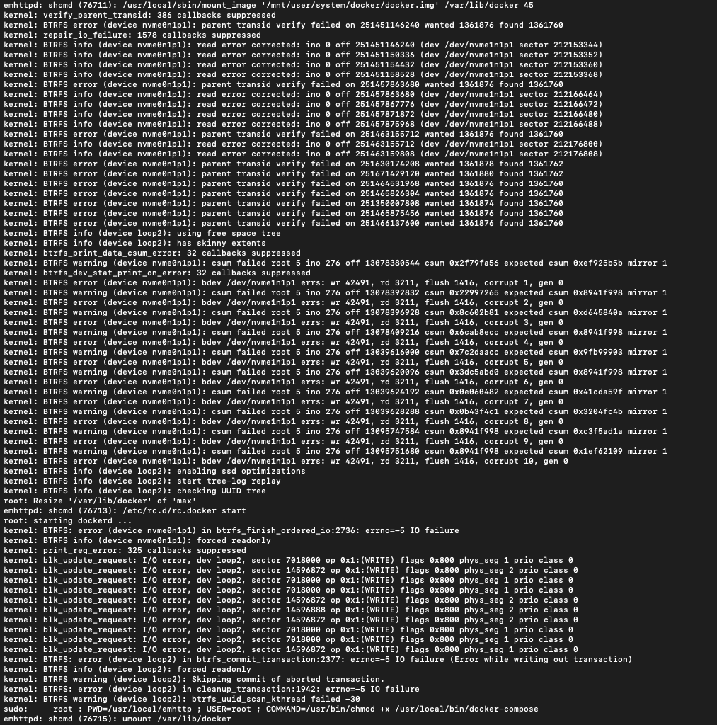

Checking the syslog shows the pain:
So my question is, where do I go from here?

Log doesn't cover it but those errors suggest one of the NVMe devices dropped offline at some point in the past, see here for better pool monitoring for the future.
As for the current issue, reboot then immediately run a scrub to see if it can bring the other device up to date, if the fs goes read only again best bet is to backup and reformat.

I've already rebooted any it stays in RO mode. I've tied to copy the whole FS of the content to another drive ahead of reformatting, and whilst many thousands of files copy cleanly, I am seeing a lot of others with errors
cp: error reading 'foobar.file': Input/output error
These suggest there's data corruption, but would need to see diags to confirm, if that's true you could use btrfs restore, though files will still be corrupt, but it's likely your best option.
