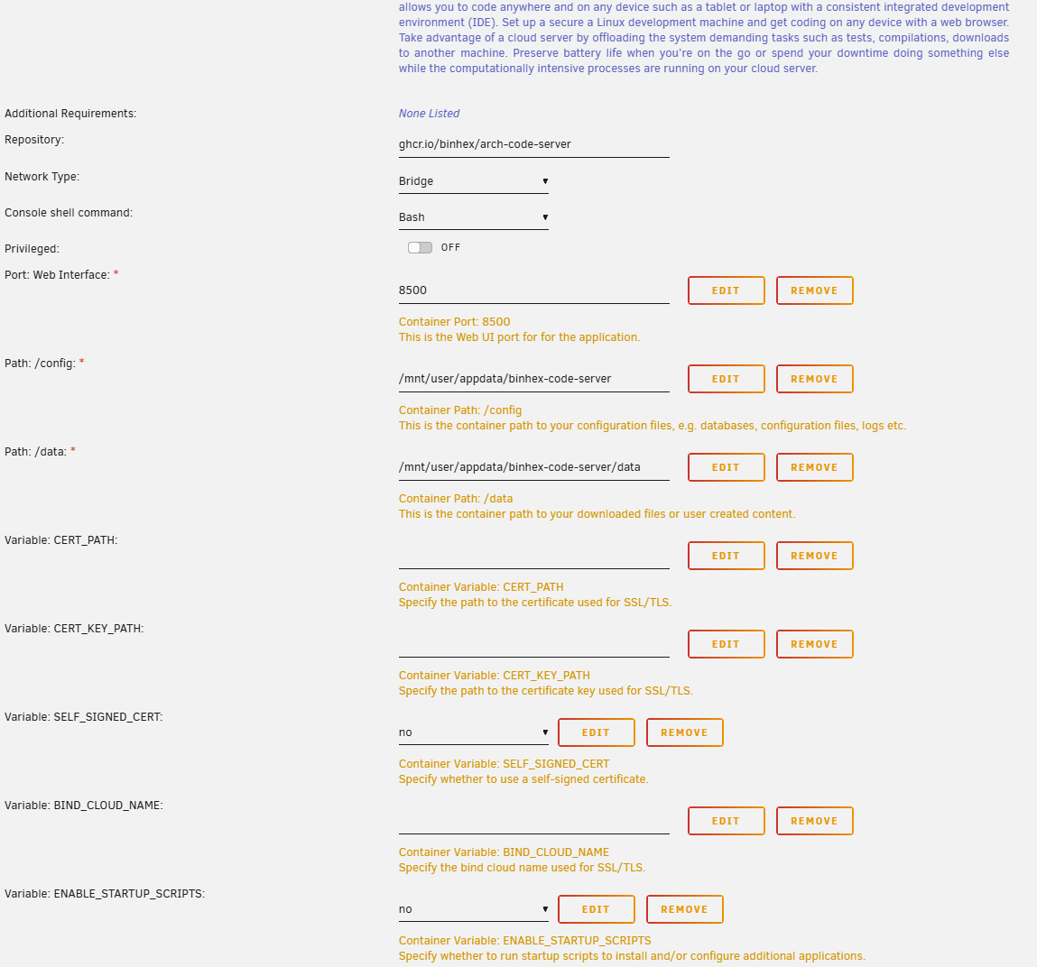

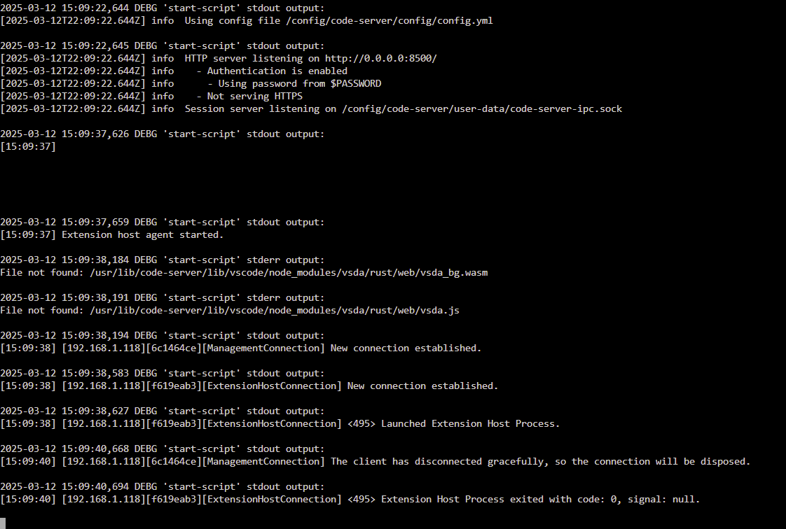

I'm trying to setup the code-server with nginx-proxy-manager but I'm having issues. I have set the crt and key values in docker to be blank and set self-signed to no and can access code-server locally. Once I forward in npm it states SSL Handshake Failed Error 525.
I'm using the CloudFlare certificates on all my other services that are running through NPM. I'm only having issues on code-server
Edited by Michaelclaw
added ping
if it works locally then the issue is not with the container, i would advise asking on the support thread for nginx proxy manager.
