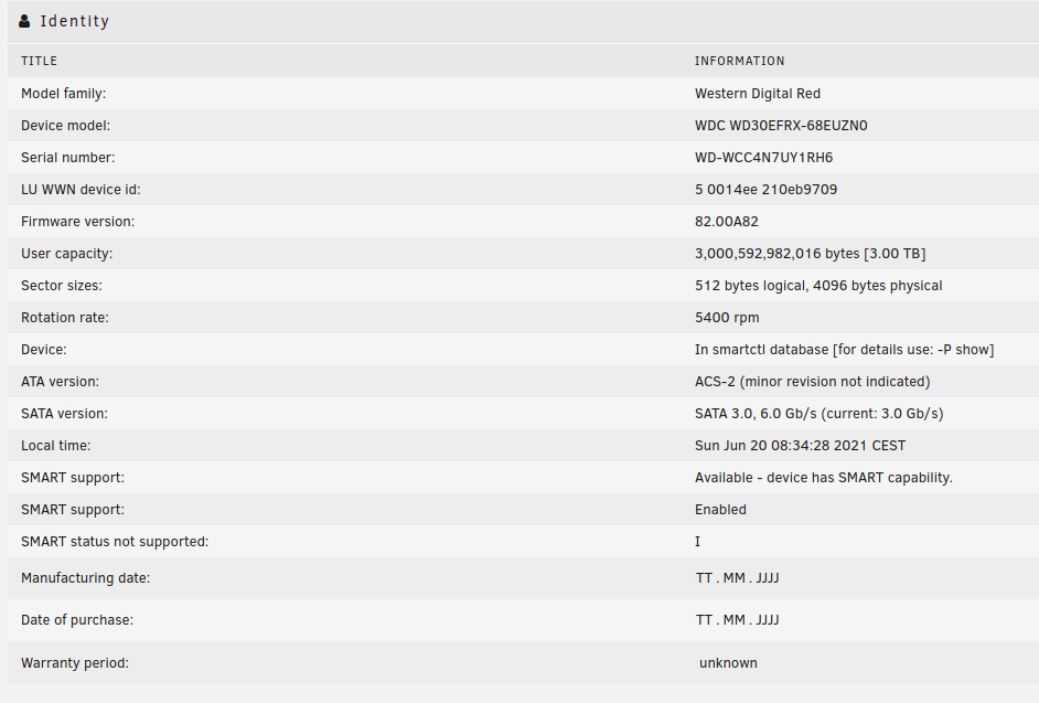

about those usb hard disk docks with the multiple bays... how do they actually work with unraid?
is unraid able to detect each disk individually? is unraid able to correctly detect the individual disk serial numbers?
just curious.
In my case I had no problems with the dock, all disks are individually detected and all information like the serial number are detected also correctly. Attached you can find an example.
