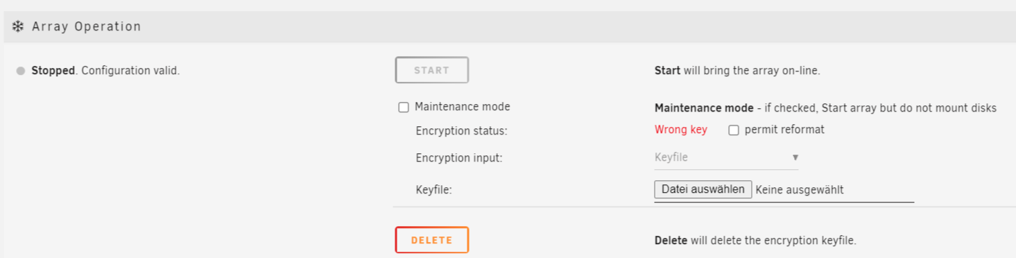

Hello! I hope someone can help me with this. For the last year, my unraid server autostarted the encrypted array automatically by downloading the keyfile from FTP. I used the guide from @SpaceInvaderOne, and it worked well until yesterday. Yesterday the array did not start and showed up the message "wrong key" (Screenshot)

Unfortunately, I have no idea what went wrong since I did not change anything. I checked the keyfile: With every reboot the keyfile will be correctly downloaded to /root/keyfile as in the guide. I also did not change the password. The password has 11 Characters and only letters and numbers. No special characters. It is very strange because I didn't change anything and the file is in /root.
Any ideas on this? Help would be very nice! 🙂

16 hours ago, Squid said:
Put the wget and sleep in before the emhttp line?
OMG! That was it! Thank you @Squid😀
I placed the:
# Start the Management Utility
/usr/local/sbin/emhttp &
At the end of the go file and removed the iGPU part because I use the Intel GPU TOP Plugin anyway.
Still no idea why it worked so long in the original sequence, but its solved!
