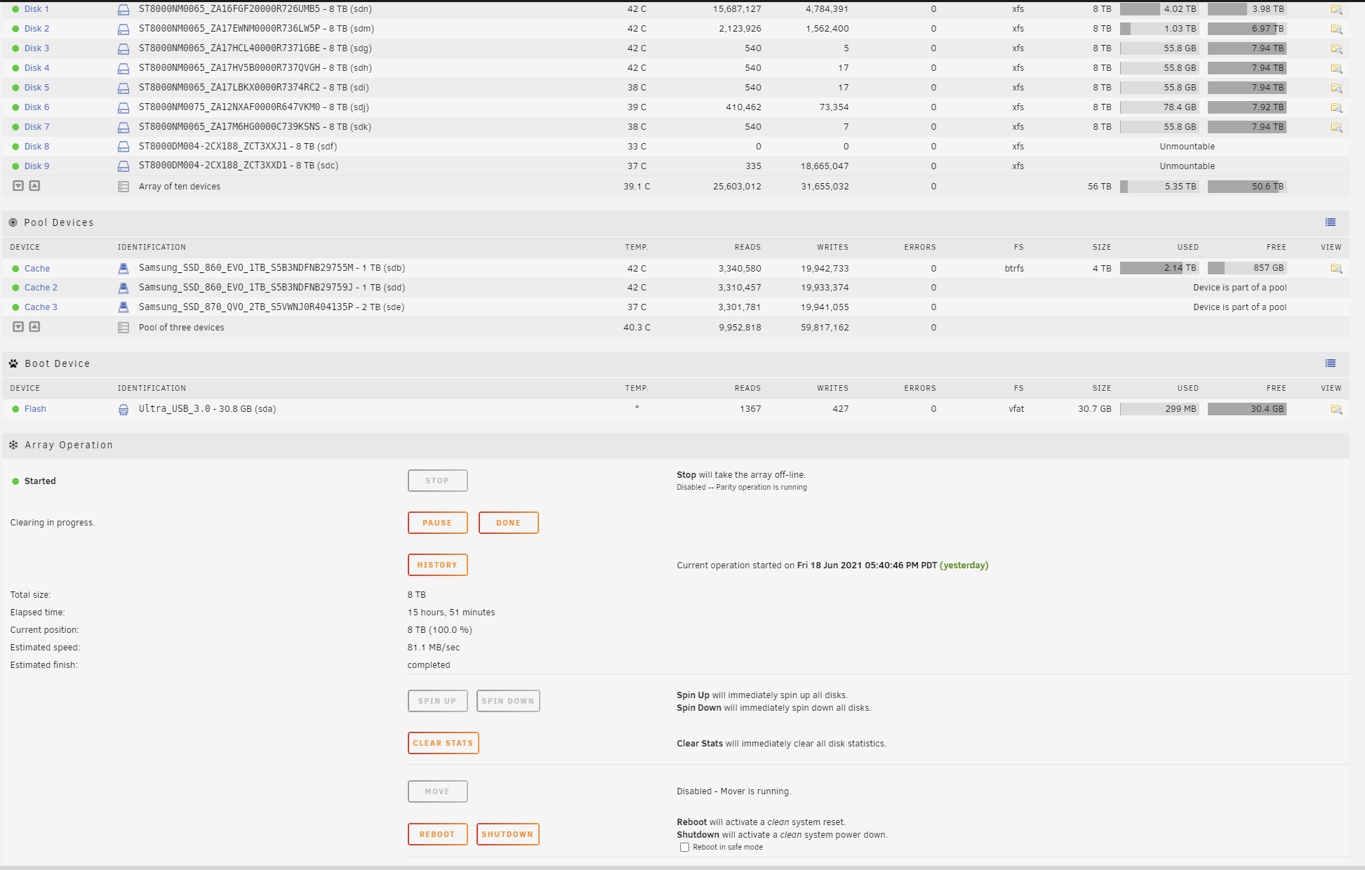

So I've just added a 2TB SSD and 2x8TB HDD. The HDD are now formatted and fine. My question is what's going on with the SSD? I've just setup Radarr and Sonarr so hitting it hard for now to get my database setup. The SSDs show correctly the 4TB however they appear to only have 3TB usable. What do I need to do to get my other 1TB back?

Each share has a setting to determine where files will initially be placed and whether the mover will change their location. Your screenshot shows mover to already be running, so shares set to cache : yes will be moving from the cache pool to the array.
My pool has been operating in raid 0 prior to adding the drive. I'm seeing 3TB usable so even if it defaulted back to raid 1 wouldn't I only see 2TB?  Thank you for the quick response!

3TB is the correct answer for your configuration:
https://carfax.org.uk/btrfs-usage/
You would need to use Single mode to get full capacity from different sized disks:
I would have thought the correct answer is 2TB  for RAID1 profile, and the 3TB is the known issue of BTRFS reporting incorrectly with an odd number of drives?

3TB is RAID0, where each chunk of data is striped across all devices for speed. I forgot that tidbit when I initially replied.
The odd number of drives thing makes BTRFS RAID levels rather unpredictable with usual logic, which is probably why free space calculation is hard in that config.
IIRC raid0 with an odd number of equal size drives reports space correctly, problem here is likely the different size drives, but the free space will be less wrong as the pool gets filled, and you can use the full space, which as mentioned is 3TB in this case.
