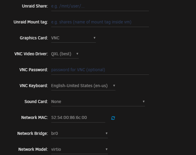

I have pfSense VM connected to Unraid's br0 via virtio (VNET0) on the same interface I have VLAN setup with id 150, which I intend to use with docker and VMs on Unraid.

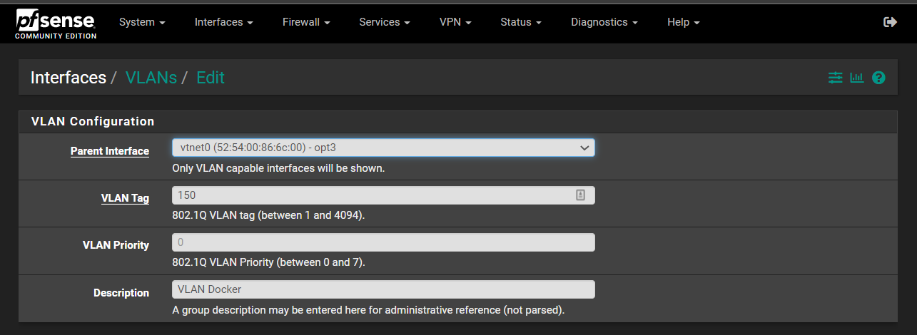

Setings within pfSense:

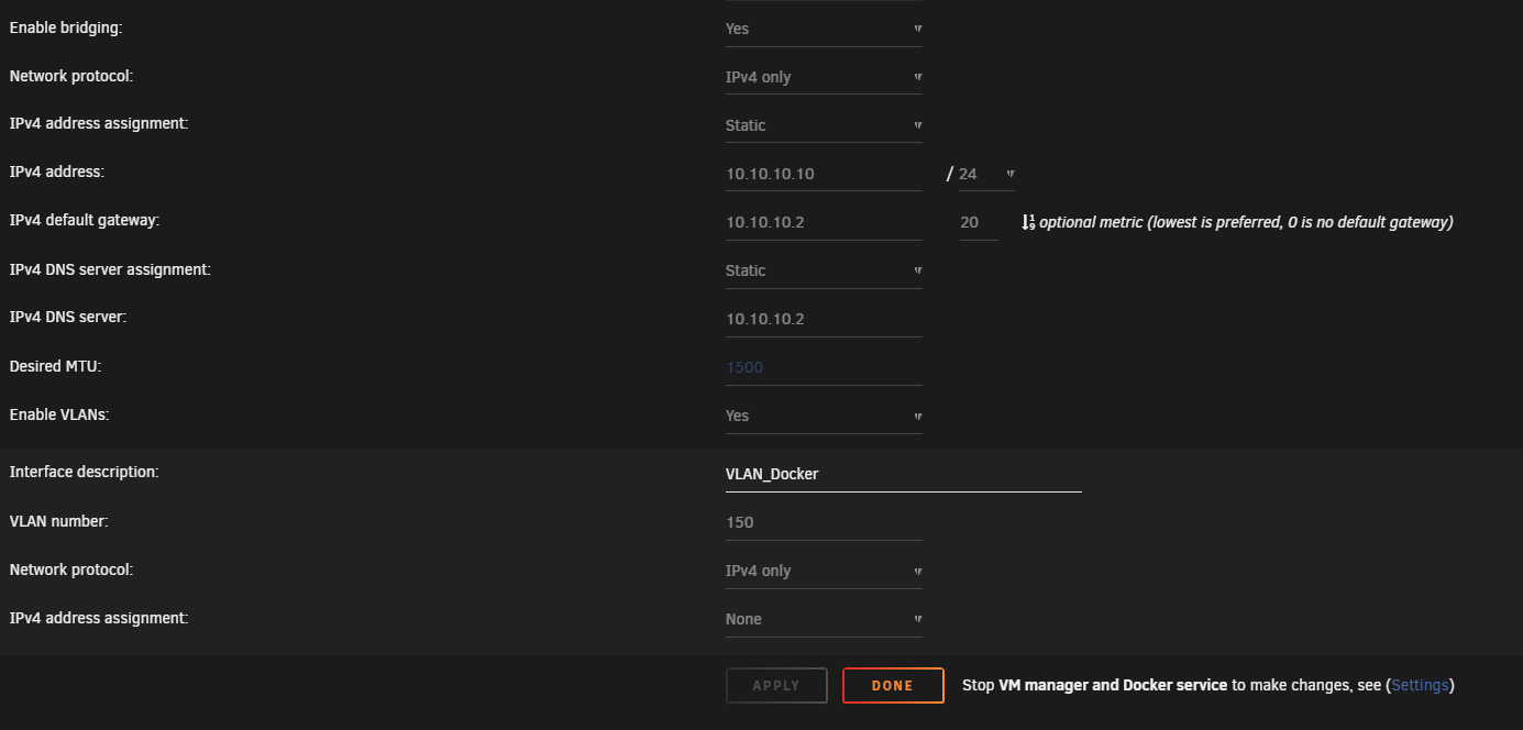

Unraid network setup:
But whenever I connect VMs / Docker container to bridge br0.150, they become isolated from all other networks.

I noticed, that you did not set an IP to the br0.150

1 virtio passed to pfSense which connects to br0.
I want this virtio to handle vlan traffic for docker container, as I want to allow only selected local user to connect to docker, but all can connect to unraid

Your screenshot just shows, that you defined the VLAN tag as part of the base interface virtio/opt3.
in order to use the traffic separately, IMHO you need to add the VLAN to the list of interfaces on the pfsense bridge as well, so you will have an "opt4" in addition to opt3/virtio.

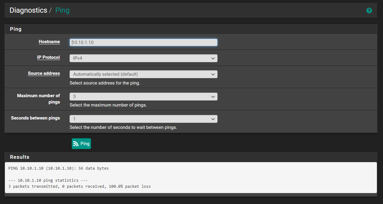

I can ping unraid from pfSense on br0,
But cannot ping on Vlan/br0.150

try to do one step at a time. My guess is, that your pfsense is missing the interface for vlan-150 and unraid is missing this as gateway.
You only showed one screen where you only defined the tag, but no interface and network using it.
consider the network at br0 as the untagged/default PVID net....this is working
create the same setup for VLAN-150...mimik the setup from br0

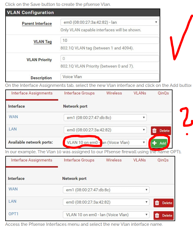

In order to use IP packets from VLAN 150 (unraid br.150 via br0 trunk) you need to *add* another VLAN *interface*
See: https://techexpert.tips/pfsense/pfsense-vlan-configuration/
...what I gather from your screenshots, you only did the first step, not the second (and third, whjich is adding an IP to the VLAN 150 Interface in PFSense and defining the IP network used over VLAN 150).
Now, did you try all these steps or did you just perform the first?

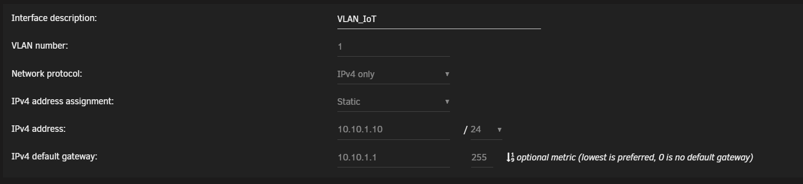

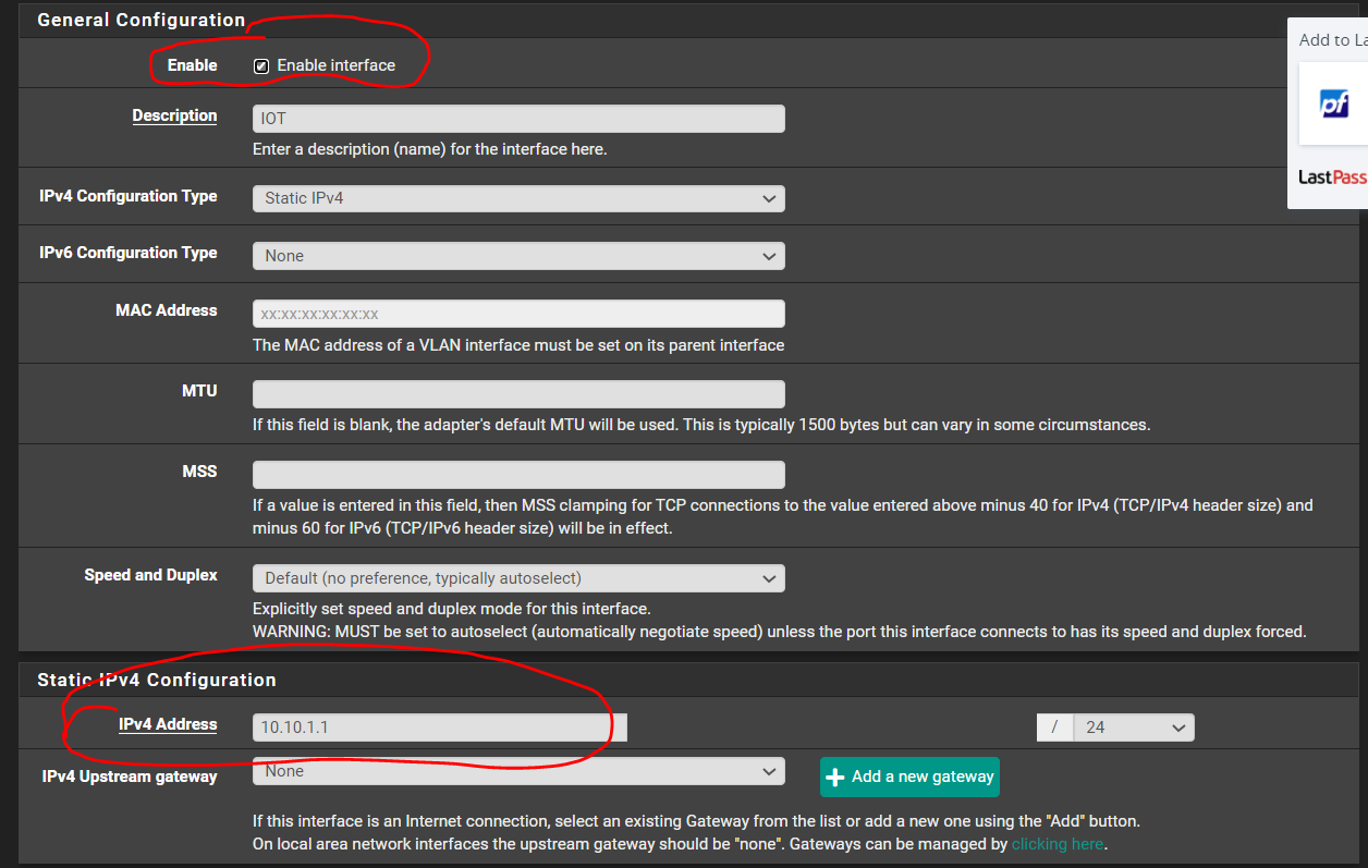

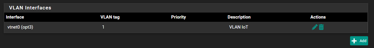

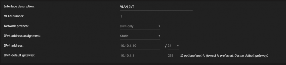

I have followed all the 3 steps. I have independent networks created for each VLAN, with their own Static IPv4 and DHCP
Here are the screenshots for VLAN 1
Unraid settings:
pfSense pings:

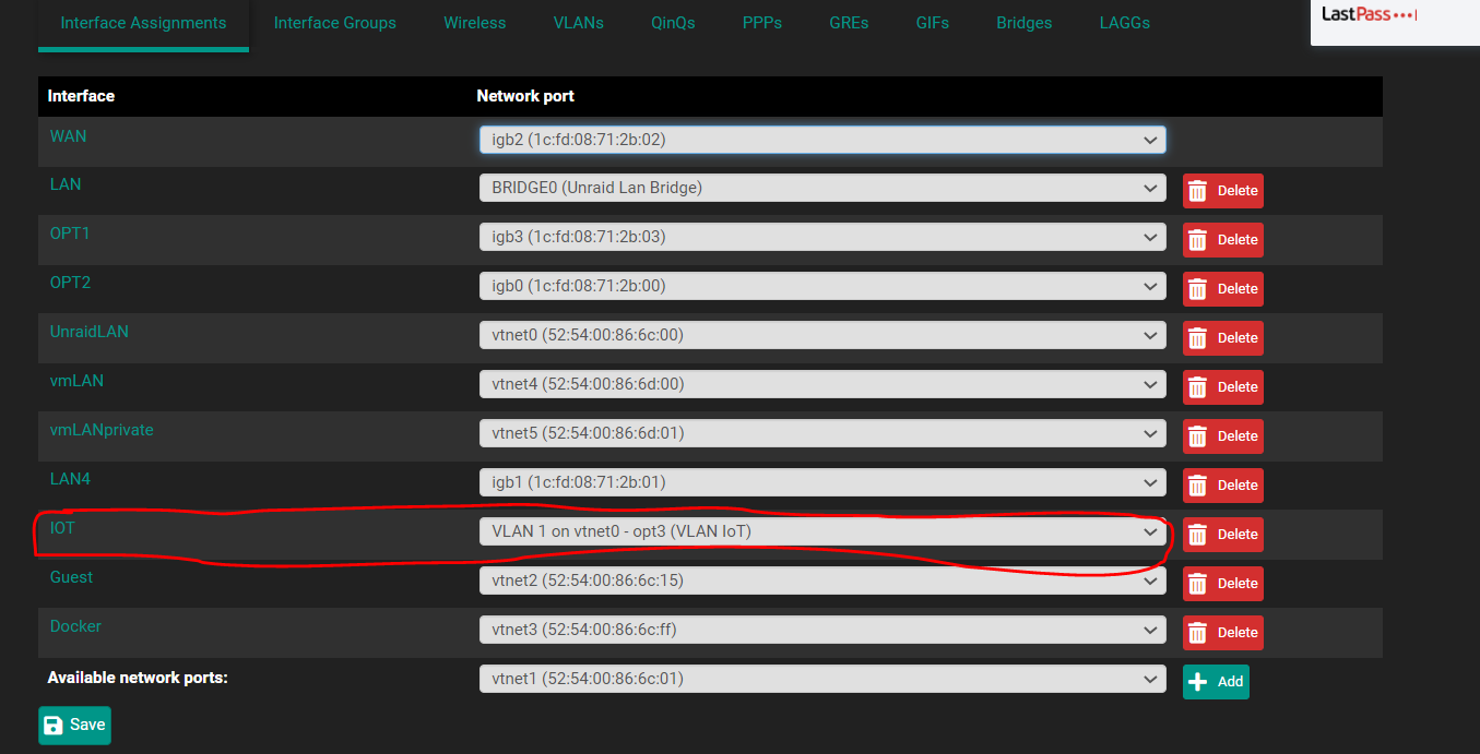

....you added VLAN-ID = 1 but did not add ID=150, which you originally indented.
instead you added vtnet3 (virtio/br.150 I guess)
This scenario works, you said or does it not.
However, what you wanted and "we" are talking about here, is to use a trunk (on vtnet0/br0)
VLAN 1 is - as far as i know - the default accross all  network components, when untagged traffic arrives/ingress.
I'd try to not use it explicitly unless you know what you are doing.

by the looks you have completed the steps, but did this for VLAN1 but not 150.
But I can only go be the pics compared to that other howto I linked...as said, I do not use pfsense and by the looks of it, the concept is completely different from that of a linux bridge.
Maybe you should get rid of vtnet3 and recreate it as VLAN150 on vtnet0 then.

was working on VLAN id  1 right now for test, now I switched to VLAN id 15
Everything is configured for vlan 15, as well as unraid
Am also testing vms on br0.15 now
unraid on br0 is 10.10.10.10
unraid on br0.15 is 10.10.15.1
Vlan 15 is have opt3 as parent interface, which connects to br0
Tried pinging 10.10.15.10 (Unraid on br0.15), but failed

.what do you mean by "...would be untagged and moved to own switch"
Am epecting br0 (virtual bridge within Unraid) to be a VLAN enabled bridge which can move tagged messages in to their respective VLANs
...unraid is on 10.10.10.10 (br0) and on br.15 it is 10.10.15.1 or is it 10.10.15.10 ??
...OK, and you did set pfsense 10.10.10.1 (opt3) and 10.10.15.1 (vlan15) IPs and  as gateway for each network (10.10.10.0/24 and 10.10.15.0/24) in unraid on the respective interfaces?
Yes, this is what unraid br0 with enabled VLANs does. I am using it just fine this way.
If you did set both sides up, I can only think of virtio.net as the cause.
As said earlier, for tests, you could physically connect unraid on-board NIC (br0) and physical NIC#4, that is passed through to your pfsense, with a patchcable...this will take virtio-nic out of the equation.
This kind of setup I used to run with a virtualised Mikrotik RouterOS (CHR) for years and it worked (no virtio) flawlessly.
I strongly do believe, that the problem still lies in pfsense and not virtio through, but I cannot help with pfsense better, as I already said. I am sorry.
