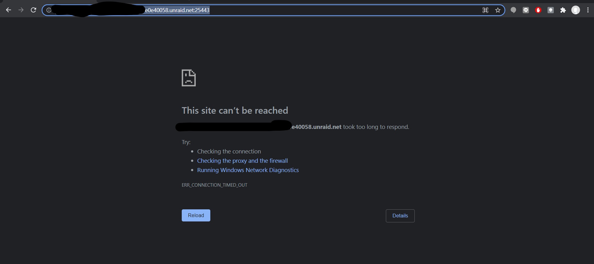

Dashboard ERR_CONNECTION_REFUSED . How can I fix this?
Hello. Yes the port is correct! I can access the server using putty and WinSCP. I can access the content on the drives, because the samba protocol is working, plex is working fine, delugevpn is working, homeassist. The only thing I can't access is the web interface from my network, to login as root.  The only problem i have now is whit nextcloud, where o get a 400 Bad Request
Have you tried https://<IP Address>?
Note the https and use the IP that is working for putty.
Yes i've tried https://ip address and https://ip address:port number
