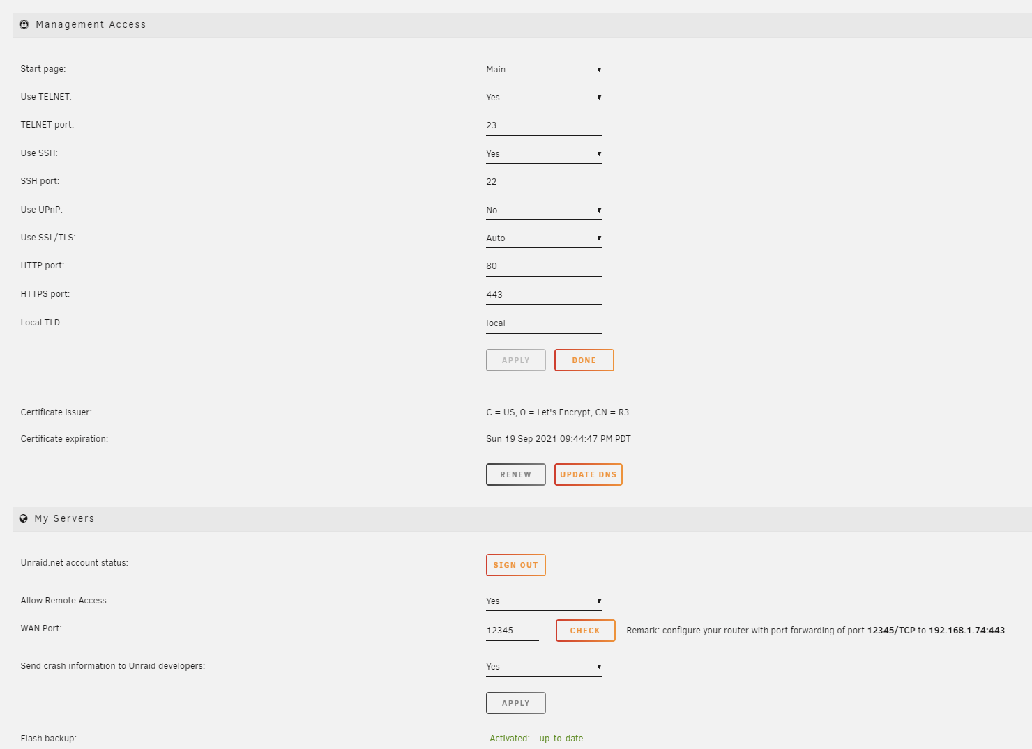

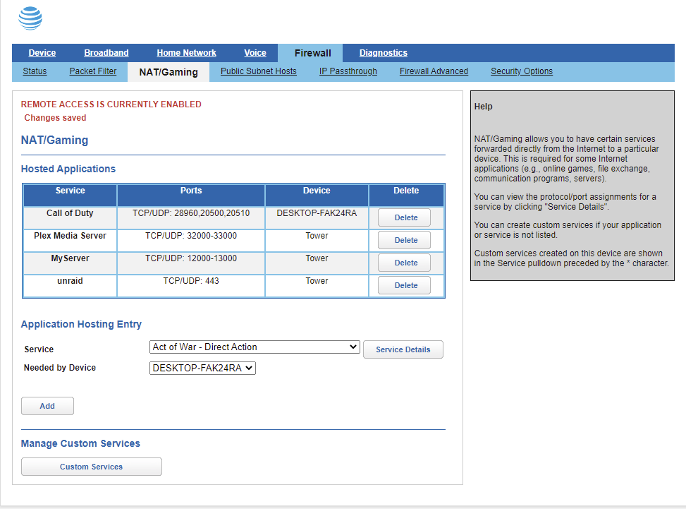

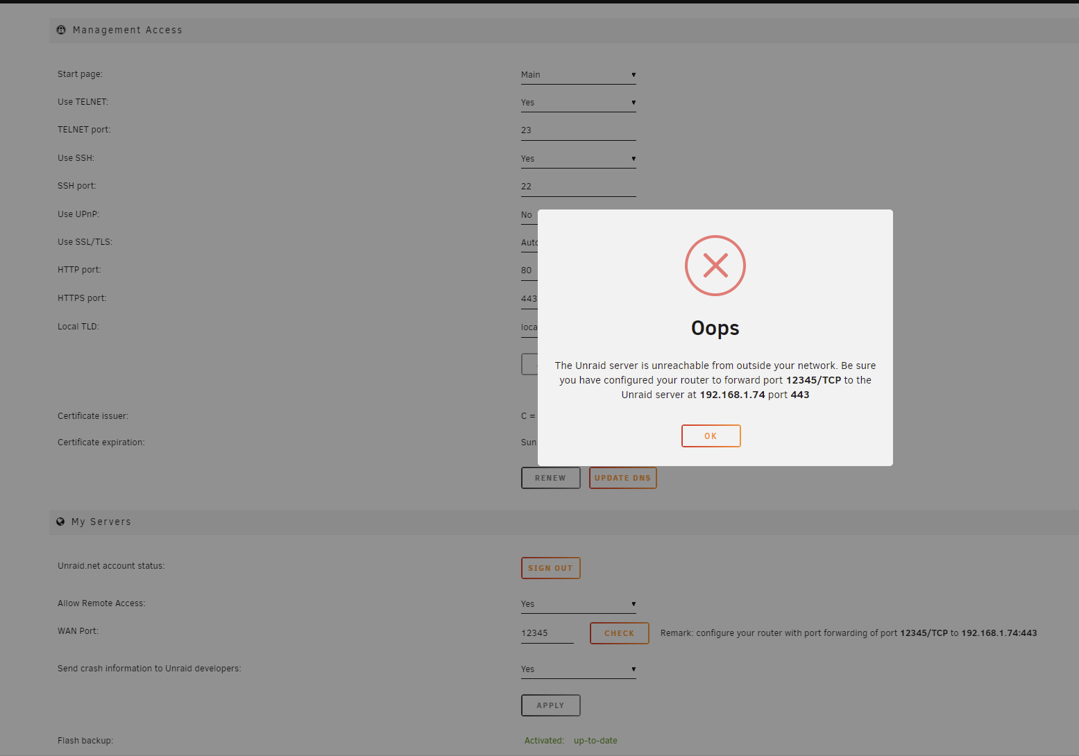

So I'm trying to get My Server going and it told me to select a different port than 443. I did 12345. It wouldn't connect and neither does 443. I know unraid doesn't have a firewall and I'm not a network admin by any means but I did go to the router and have it open the ports that I've set to forward. What info can I get to you to help me resolve this issue?

From the screenshots you've attached, you have set WAN port 12345 in UnRAID, while port 443 is forwarded on your router.
Are you sure that you chose the same ports on both devices at the same time?
EDIT:
I just saw that you forwarded the whole range from 12000-13000. Maybe try just forwarding the single port, and not the whole range.
Plus: Don't expose unRAID itself directly to the internet, I would strongly recommend to remove the 443 port forward.
