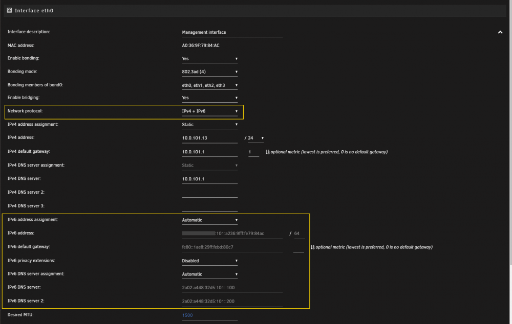

First: make sure under network settings both IPv4 and IPv6 is enabled. The preference is to use automatic IPv6 assignment, using either DHCP or SLAAC. Your router must be properly configured to hand-out an IPv6 address and associated DNS server address(es).

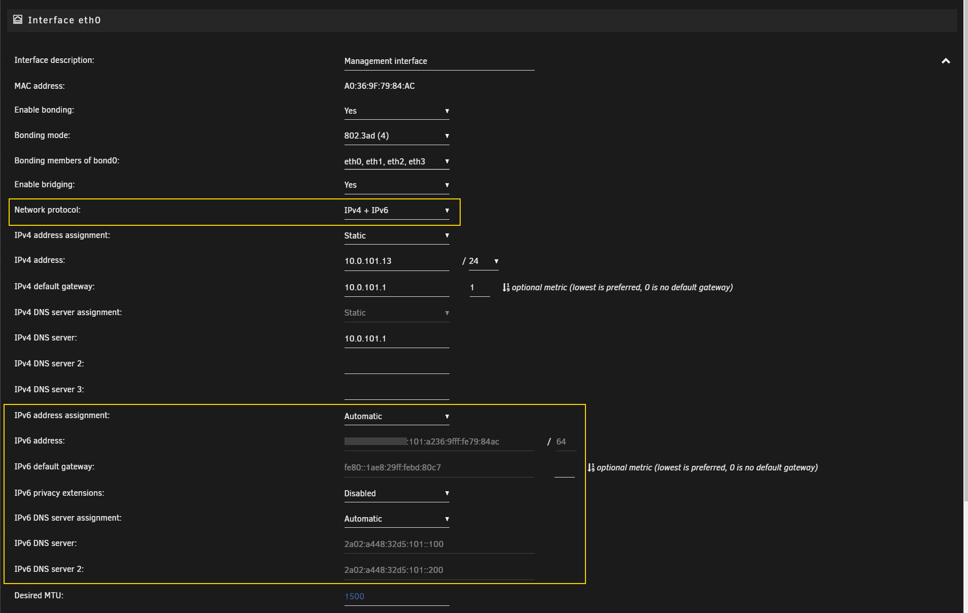

Second: Under Docker settings enable the necessary br0 networks for both IPv4 and IPv6
Note:
- Configure a DHCP pool for IPv4 which hands out IPv4 addresses to containers and does NOT clash with the DHCP range of your router.
- Leave the DHCP pool for IPv6 disabled, docker uses an assignment which won't clash with your router

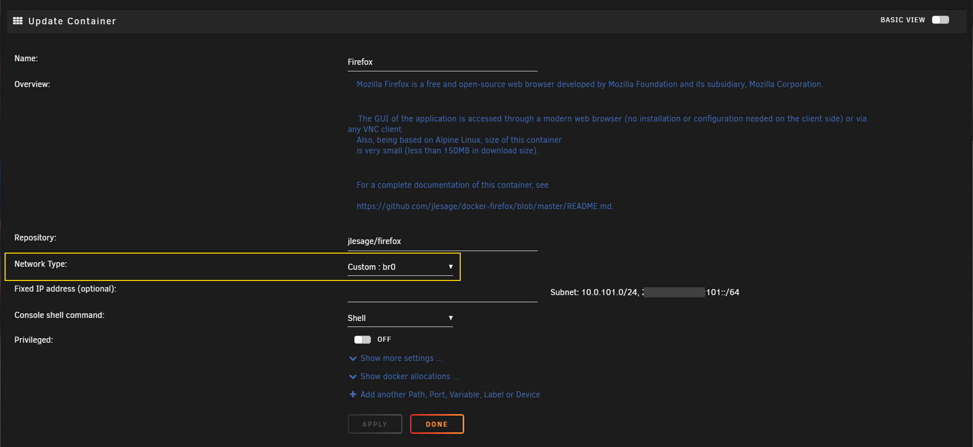

Configure a docker container to use custom network br0. The example below shows the Firefox application.

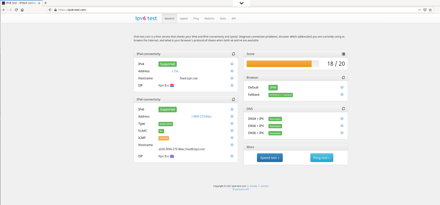

Since Firefox is a browser, it can be used to access the Internet on both IPv4 and IPv6 and we can test connectivity... Use ipv6-test.com
Note: Certain traffic in my network is inhibited due to the firewall rules I have created on my router (out of scope for this tutorial).
