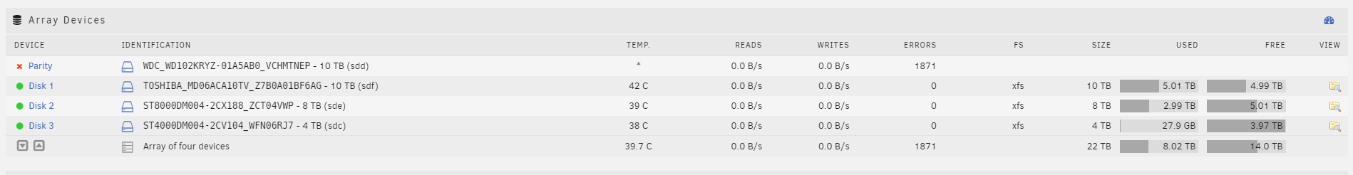

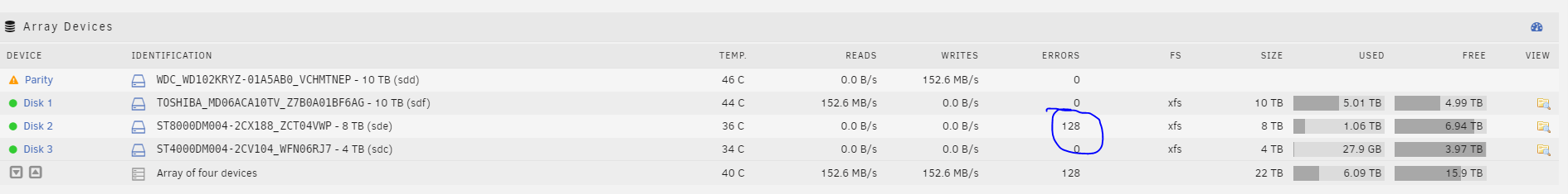

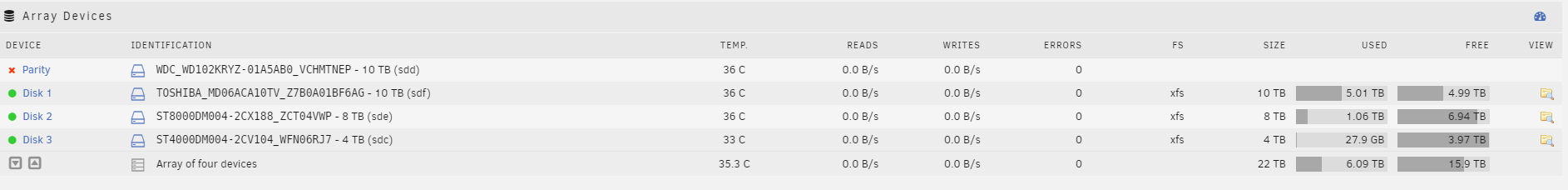

while rebuilding the parity i got another disk error can suggest if i have to change it or have some troubleshooting to do.image.thumb.png.4ad5521d3b372c30eb5a174315daf221.png
jarvis-smart-20210624-2215.zip
Disk2 is failing, copy whatever you can manually or using ddrescue and then rebuild parity with a new disk.

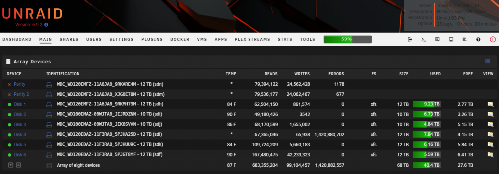

Thanks! I do have dual parity. Both were disabled and one of the array drives was the one with read/write errors, but it was not disabled. It was just doing a read-check like you said, and I didn't realize that. I troubleshooted as suggested: swapped some cables and rebooted, the array drive reconnected, then I emptied, restarted the array, and reassigned the parity drives. It's doing a parity rebuild now. Hopefully we'll be back in business in... 2 days and 3 hours.

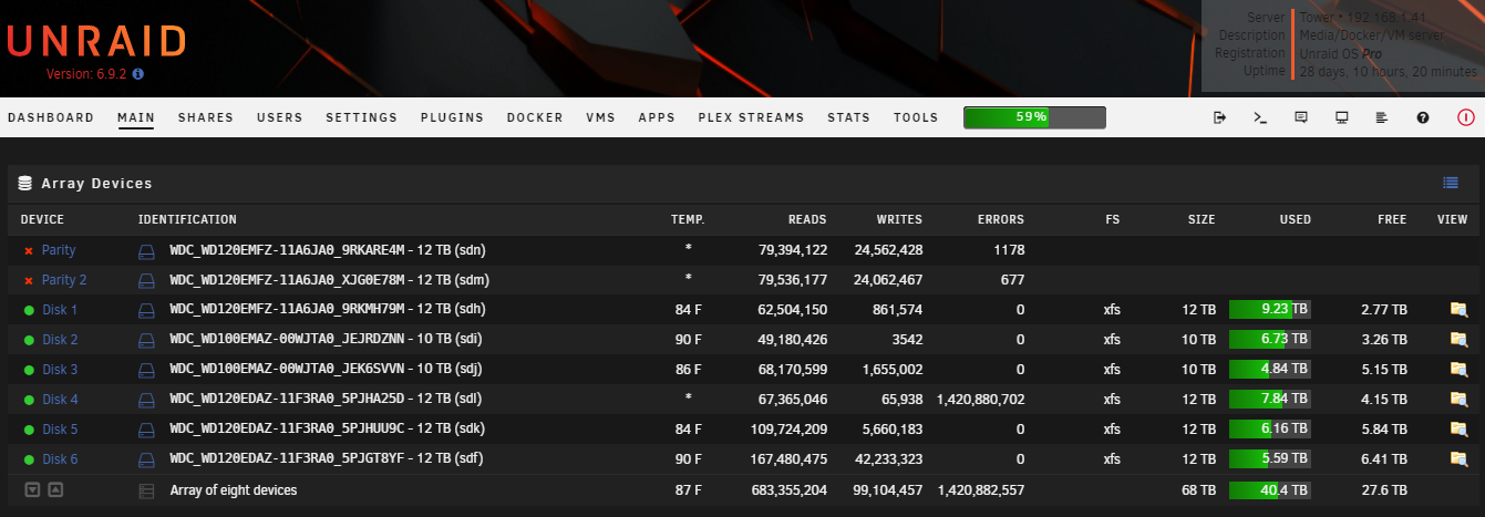

That screenshot is showing a lot of errors :) was it taken before you started the parity rebuild as if not then you still have a problem to solve.

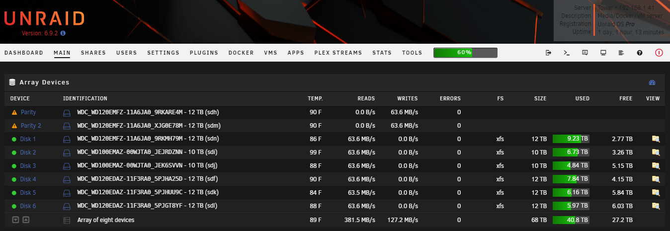

Yeah, you can't do parity rebuild when they're disabled (red Xs). It started a read-check and obv every sector was a no go on disk4. But what was weird was it still had a green dot and said normal operational/active. I didn't know what was going on. It apparently just had a wonky cable connection develop. Everything seems to be working now.
This last screenshot looks like what I would expect to see with a parity rebuild that is proceeding satisfactorily :)

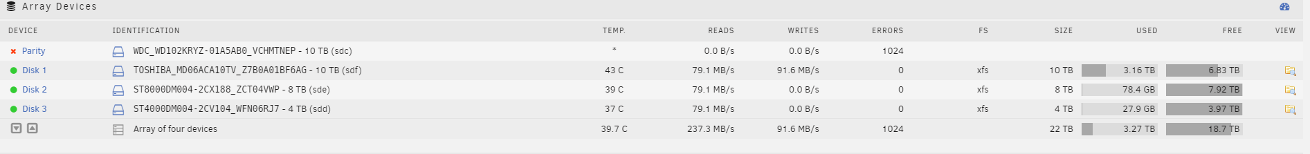

1 hour ago, EduAid said:
Hello the disk again failed
Parity dropped offline, you're using a controller with SATA port multipliers that is known to drop disks, if you need an ad-don controller see here, but since you have so few disks why are you not using the Intel onboard ports (except for the SSD)?
