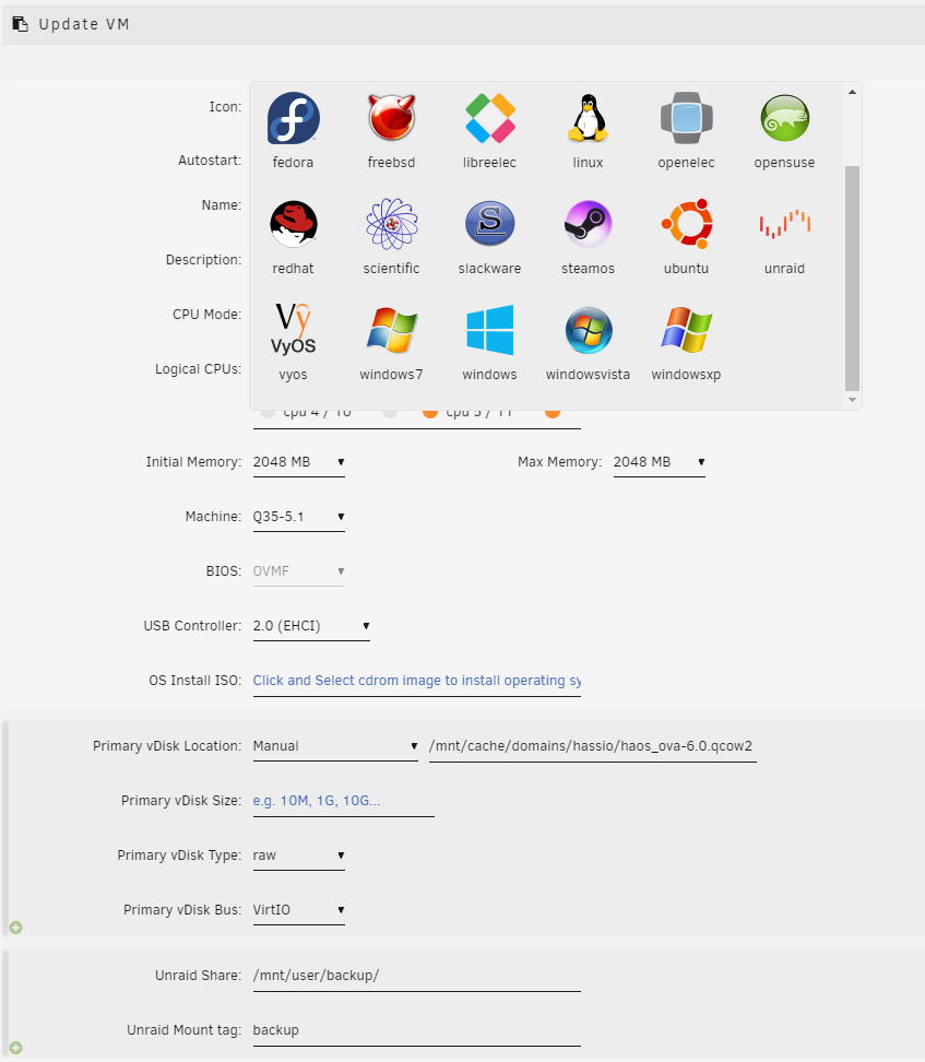

The WM is configured as depiced, but after mentioned reboot the folder is gone.
The strange thing is that my custome Icon for Hass.io is missin form the Icon list.
Aaccording to the file list of the hasos_ova-6.0 files on my server there is no file/folder in the correct folder with correct date.
The ova files found is for an older Hass.io i removed with date Jun 22 and the "iso" for hass.io.
The server was rebooted on the Jun 24 and there should be a folder named and a ova_qcow2 with the same date.
Could it be a file permission issue as I did copy create the folder and copied the ova_qcow in manually?

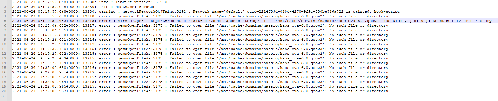

When i rebooted qemu reported this in the log file for my Hass.io WM aswell.
2021-06-24 05:19:54.452+0000: shutting down, reason=failed
Any thoughts of what happend?

The file doesn't exist. You are using a manually defined location, so did you ever create the file in the first place?
Yes, I was running the new WM for a day befor i had to do a reboot. Its really odd..
