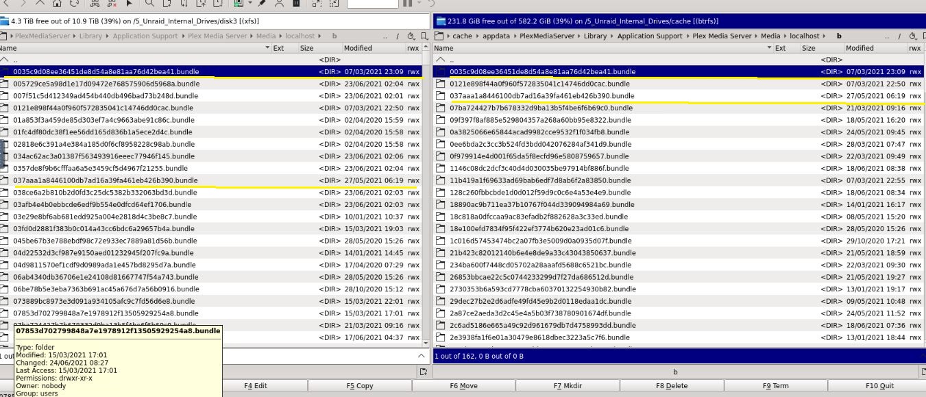

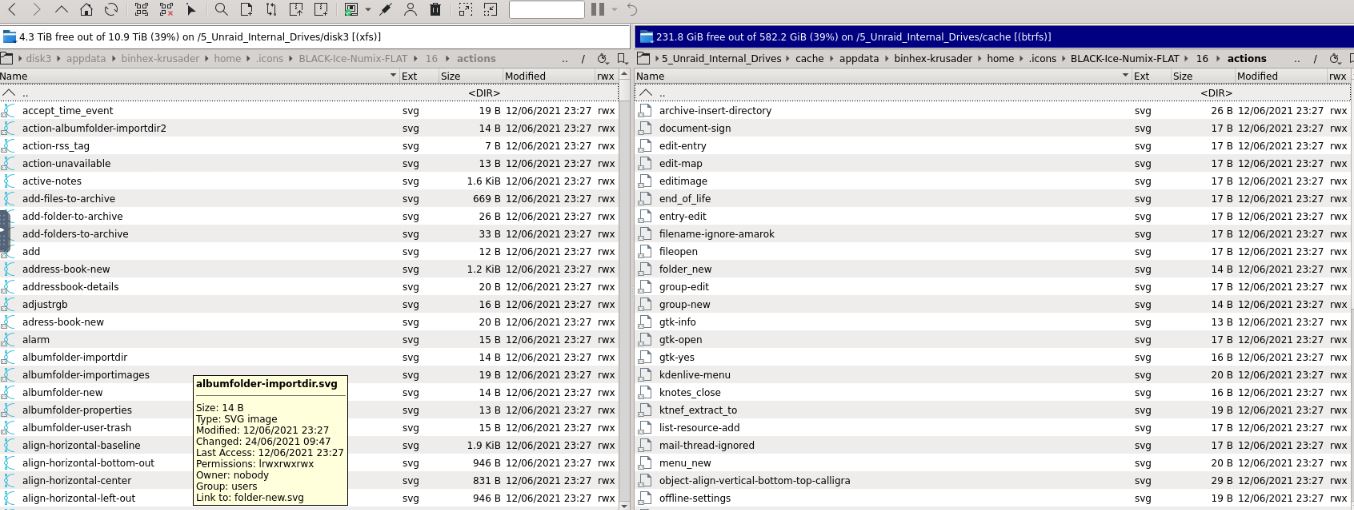

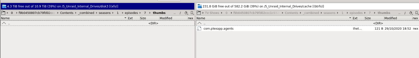

So I opened the Cache drive in Krusader and a 20-30 minute review shows that it's not moving over some of the files from some of the different docker containers. They're nothing that I understand, as most are either logs (in the case of Krusader) or subtitle files (in the case of Plex).
In the attached example below for Plex, the list of files on the left is what got moved over to Disk 3. While on the right, is what remains in the same directory on the cache drive that didn't get moved over. Am I able to determine anything from this? I'm not really familiar with Krusader, but does this mean that the mover just didn't move over duplicate files? I underlined in the image below two files that appear to be the same.

You are correct to say that the Mover doesn't move duplicate files. However the two items you highlighted are directories. You need to compare their contents in order to determine which is the newer version of each file, assuming that's what you want to do.
Gotcha. I looked through both again and found where the actual files are at.  I'd say going through Plex is going to be really tedious to do and doesn't seem like there'd be much upside, right?
Example: Plex folder on cache drive has file not in the same directory of Disk 3.Krusader_2.thumb.JPG.e017f6cee236d2a6bff660f0eefcd100.JPG
Example 2: Krusader folder on cache drive has different files not in the same directory of Disk 3.
