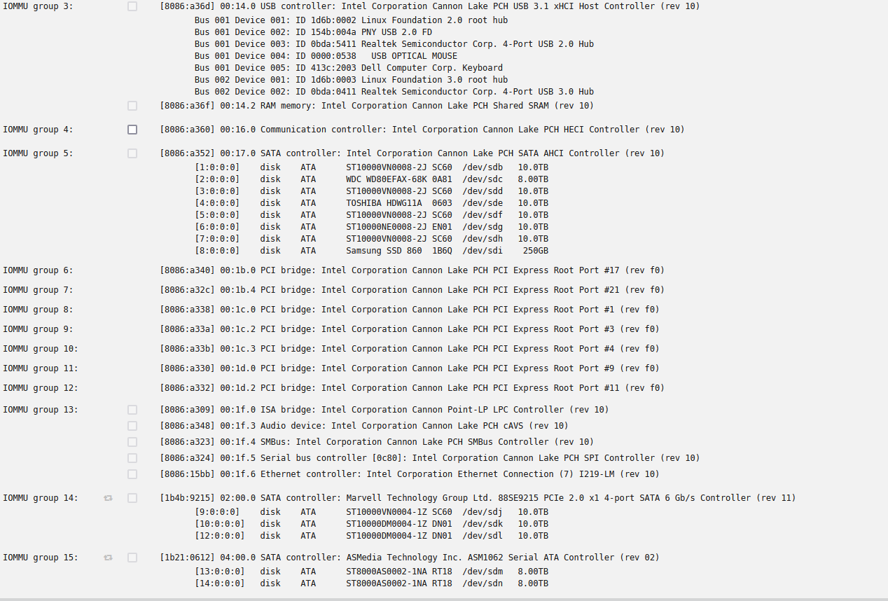

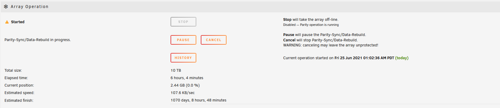

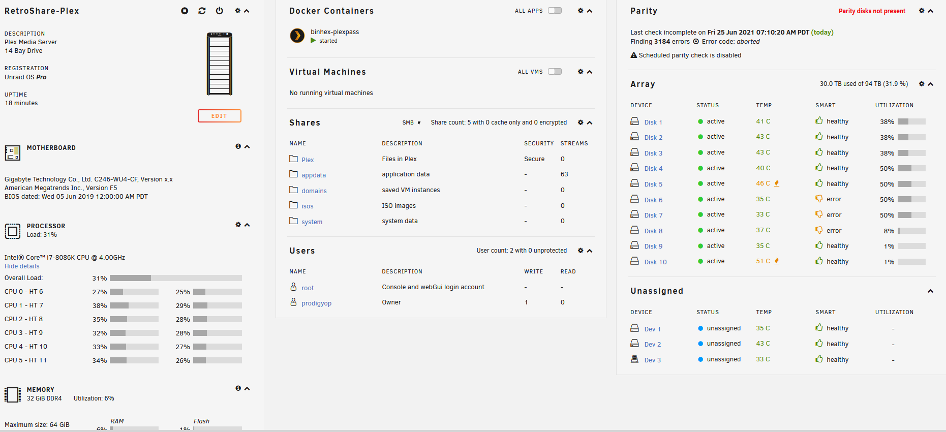

I recently setup Unraid and while setting up this Large Plex server I took some YouTube video lessons to prep it on unraid and so far I love it. Only thing and the most frustrating thing is this. When I finally got enough money to buy a parity drive I install it and add it to the slot but it says it'll take 1060 days or more to finalize (INSANE) and not only that it slows the whole system down and Plex is unplayable completely it would freeze randomly or not load at all. Is there something I am doing wrong, Anyone can give me some pointers or tips attached is my setup screenshots if more info needed please let me know and if possible where to obtain. I Took out the parity and Cache as for some reason adding it just slows everything down and make plex inaccessible.
