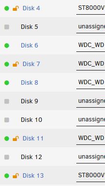

oh, and I noticed some disk in my array are encrypted and some are not. default option is set to encrypt since the begining of the server....

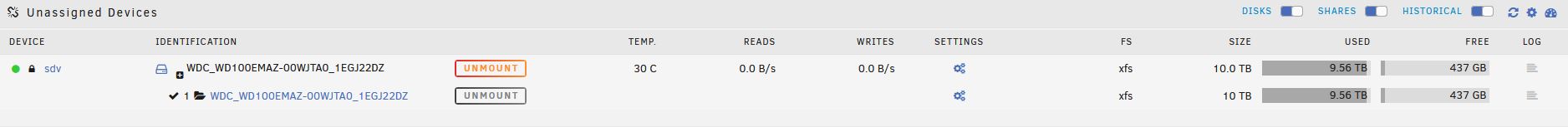

I don't understand my problem.
now, I have disk 2 disabled saying unmountable and disk 14 same thing but not disable.
disk have been tested smart and no issue found.
I've been searching and moving my hdd from the backplane to direct motherboard and still have some thing so it doesn't look like a hardware issue.
I've done a config reset again but disk come back up with same issue.
errors are being detected on many disk but nothing has been written to them since the startup of the issue.
nostromo-diagnostics-20210626-2250.zip
