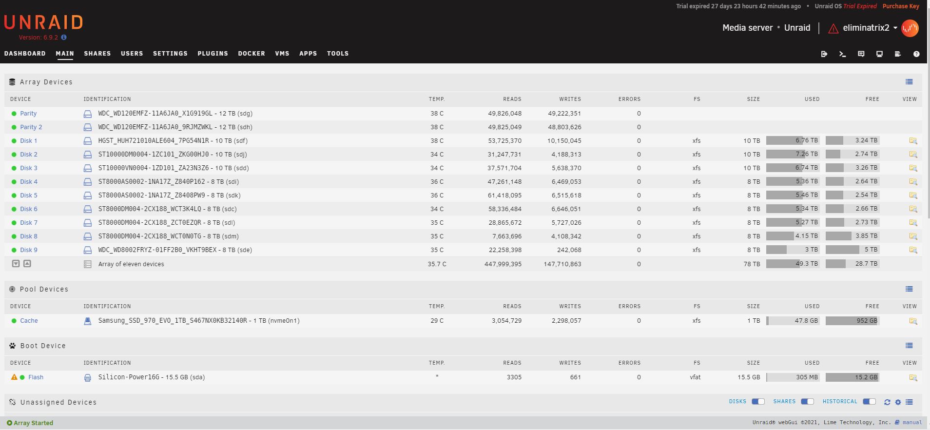

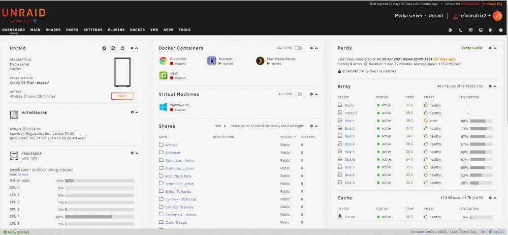

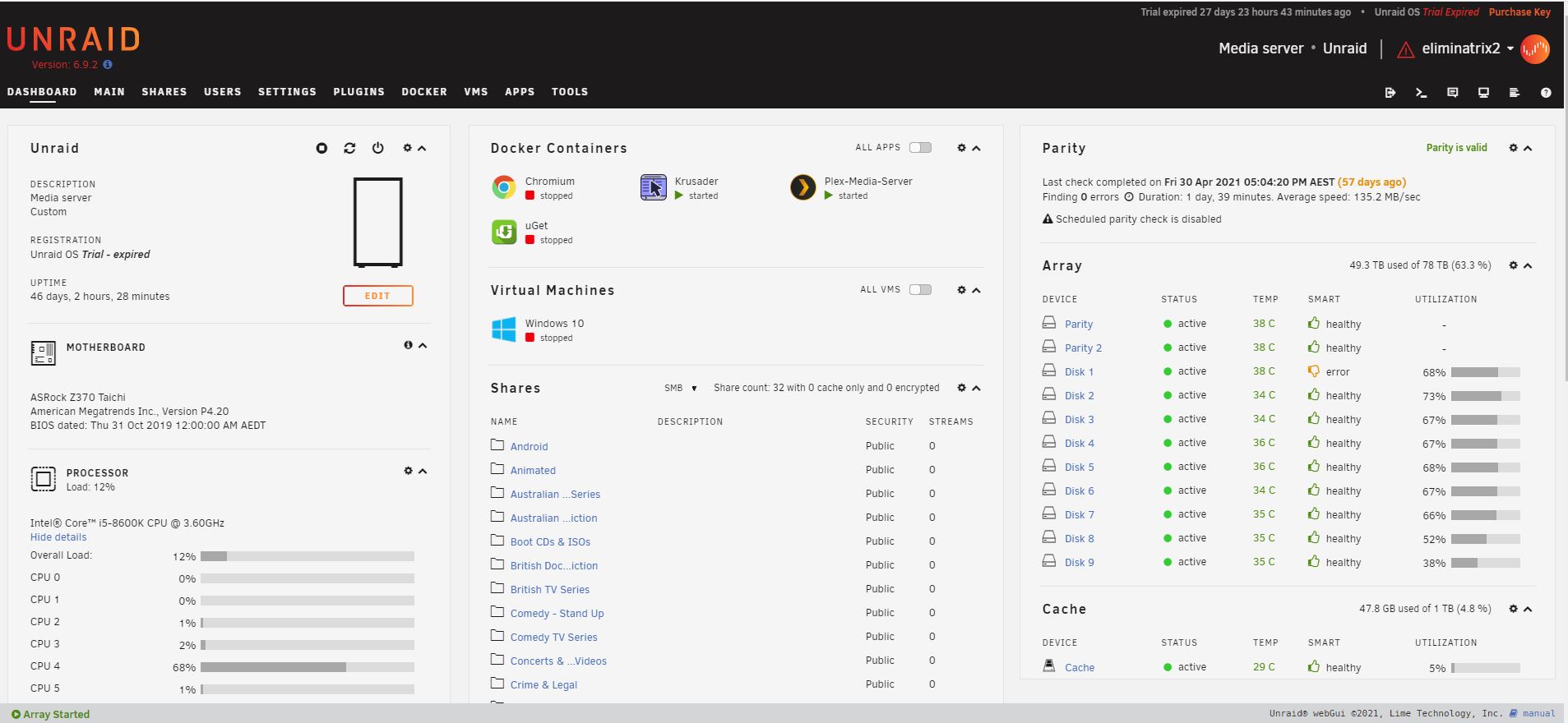

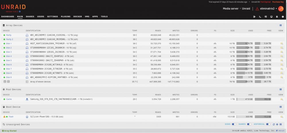

Hi All,
My trial period has ended - when I go to purchase a license - it says that Plus is not available. Can anyone explain why? Plus is "up to 12 attached storage devices"
I have 11 drives + the cache drive = 12. My understanding is that the USB drive that runs Unraid is not included.
Thanks in advance!
Do you have any devices attached to the server that are not being used by Unraid?   Your screen shot cuts off too early to see if there is anything under Unassigned Devices.   All storage devices attached to the server are counted even if they are not being used by Unraid as far as the licence is concerned.

No, nothing. What's there in the screenshots, is what's there. I did have an external hard drive enclosure connected at one point - but that was *weeks* ago, and it was just to copy stuff into unraid from backups.
