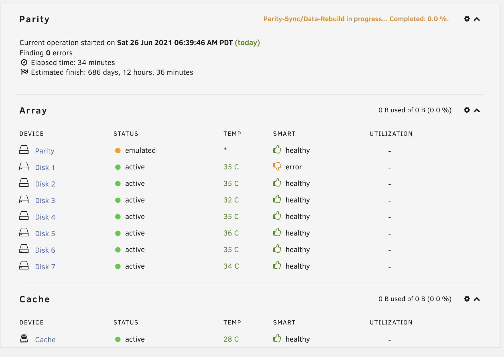

Initial Parity-Sync Estimated Finish: 600+ days
I just build my NAS with a fresh install of Unraid. When I start the parity-sync, it shows the estimated time to finish as over 600 days,
620971758_ScreenShot2021-06-26at07_13_59.thumb.png.4d5e576290ed6e8e60f3bb89948fd565.png
I have attached my diagnostics folder.
