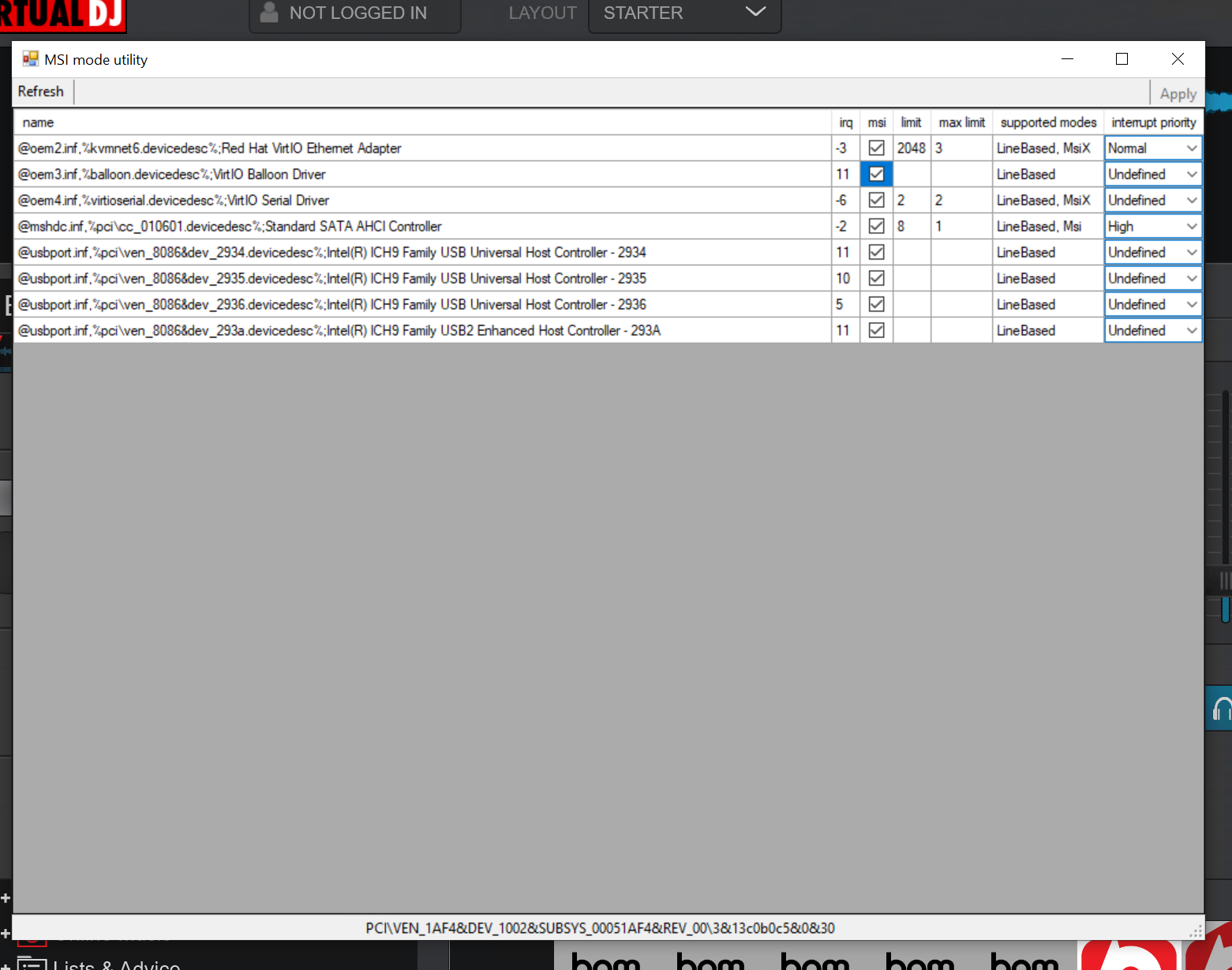

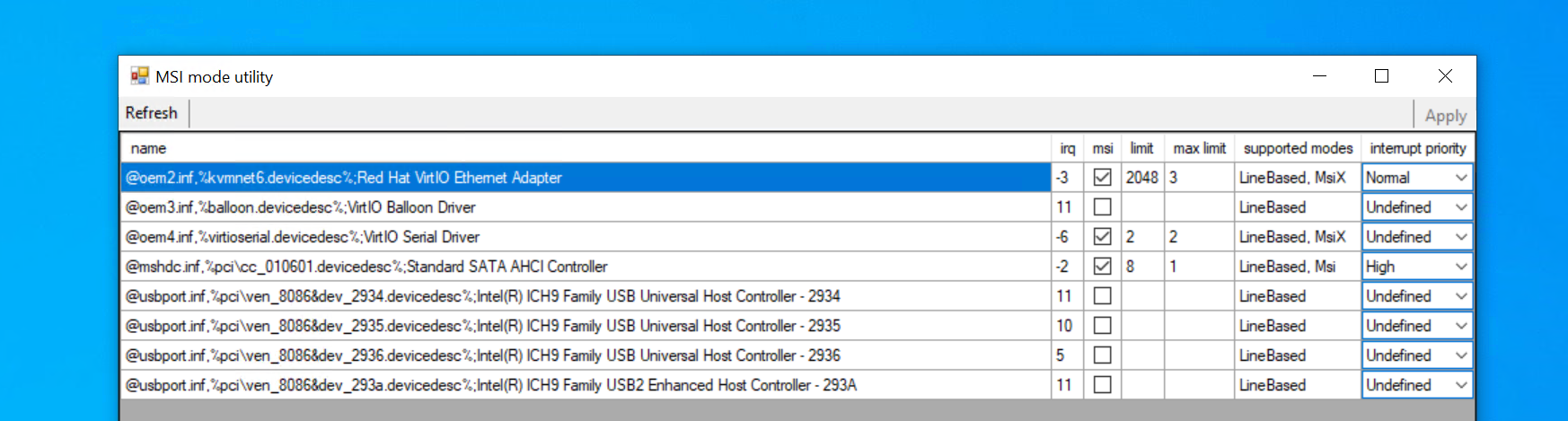

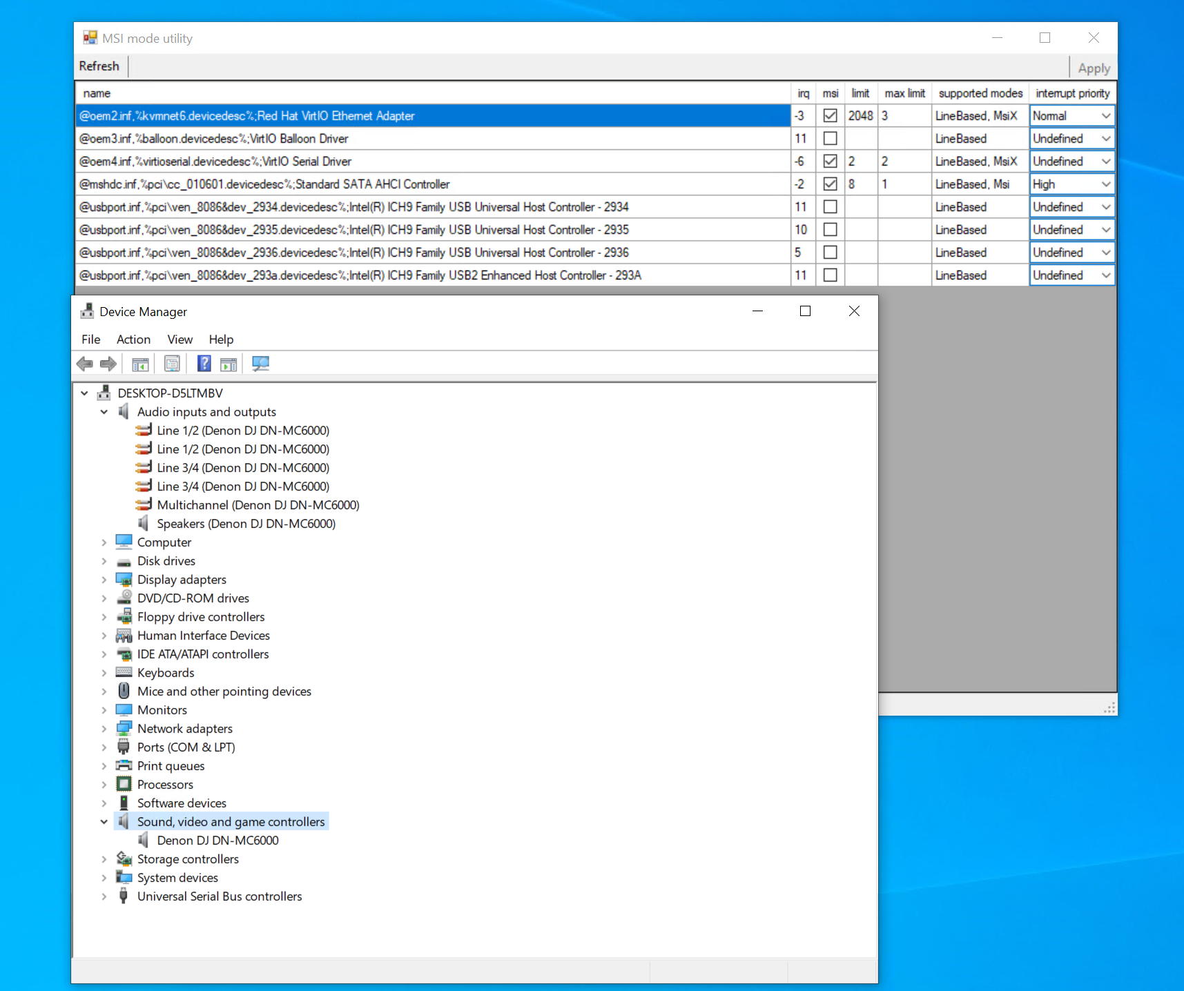

Try to enable msi mode in the vm with the attached utility.
First backup the (v)disk.
MSI_util_v2.zip
wont run
it loads up some thing  gives error
requested registry access is not allowed
i click ok  and click the refresh button
but gives the same error..
is msi mode for  msi boards?

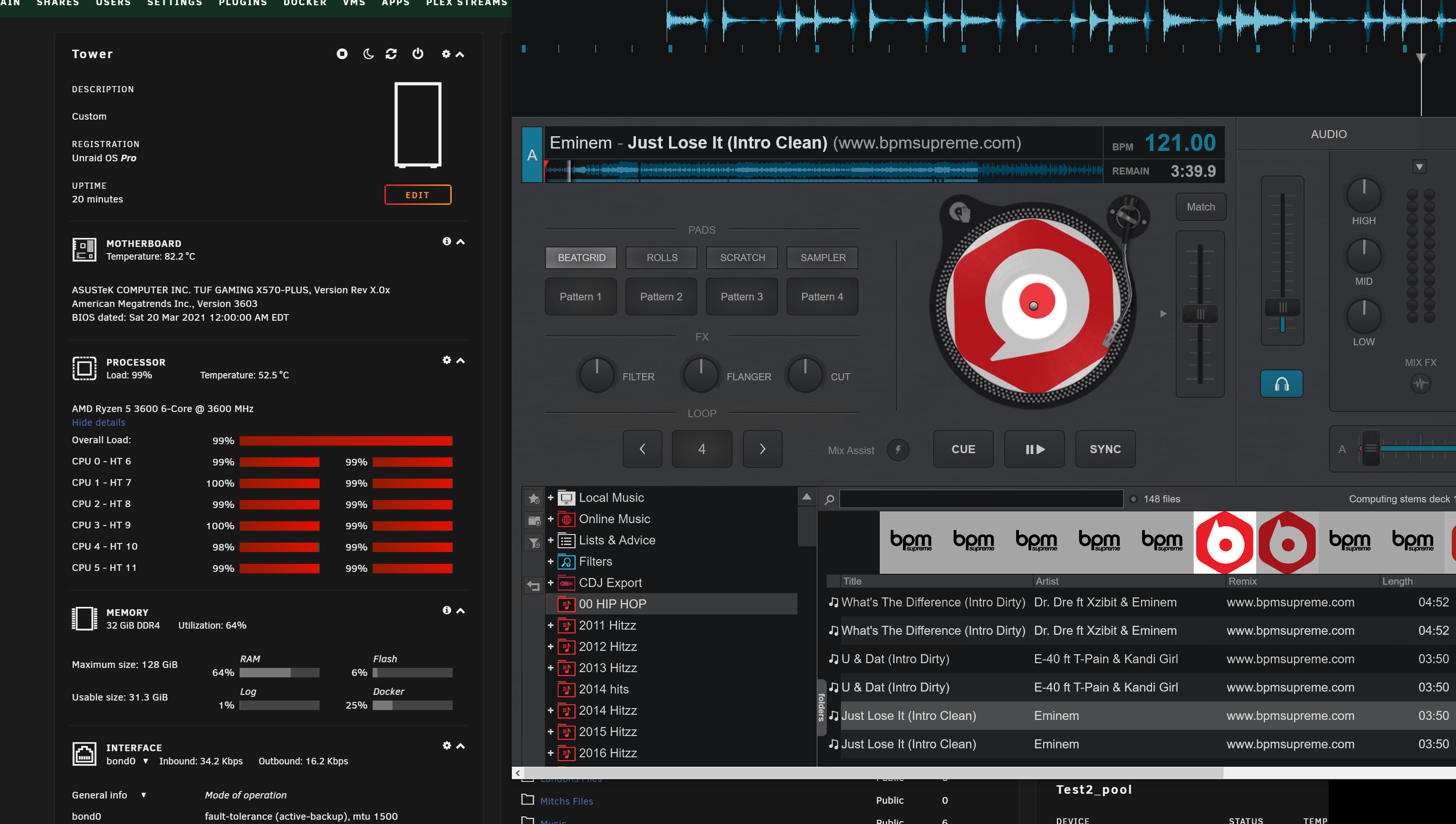

and i get vm to kinda work but all cores got 100% when i play a mp3 in the VM.. in bare metal it never goes all cores 100%
and the audio plays like a record playting and when you touch the record it has that pause etc..  and i cant get it to work
i was thinking maybe i need a 12 core 3900x cpu?  or is this AMD issue  since i cant do passthrough with Ryzen  properly like my other post that never got solved

Did you run it as admin?
No it's not for msi motherboards, msi stands for Message Signaled Interrupts

ah ok so i had to extract it from the zip file.. and then ran as admin
so do i check everything off for msi?
maybe thats why i have sooo much problems with the AMD and passthrough  as i wasnt able to get it solved
but do i select all msi?   and does what the message signaled interrupts do to each thing?
i do have audio device
Sorry, I don't know how this MC6000 works in details: for what I saw it seems a sort of mixer, but how you connect it to the vm?
Is it connected via usb?
And if it is, does it attach to one of the virtual usb controller in the vm?
If so try to enable msi mode on the usb controllers.
If it's attached to the usb2 controller you see that it's using irq 11, which is shared with other devices: sometimes having a shared irq doesn't create any issue, sometimes it does.
But please, before doing it, save important data.
Edited by ghost82

yes  its a DJ mixer i have plugged in via one of the USB ports on the back of the motherboard.
only thing thats installed in the vM
is Virtual DJ. ASIO driver for the mixer and some updates..  dont even have a SN yet for Windows 10 install as i went from home to Pro.... so its just the bare setup
what drives me nuts i have to do with them i find it with my other unraid desktop i experimenting  i gotta keep doing that damn DETACH ATTACH  in the VMs page.. i really dont know why vms loose USB that hot plug stuff i dont even unplug..
so  just check all the USB msi then?
so i figured maybe it was issue from win 10home running in VNC    so went Pro to try to get RDP  but even RDP VNC has same issues
and i find if i run the Virtual DJ software
all 6 cores run 100% now  by idling   yet  if i actually run it on a physical machine it runs near nothing percentage.. dont have it running so i cant get it to ya
but i can try checking the usbs then. i not sure which one is linked to the dj controller
yes I would do this.
It may be better to passthrough the whole usb controller if you can, and not passthrough only the attached device.

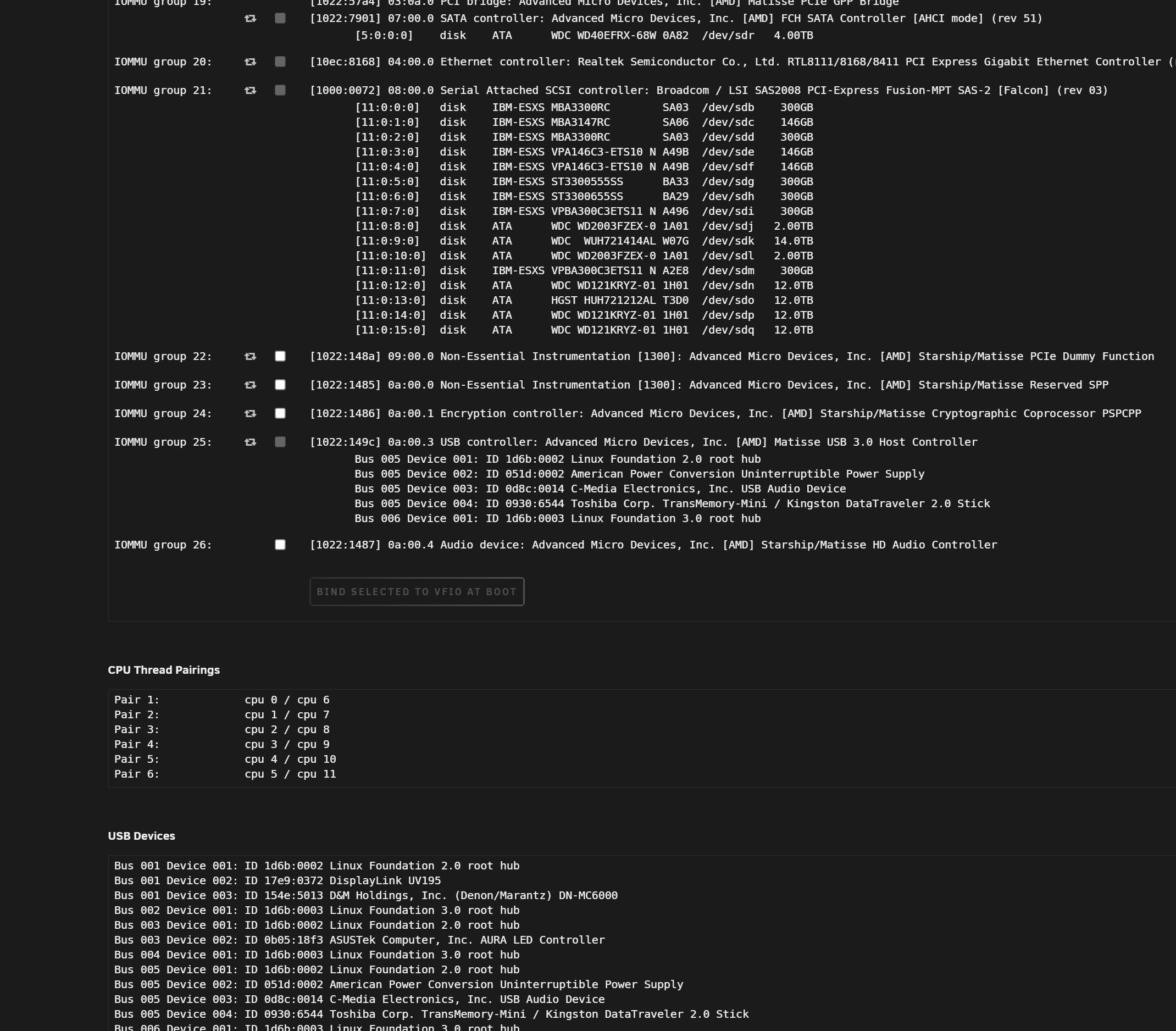

not sure how you passthrough usb controller.. i know the system devices page and you check off boxs to link video card so you can pass through the video card in a VM but thats the limit of passthrough i know about
ill try that when i get back home to test it..  least the msi part.. the passthrough usb controller
and i know there are no PCI devices below the usb check boxes in the vm settings

It's the same method used to passthrough any pci(e) device, including gpu, sata and usb controllers, etc.
As for the gpu, you need to ensure that the usb controller is in its own iommu group without other devices (if it's not you may need to use acs override), put a check next to it (vfio) to pass it through and configure the vm.
But in your machine (host) you need at least 2 usb controllers: the controller to which the unraid usb is attached cannot be passed through, so you need to pass the other one and use it for your vm.
Edited by ghost82

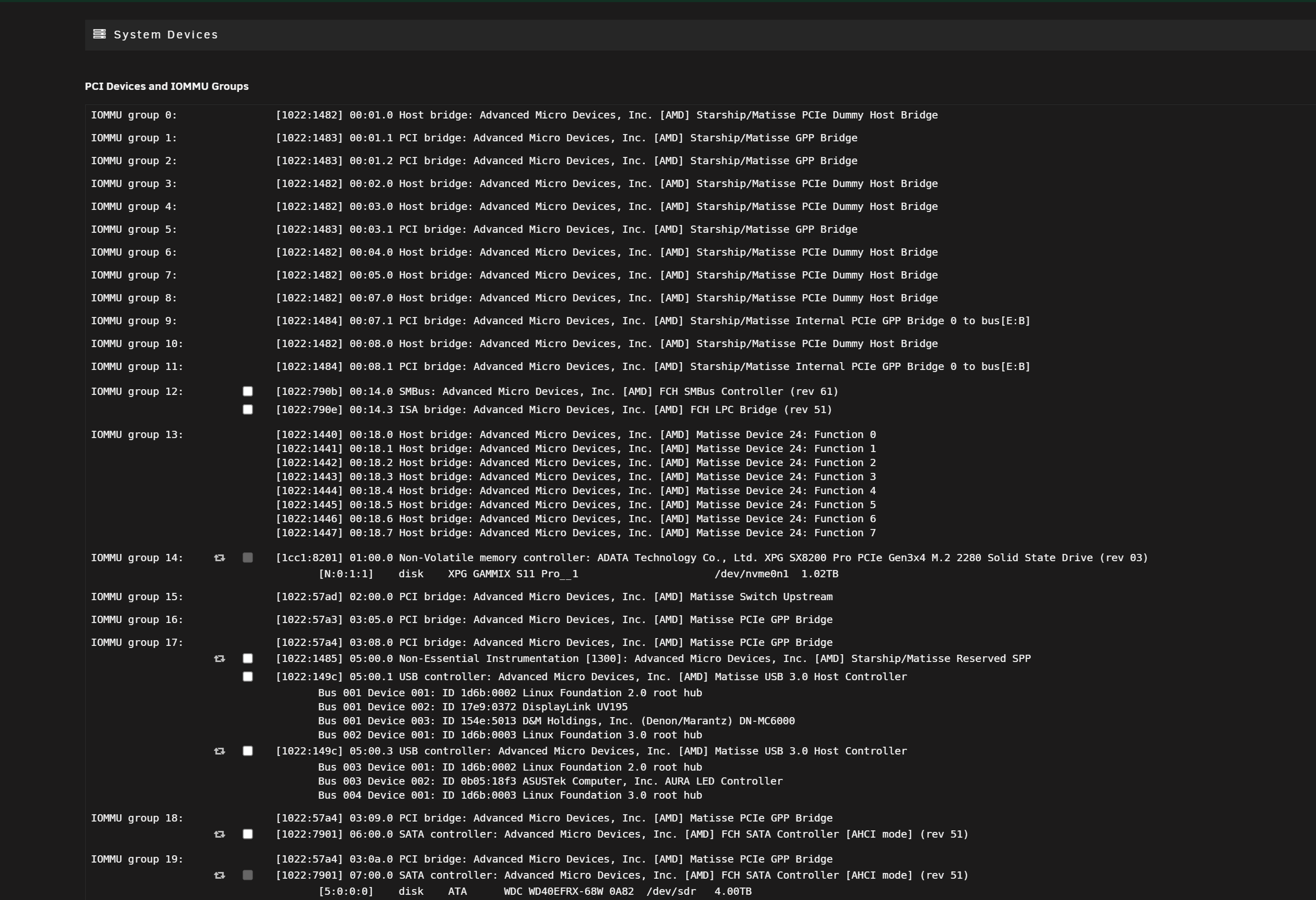

so i just got home  and i tested things.. i didnt try the editing xml yet
i tried the both multifun  downstream
the system device page doesnt change..
audio  in the vm  is still choppy
you need to restart unraid.

i find now  if i use my virtual dj software the audio is chopping  and all run 100%
if i play mp3 using default windows player  then now its not chopping least not the first file i tried and not using 100% on all cores

oh and i noticed now couple times. now  VM  reboots on its own so it isnt stable running the Virtual DJ  goes 100% all cores and its rebooted through RDP
there tricks didnt help.. she still choppy  and runn 80% and higher.. i commented in there but nothing helped she still stutters and runs 100%  i figure maybe if i had a 12 core cpu  if that fix things

If you have a second usb controller, as I wrote you can try to passthrough that, usually devices attached directly to a passedthrough usb controller behave better.

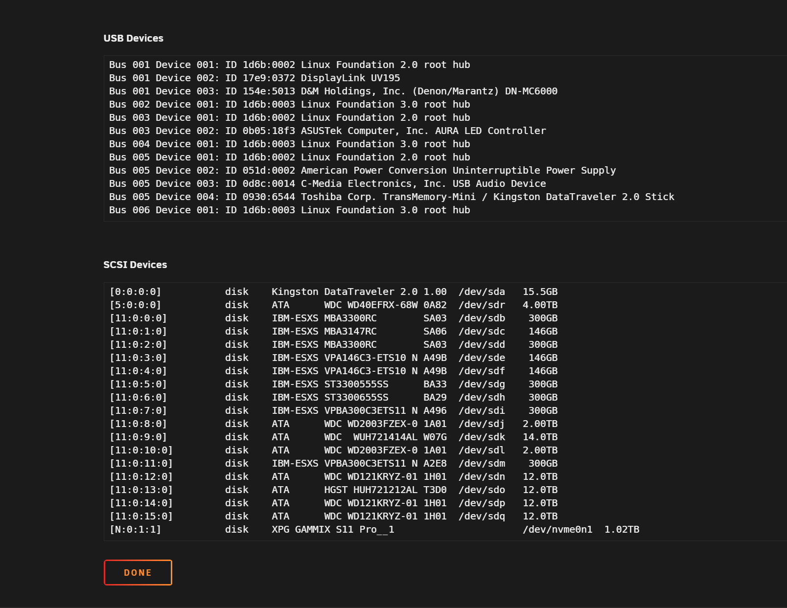

i dont actually know how to pass through a usb controller.. i posted the pics above all the system devices etc.. youd understand it better then me
i only know from a space invader video  do the override.. check off the 2 boxes so  audio and video of a graphics card  linked. which doesnt make sense  because if you got multiple cards  you be checking off multiple boxes ..
but ya  and in the VM setting they dont have a passthrough  usb controller..  just Videocard
and from the pics i posted it doesnt break up some of the devices  its got a gray box
i dont understand it enough or i dont retain the information  enough as i dont dable with it everday  once in a blue moon kinda thing so i forget
