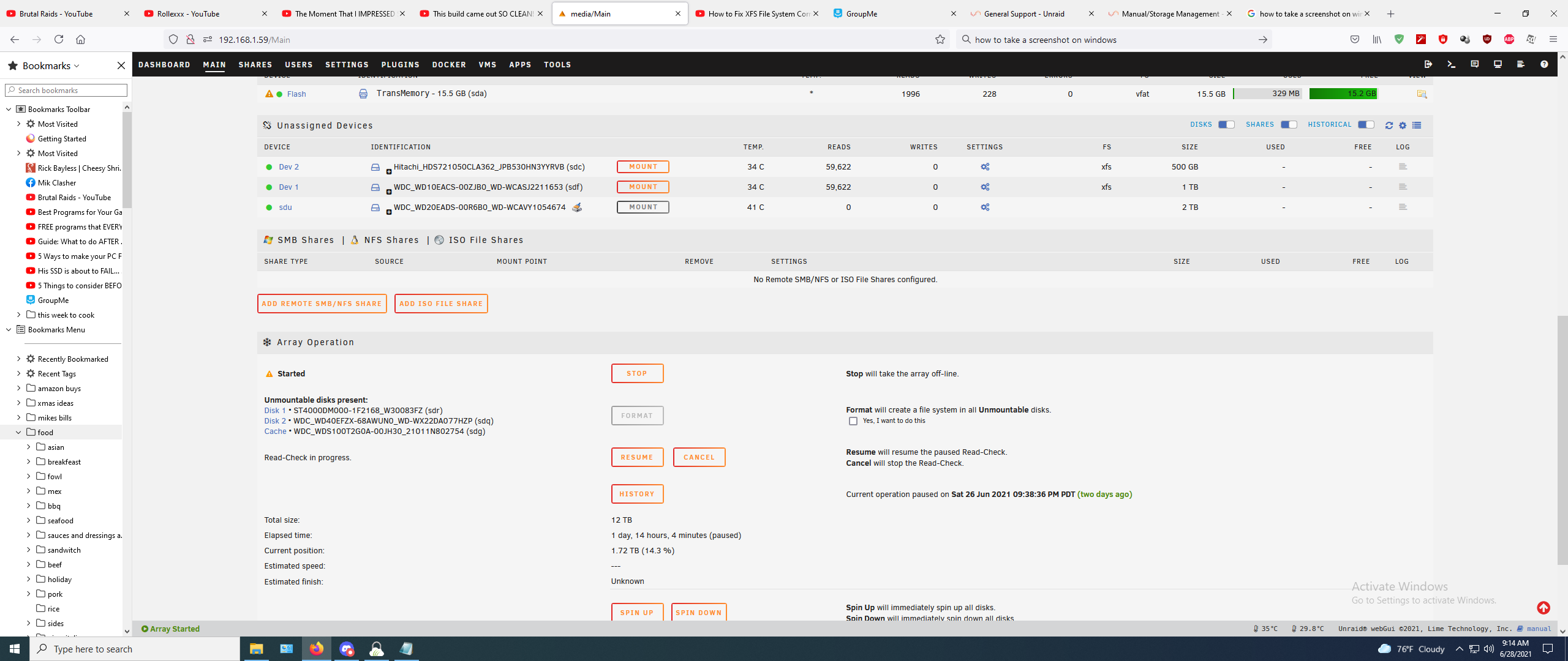

Am I not able to go into Maintenance mode because I am running a trial copy?  I am trying to fix an xfs file system corruption

The screenshot shows the array started, you must select maintenance before you start the array. Hit the stop button, and see.
What makes you say that ?
thank you @jonathanm it does show up now....

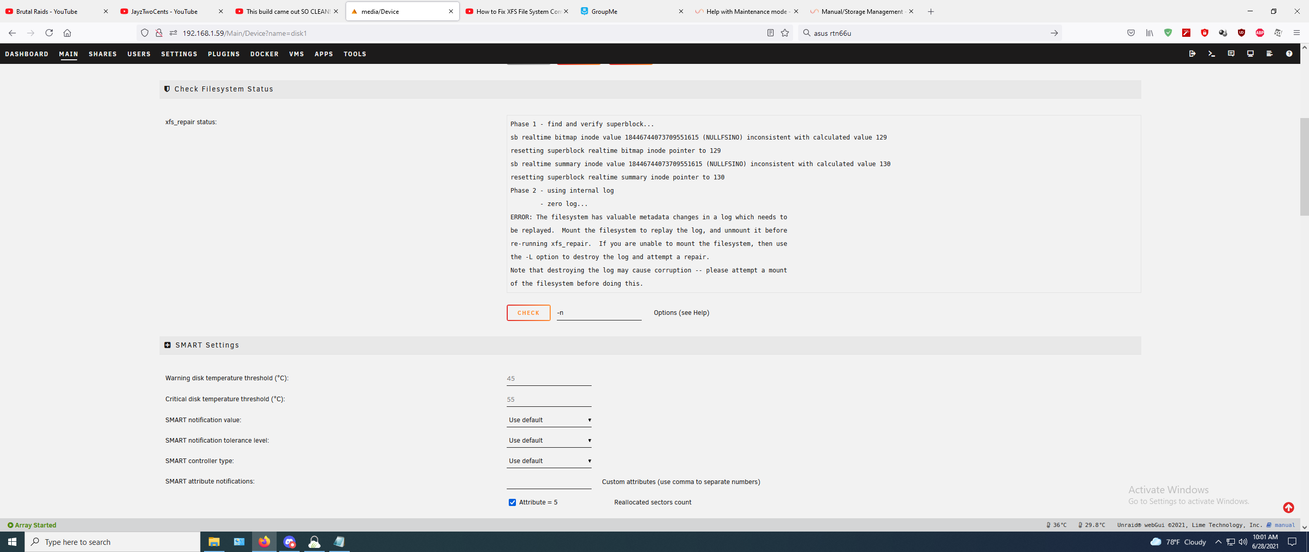

this is what i get after running the check....should i use the -L option?
Yes.
