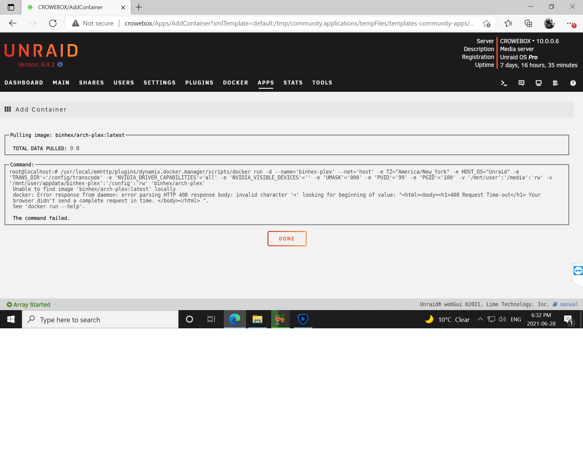

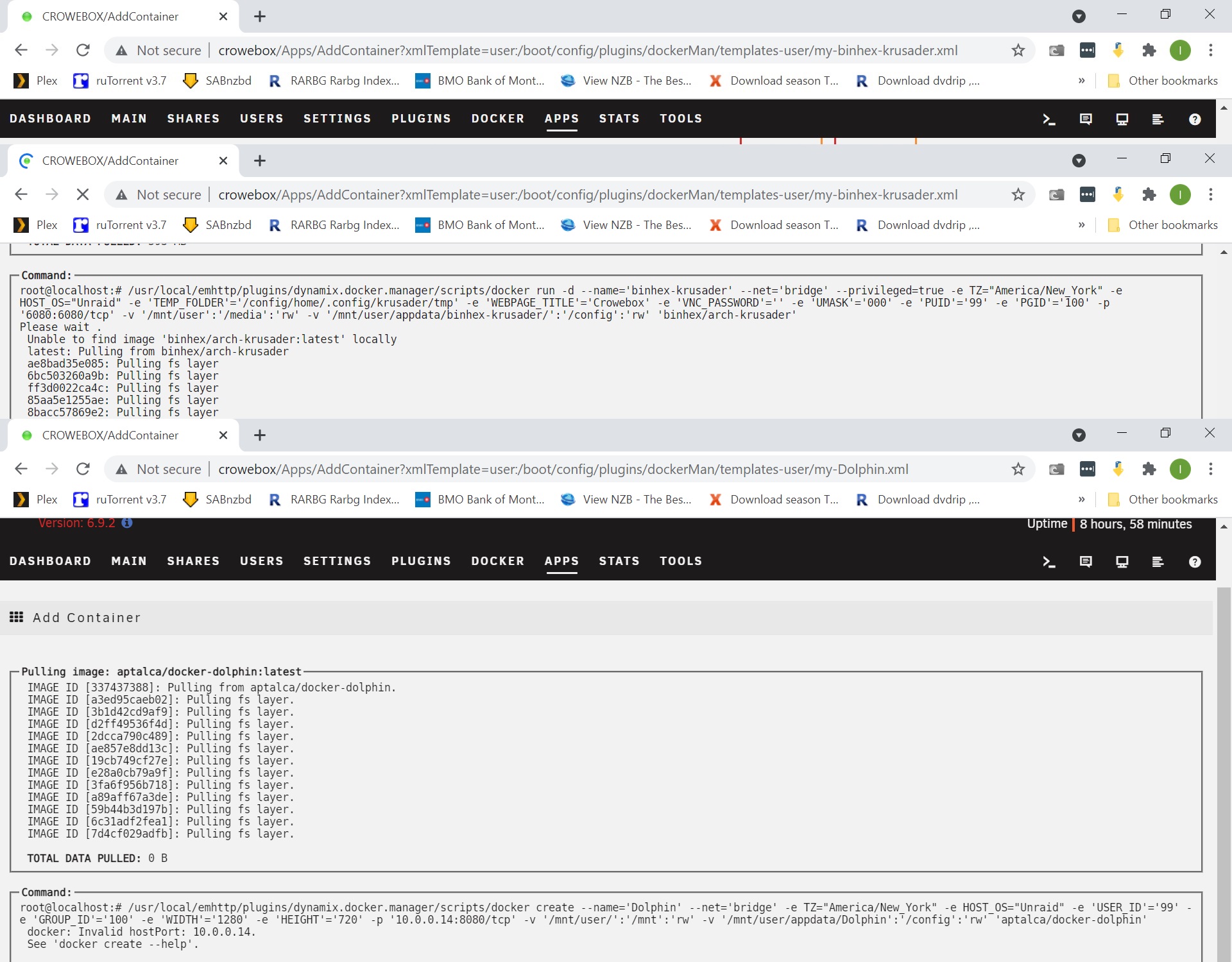

Here is a screenshot when I try and download any docker app in community applications. Same error everything. Says can't find image locally.

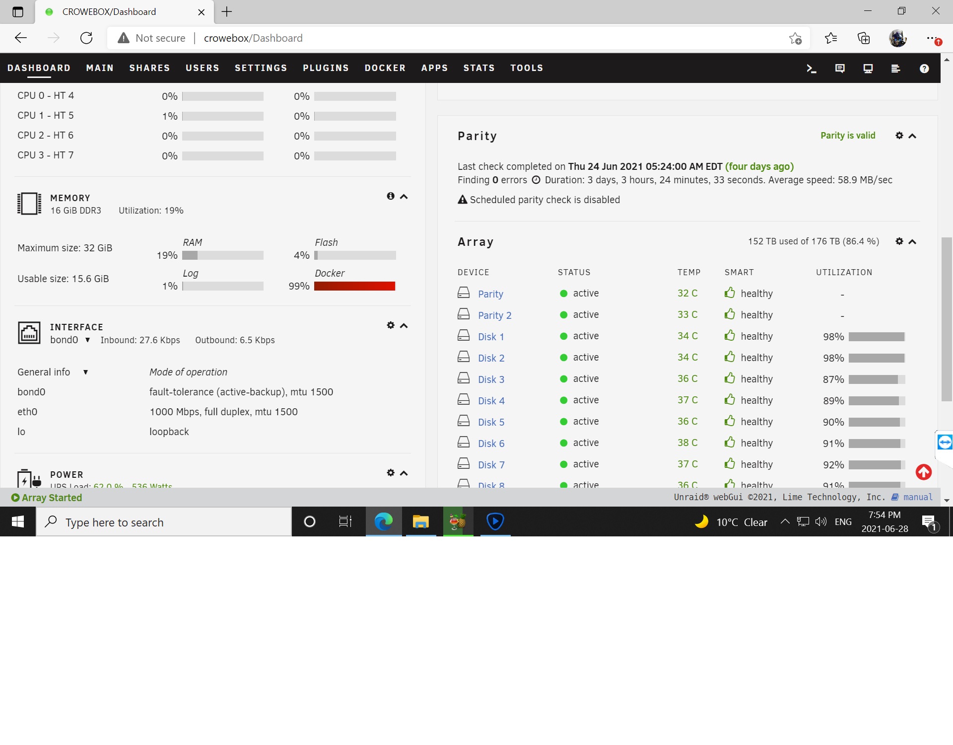

Thank you for guiding me in the diagnostic direction. Here is the diagnostic log. I also just saw when I went to the Main GUI page it shows the Docker memory usage at 99%.
I don't think it has ever looked like that before. I took a screen shot.

The usual reason for filling docker.img is applications writing to paths that are not mapped. Each of your docker applications must be configured to only use paths that correspond to container paths in the mappings, case-sensitive.

changing the image file size didn’t have any effect. I still have the same issue. No matter what docker I select to download, the error says it can’t find docker image locally? And browser didn’t send complete request in time.

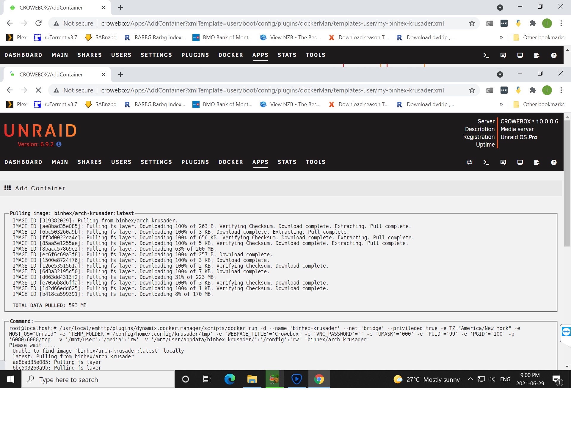

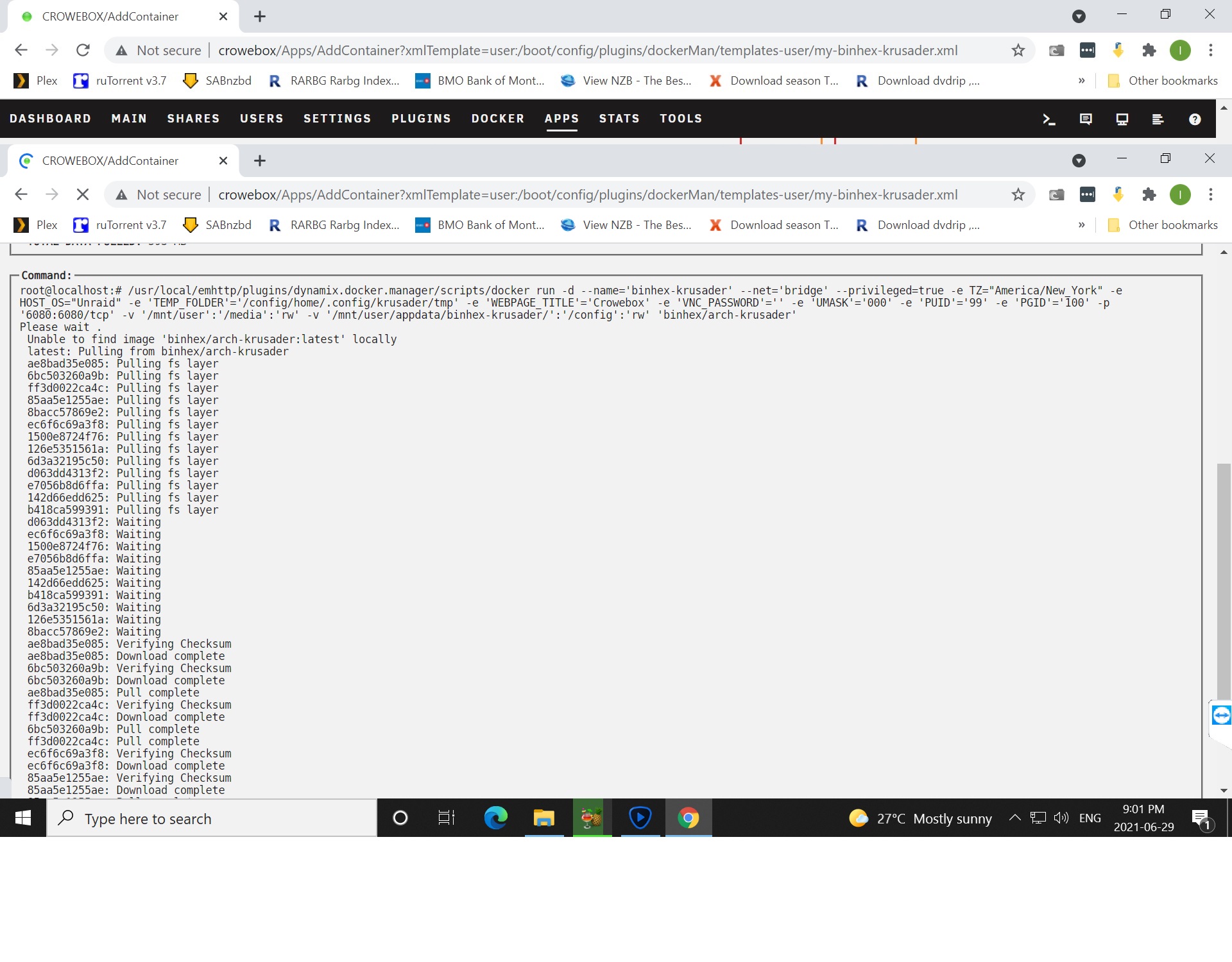

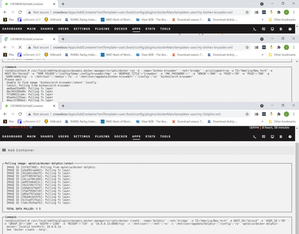

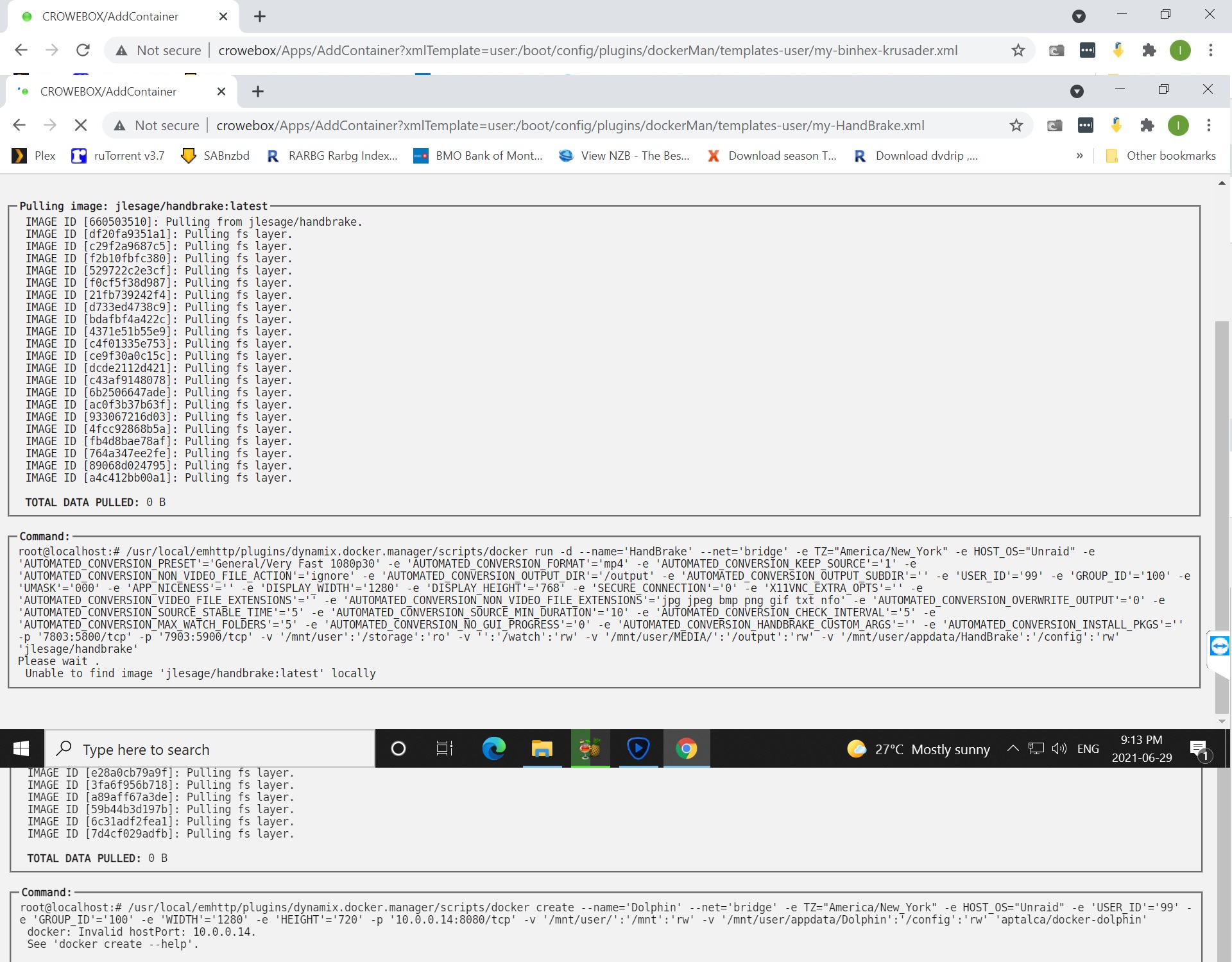

I attempted to download Dolphin, Krusader and Handbrake dockers just to give it a try. It almost worked for Krusader, downloaded 500 mb of the image but when it extracted nothing happened.

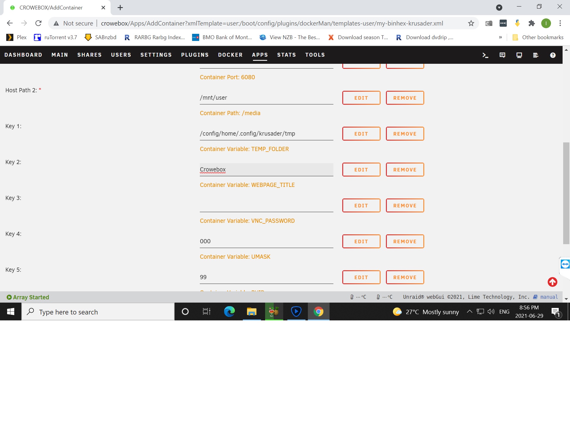

I have several screen shots to various dockers trying to install and the config page for Krusader. I did as you suggested and deleted the docker image and put it back tp 20gig.
I am open to other suggestions.
I was surprised when the Krusader docker even downloaded, Thats farther than I have gotten yet.
