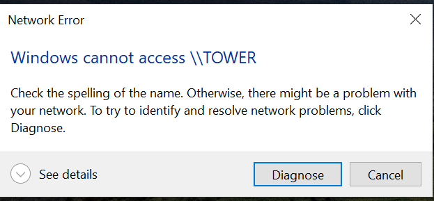

So now that i got that all switched and all my dockers and everything are working perfectly accessing the network and internet via the 10gig port mapped to eth0, i no longer can access any of my shares. I cant even access my system with ...
\\tower

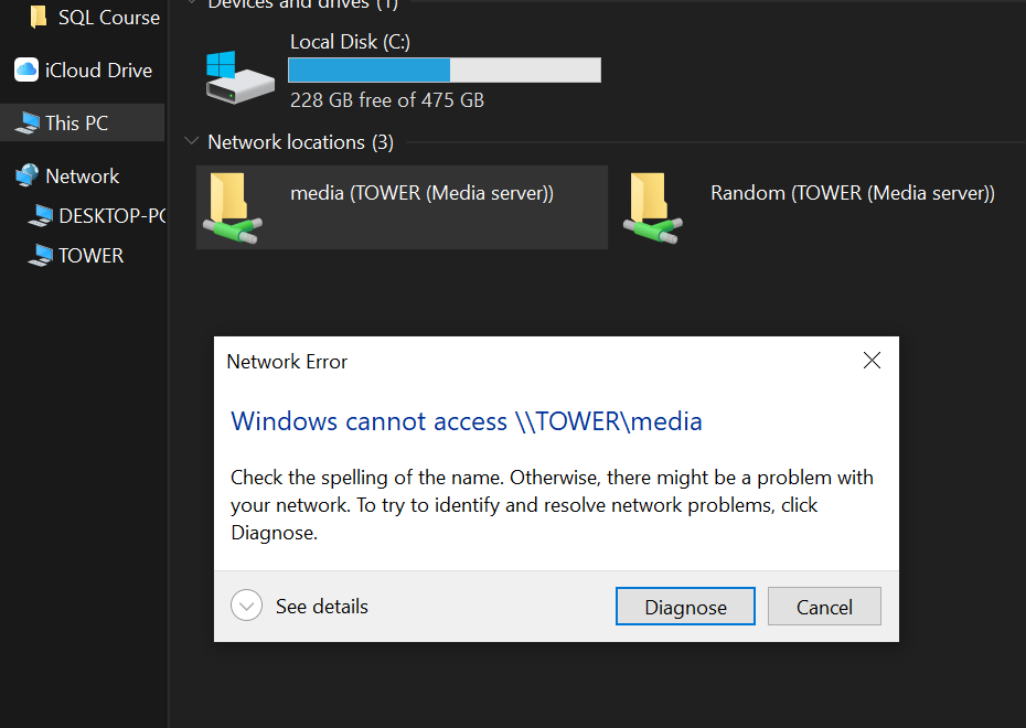

I can access the unRaid server just fine from the IP address to the GUI, but now i need to fix my shares. I tried to access them from my Windows 10 desktop, Windows 10 laptop, and older Windows 7 laptop i have laying around and the minute attempt to access it i get an error within Windows.

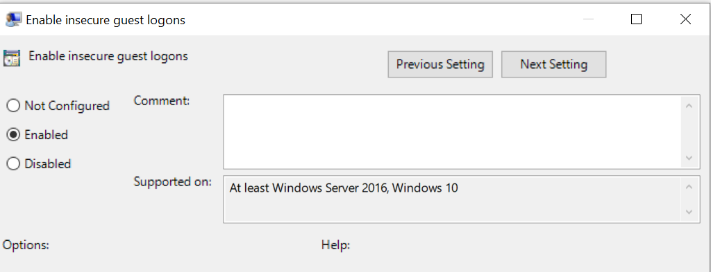

I googled it, tried the common fix I see of enabling the guest login, but that didn't fix my issue and I don't think that is it, since its multiple systems unable to access the shares.

Update: I have gotten a little progress. I cant access my tower shares or gui via \\TOWER like i could previously, but i learned i could access the shares seperately via ip address in my case 192.168.254.10\media. It prompted me for a user/password. The root user with my normal password didnt work, so i create a new user on the server and was able to enter that share user/password and get into the share finally, but now i need to figure out why its not able to found via \\tower anymore like it was prior to switching the ethernet ports.

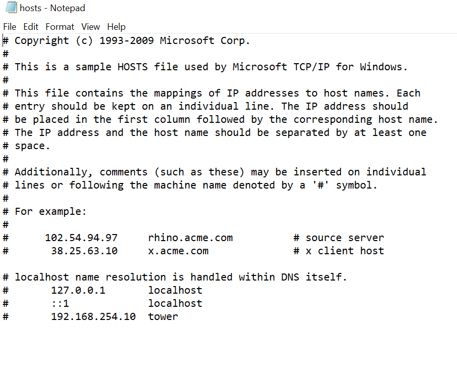

Most likely reason would be cached name resolution somewhere. Easiest solution would probably be to manually set the entry in your windows hosts files on the various client machines linking tower with the static IP you assigned to the server.

Could you possibly go into slight more details on this, still learning as i go.
3 minutes ago, jonathanm said:
ty,
I just viewed my host file, but the ip address in it is correct, so i didnt change it. I did do the ipconfig dnsflush, but still errors out on \\tower

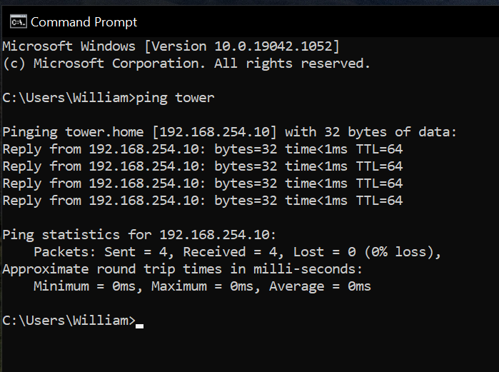

someone on reddit asked if i could ping it...
here are the results..
