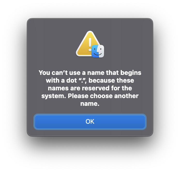

October 12, 20224 yr Author 2 minutes ago, wgstarks said: Sorry, you included that you weren't using macOS enhancements in your first post and I missed that. Your veto setting should work. I just tested on my unraid server by setting veto files = /._*/ and then attempting to write a file named ._test to the server. The write failed as it should. I think the bug must be fixed. My only advice would be the obvious, reboot the server (if you haven't already). Maybe someone else's some ideas??? You're probably already aware, but there are scripts to clean out the ds store and apple double files. @wgstarks, what version of unRAID are you currently running? I only started having this problem when I upgraded to 6.10 (and now 6.11). My setting worked previously when running 6.9.x. I have rebooted several times as I've been experimenting. I've also started/stopped my array numerous times. Just out of curiosity, when you attempted to create the ._test file, was the error that you received a macOS Finder error or was it a Samba error? I ask because the macOS Finder will throw an error and prevent your from creating a file called ._test even on your local drive. Is it possible that the error you saw was a Finder error? The attached image illustrates the finder error. I attempted to recreate your experiment whilst side-stepping Finder ... opened up Terminal ran "touch ._test" to create the "._" file ran "cp ._test /Volumes/sambaShare" As expected, the write to my sambaShare succeeded even with my veto files setting. If things were working properly, the write should have failed. Thanks again for taking the time to run your experiments and for responding!
October 12, 20224 yr 2 minutes ago, jmos1277 said: @wgstarks, what version of unRAID are you currently running? I only started having this problem when I upgraded to 6.10 (and now 6.11). My setting worked previously when running 6.9.x. 6.11.1 3 minutes ago, jmos1277 said: Just out of curiosity, when you attempted to create the ._test file, was the error that you received a macOS Finder error or was it a Samba error? I ask because the macOS Finder will throw an error and prevent your from creating a file called ._test even on your local drive. Is it possible that the error you saw was a Finder error? The attached image illustrates the finder error. I was using BBEdit to save the file to a share on the server. got a OS warning regarding the file name and had to click ok.

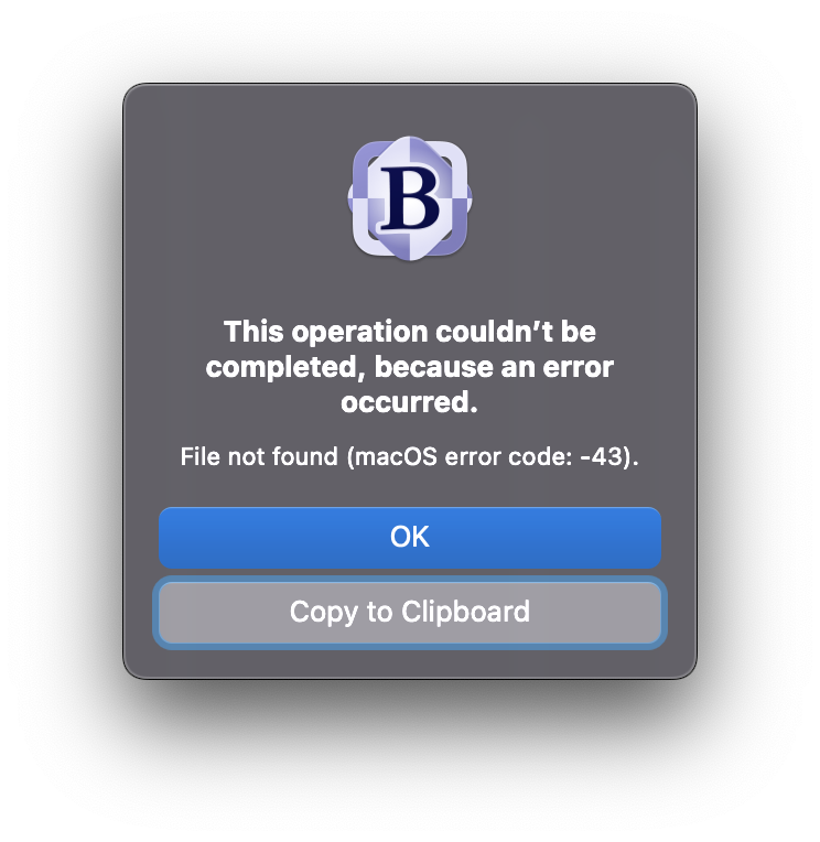

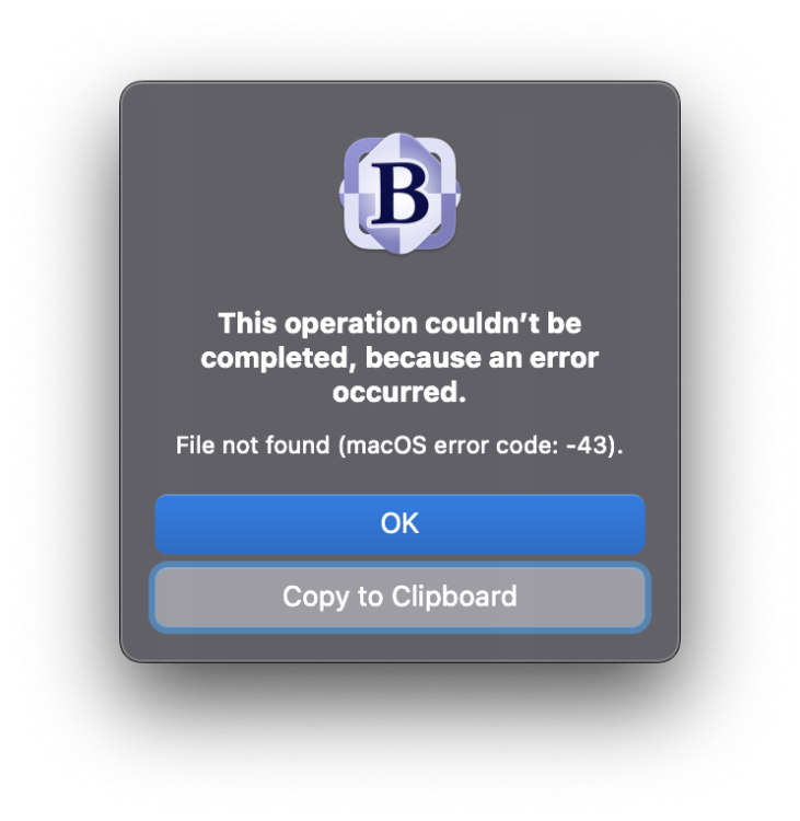

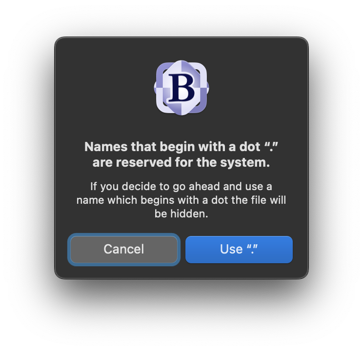

October 12, 20224 yr Author 1 minute ago, wgstarks said: 6.11.1 I was using BBEdit to save the file to a share on the server. got a OS warning regarding the file name and had to click ok. Hmmm .... the mystery intensifies. I ran your experiment using BBEdit and attempted to write to my share directly from BBEdit's save dialog box. I received two errors, back to back ... "Names that begin with a dot "." are reserved for the system." with the option to "Use "."" I selected Use it. Then, a second error popped up: "This operation couldn't be completed, because an error occurred." Finally, I checked my sambaShare ... and the FILE was there despite the error message ... LOL!
October 12, 20224 yr 10 minutes ago, jmos1277 said: Finally, I checked my sambaShare ... and the FILE was there despite the error message ... LOL! Same here. Never checked the share after I got the error but the ._test file is there. Perhaps the bug isn’t fixed. I think you may be needing to use the user script to clean out the files.
