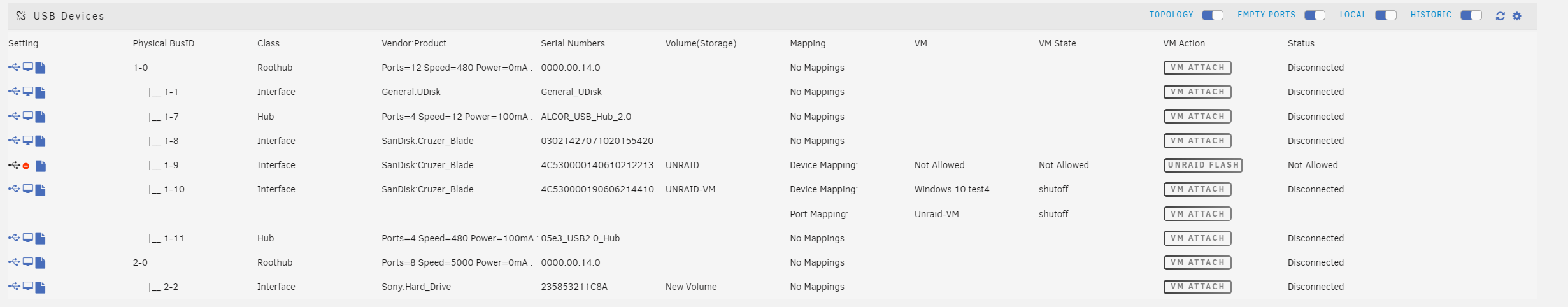

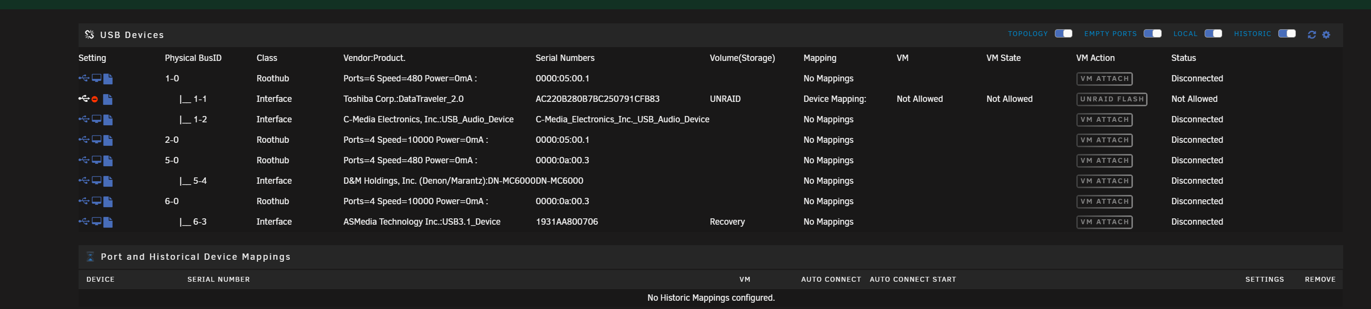

Have a look at my USB_Manager  Plugin. Its not integrated with VM manager but I am going to look to see if that is possible in the future.
You untick all of the devices from VM manager and define in my plugin. If selected it will map USBs either by device or port to a VM at start.
It also supports connecting them to a VM if the device is plugin in i.e. Auto hot plug.
Supports multiple devices from the same vendor.

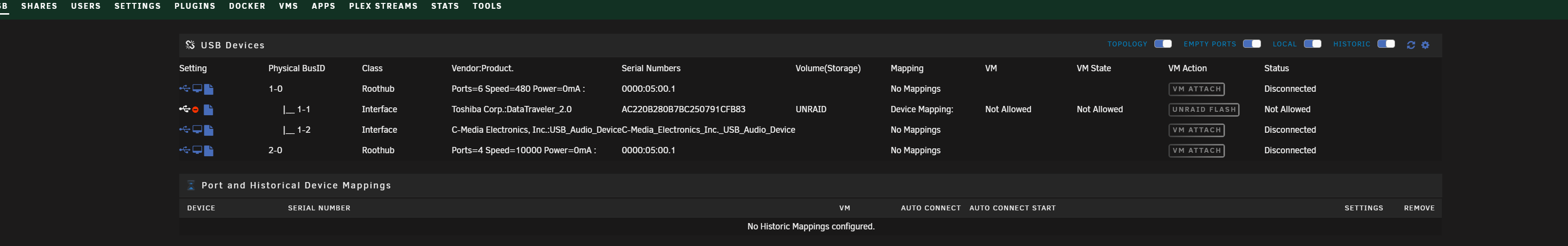

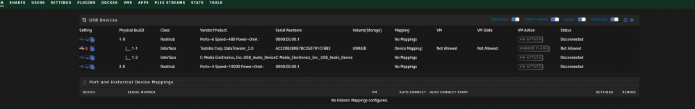

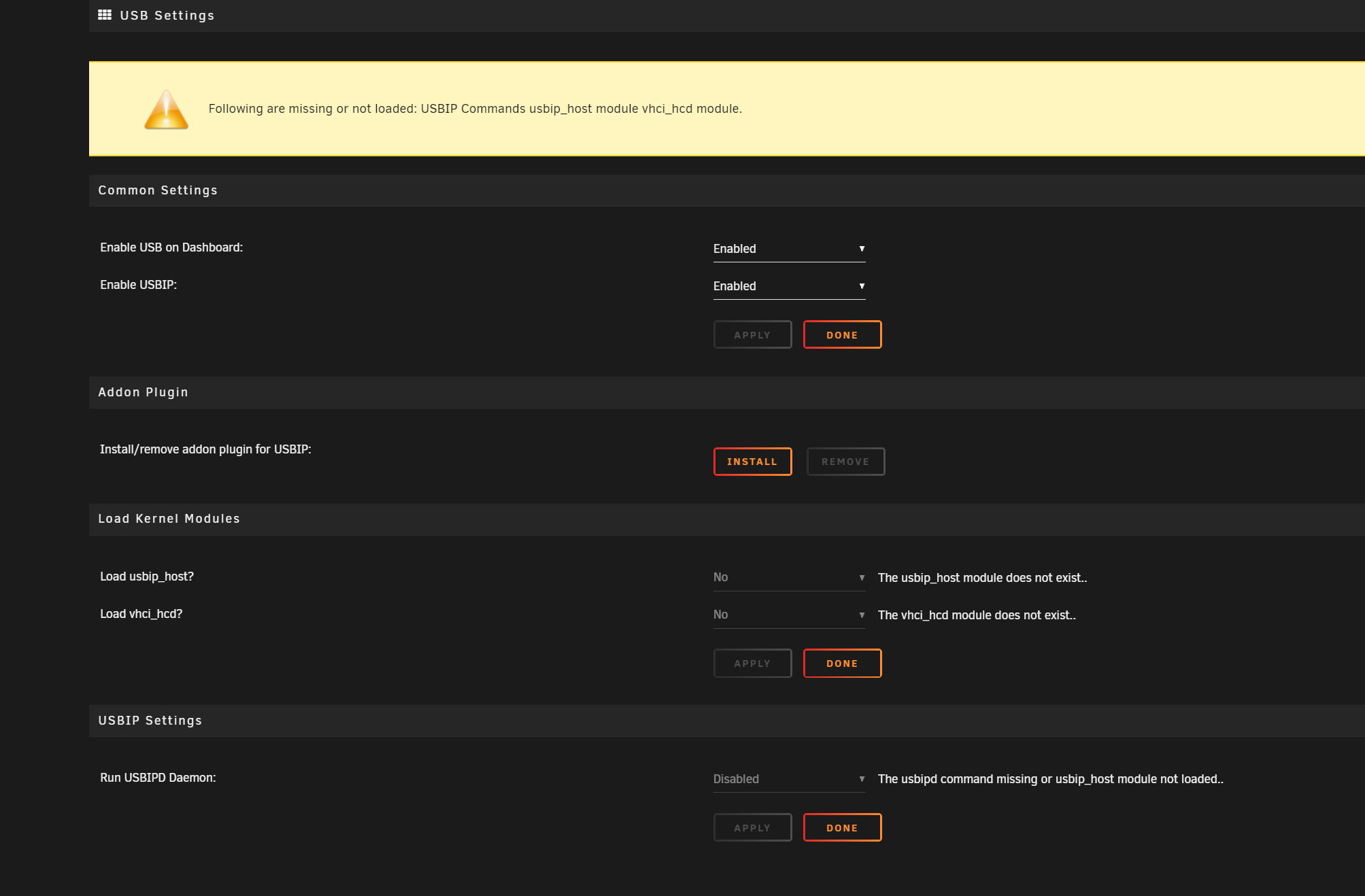

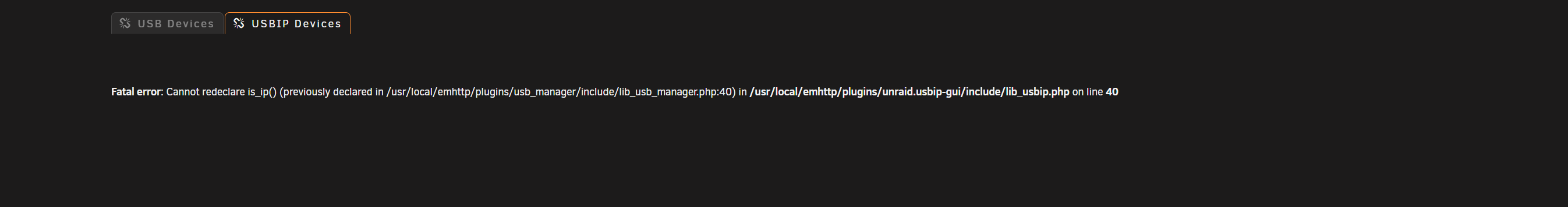

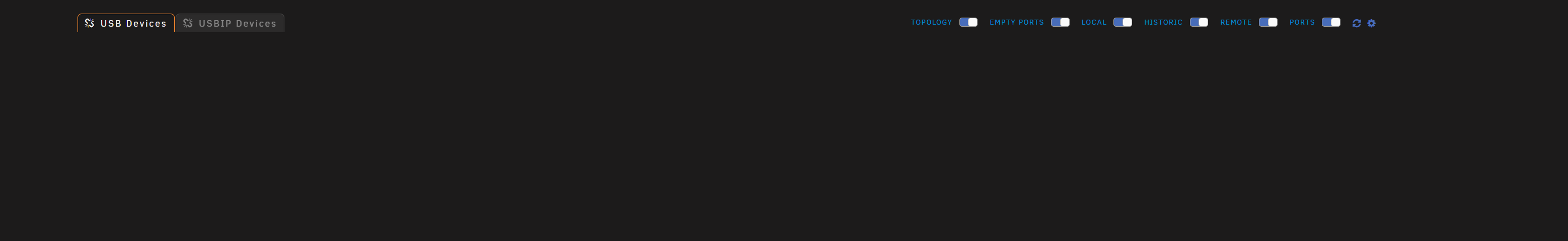

so i installed your usb manager plugin ... and it doesnt show anything but is the error normal?
so i havent gottan a change to read that for new  users  i only installed the pluggins so far
ill read the article this weekend

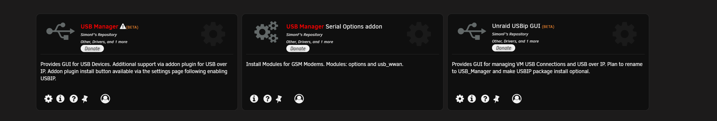

@SimonF i installed all 3
Edited by comet424
Un-install all of them and just install usb_manager the others will be depreciated in time.
do i install USBIP Commands?

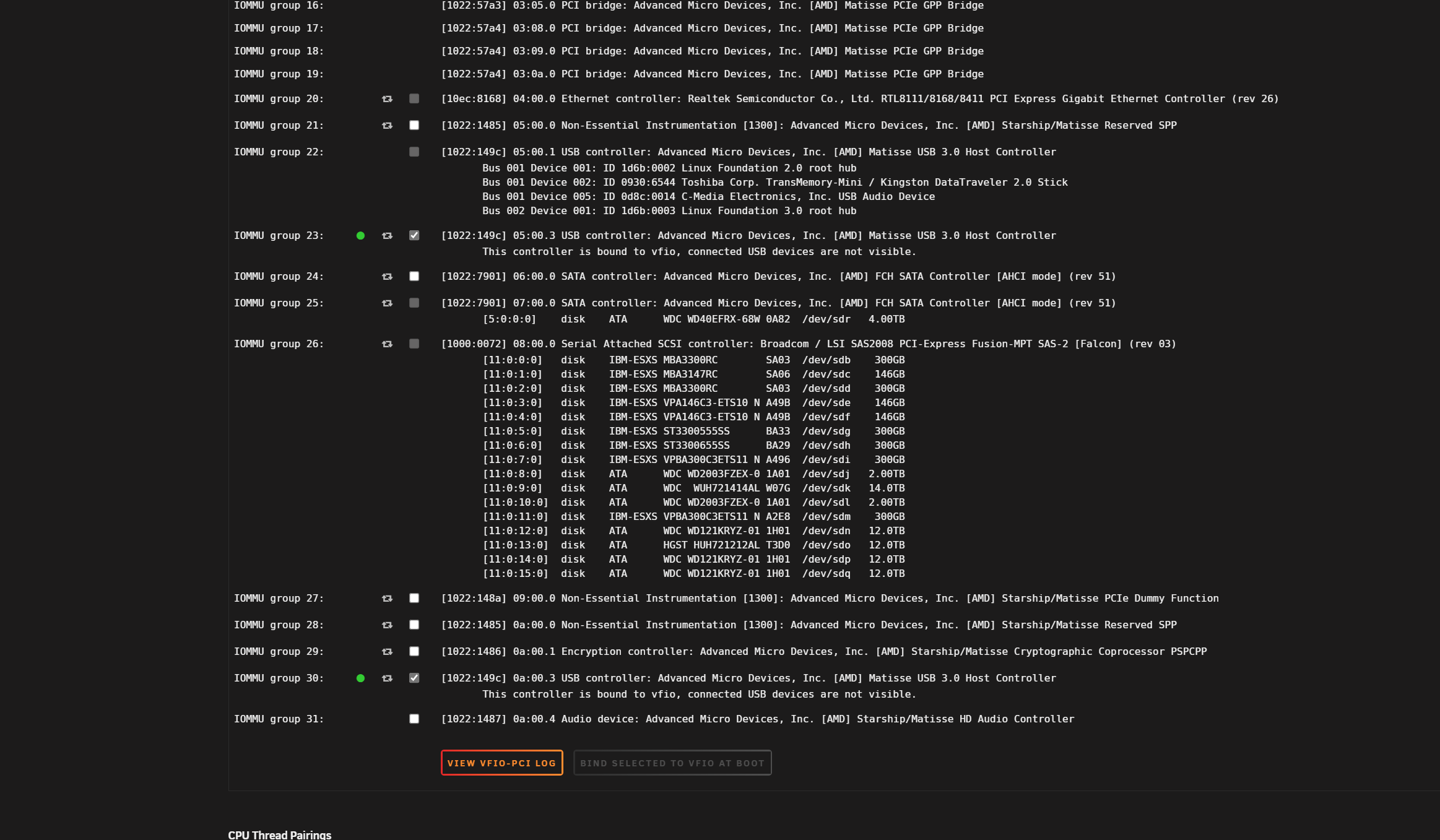

some reason my usb enclosure wont mount.. its not showing up.,. it will light up if i plug into the usb port below unraid usb
is it because i have the vfos?
cuz my 1TB  SSD  wont show up in any of the usb ports except the one  should i uncheck those
You have all of the other usb ports bound to vfio so they will not show in my plugin.
It will only show devices you can see in lsusb.
Have you passthru any of them in a vm. If not uncheck them.
Edited by SimonF
i was getting help in the VM forum.  and they suggest to pass through the usb hub

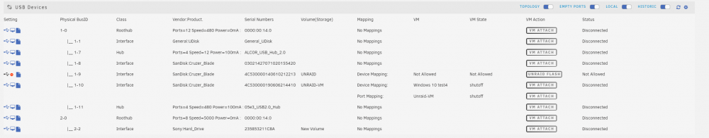

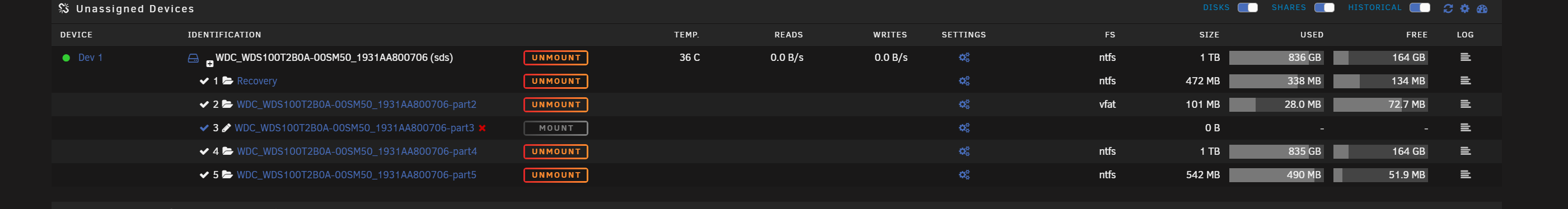

i dont know enough of that info..  also  the usb manager doesnt show up hard drive i have 1TB in an enclosure  usb startech  it doesnt show usb hard drives right thats different from everything else?

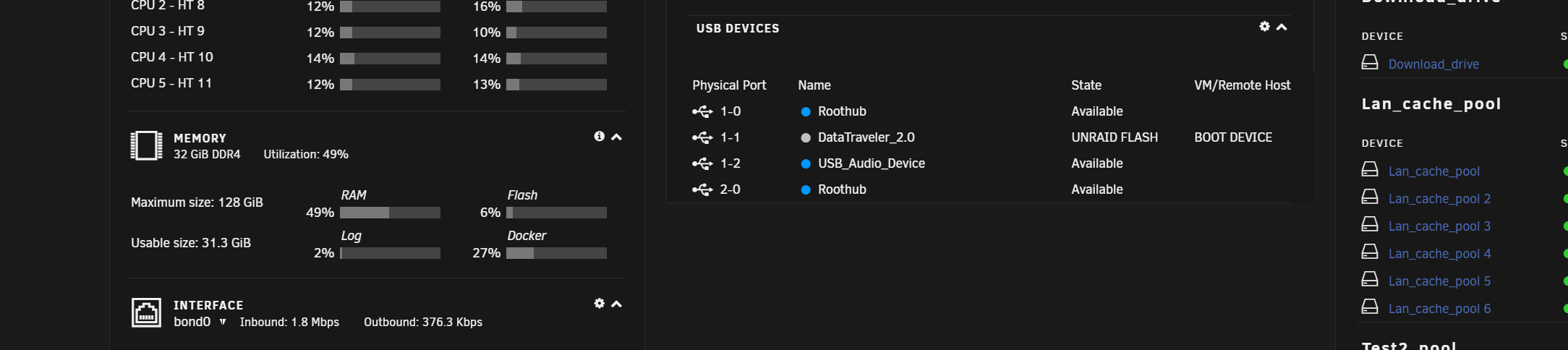

Does the drive show in the system devices in tools
There is a drive on 6-3 with a partition called recovery
Edited by SimonF
ah ok ya its mounted  thats the drive i have multipartitions
i learning as i go..  i figured it would said 1TB or WDSN..........   (WD Serial)  thats why i didnt know so its showing

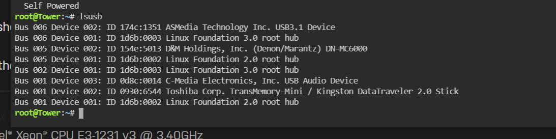

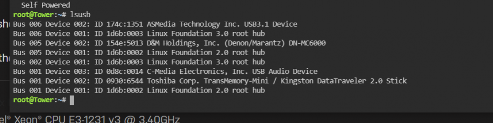

My plugin just looks at usb so it is showing the controller. What do you see if you run lsusb
UD Will show the drive.
I added the first partition so if there are multiple usb pen drives the same it gives a clue which one is which based on partition.
ah ok  when i type lsusb  i dont see the drive i just see the Enclosure i guess is the ASmedia
