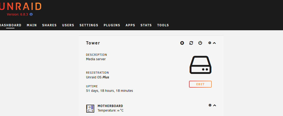

Something weird happened today to my unraid v6.8.3, I plugged a USB to copy its content via krusader docker, and when I open unraid url from my browser, suddenly I see that my black theme disappeared and the banner too.
Below are some photos:

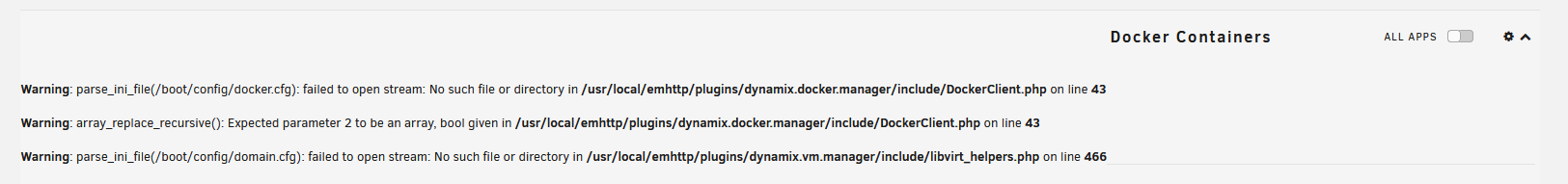

On the same Dashboard I see these lines:

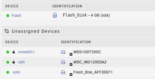

And on the Main tab, my unraid bootable usb suddenly also appeared inside the Unassigned Devices:
sdm is the Flash_Disk - 4 GB (sda) [my unraid bootable usb]
In the screenshot I didn't include the other usb because at the time of these writing i was done transferring the files from it to my unraid server.

If the ‘sdm’ device is your flash disk then it must have dropped offline at some point and then reconnected as a different I’d because the screen shot shows when you booted the boot drive was ‘sda’.  As a result UnRaid will now no longer be able to access any of the configuration information it is expecting to find on the ‘sda’ device.   UnRaid cannot handle the boot drive apparently disappearing while it is running.
