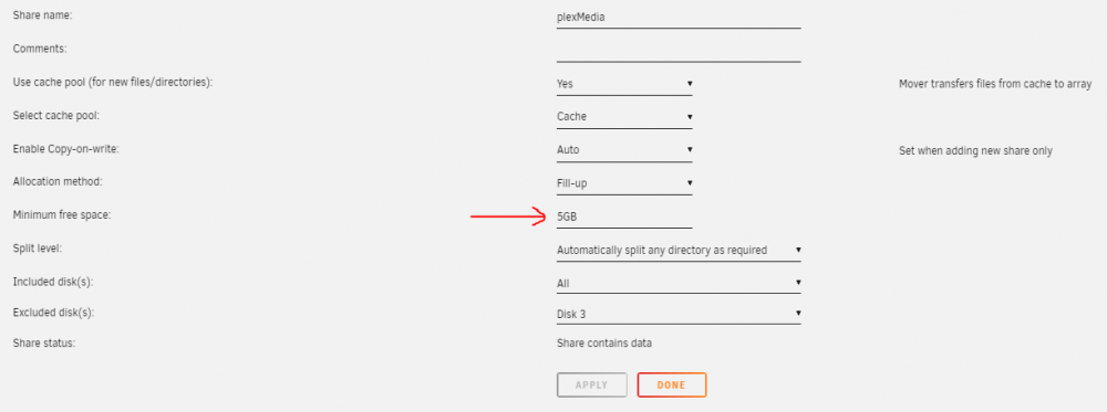

So, I must have set the minimum space to 0KB, which was causing the error. I set the share's minimum free space to 5GB, knowing I'll never get a file larger than that, potentially, and the MOVE function is working again.
(I think I read about free space somewhere in the docs now I think about it.)
[Nope, NOT solved]. I've set a 5GB limit and when I MOVE from the cache it does this:
Only 1MB left, when the limit it clearly 5GB.
There's a bug somewhere in UNRAID.
I'm MOVING while I'm uploading media to the array, which shouldn't affect it because the CACHE is being cleared while new data is being written. And, It should know there's a 5GB limit on DISK1 and move it to DISK2.
The "minimum space free" setting is the minimum space that UNRAID will look for before copying a file from the cache to a particular disk available to a share. It will not ensure that this is the minimum amount of space that is always available on a share.
For example (all numbers made up for this example), if you rip a BluRay, create 4.9GB file, then write it to the server into the cache enabled plexMedia share, UNRAID will actually write it directly to the cache in the plexMedia directory. When the mover kicks off, it will scan Disk1, discover that it has a plexMedia directory that could be used, and initiate the minimum-disk-space-free check. It discovers that there is 5.1GB of free space on Disk1, so the min free space passes (more than 5GB free is "good to go"), and moves your new 4.9GB file to Disk1 in the plexMedia share, leaving 0.2GB free on Disk1. Obviously, your tolerances were even tighter than my made up example, however, it's not a bug.
As noted, Minimum Free doesn't mean to keep that much free. It means don't use the disk unless that much is free. Once it decides to use the disk because that much is free, it will try to write the file to that disk even if the file won't fit.

Just reviewed the thread and there are some other considerations not discussed.
Your pool named "cache" also has a Minimum Free setting which you access by clicking on the first (or only) disk in the pool. It works similar to Minimum Free for a user share. If the user share is cache-yes or cache-prefer, and cache has less than Minimum, an array disk will be chosen instead.
According to your screenshot, that user share is set to Fillup, so it will use one array disk until it reaches Minimum before it will choose another. Then it will use the next, etc. Not sure if that is what you intend or not since you seemed to think something else would happen when you said:
