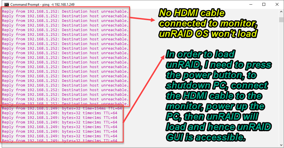

Everything is working fine, except I cannot unhook the hdmi cable from unRAID server.
If I do, the system just wouldn't load into unRAID OS.
I need to do a unclean shutdown, plugged in my hdmi cable to a monitor.
Power up the PC only then unRAID would able to load and finally GUI was accessible.

This is probably a motherboard/bios issue which is needing a monitor attached during the boot sequence
If you cannot change this behaviour via a bios setting then an alternative is to buy a dummy HDMI plug so that the system thinks there is a monitor attached.
