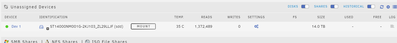

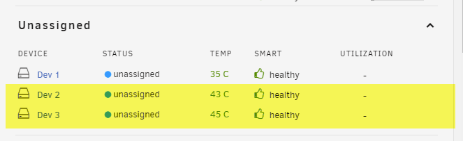

The drives are seen by the HBA Card. and on the main page in the Unraid dashboard

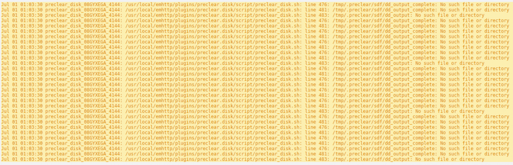

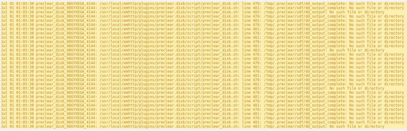

the preclear plugin even sees them :
here was my first issue, preclear cant read them.

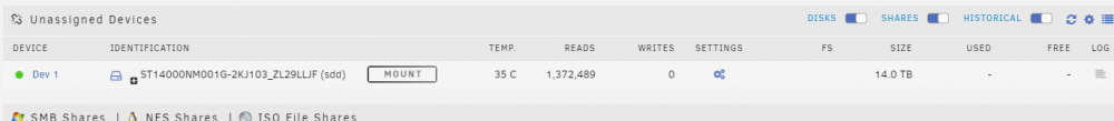

if i go to the main screen on the unraid dashboard they are not visible :
however when i go to tools and system devices i can see them
where am i going wrong i think maybe im using the wrong adapter? some guidance would be great

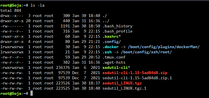

I've followed this method to install sedutil but when i got to use it i get a command not found.
Not massively familair with linux and not sure whats wrong.
Edited by Joeh
After doing those steps, run the following command and attach a screenshot.
ls -la
ls -la
Done
