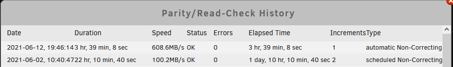

The parity check history does not show anything from the data rebuild (TBH, I don't know if it should):

You do not normally get an entry added to the Parity History for a rebuild (or clear).   If it is thought it would be of use I could enhance the Parity Check Tuning plugin to add such entries.

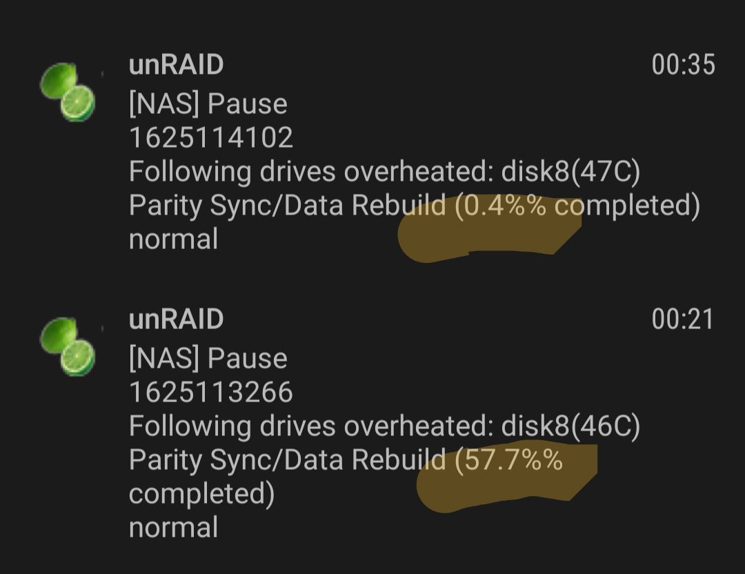

it adds nothing to the discussion, but it's quite sad:
(Wow, sorry that's so BIG!)
Those are the Pushover notices from when it reset. I was wrong in my initial report - the Parity Check is scheduled for 00:30, not 03:30 on the first of the month.
There is a minor issue of the extra "%" sign in there, but I think this is the first time I've ever noticed, so it's definitely a minor issue.
That IS a PCT bug but as you say cosmetic.   Still it will get fixed :)
