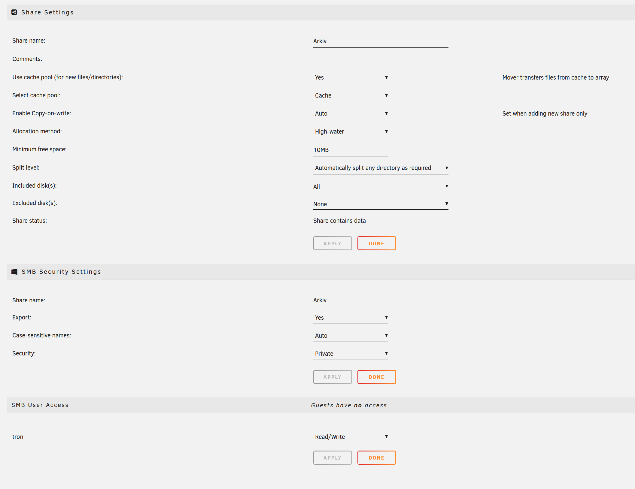

Everything is peachy until I try to copy files onto the new share i made (Using SMB).
Files start copying into the pool drives (speed around 80MBps so a bit low for a gigabit). I leave and when i come back the pool is full and the copy has stalled seemingly because of no free space in pool. (so it did not switch over to directly copying files to the array.

3 minutes ago, tronba said:
the pool is full and the copy has stalled because of no free space. (so it did not switch over to directly copying files to the array.
You need to set Minimum Free for cache
4 minutes ago, tronba said:
I leave and when i come back the pool is full and the copy has stalled because of no free space.
That will happen if the minimum free space for the share is not set to more than the largest file you copy to that share, usually recommendation is to set to twice that.
Click on first cache disk to get to this setting.
Thank you all for the fast feedback.
I will increse the minimum free space and check up on turbo write.
With kind regards.
T
